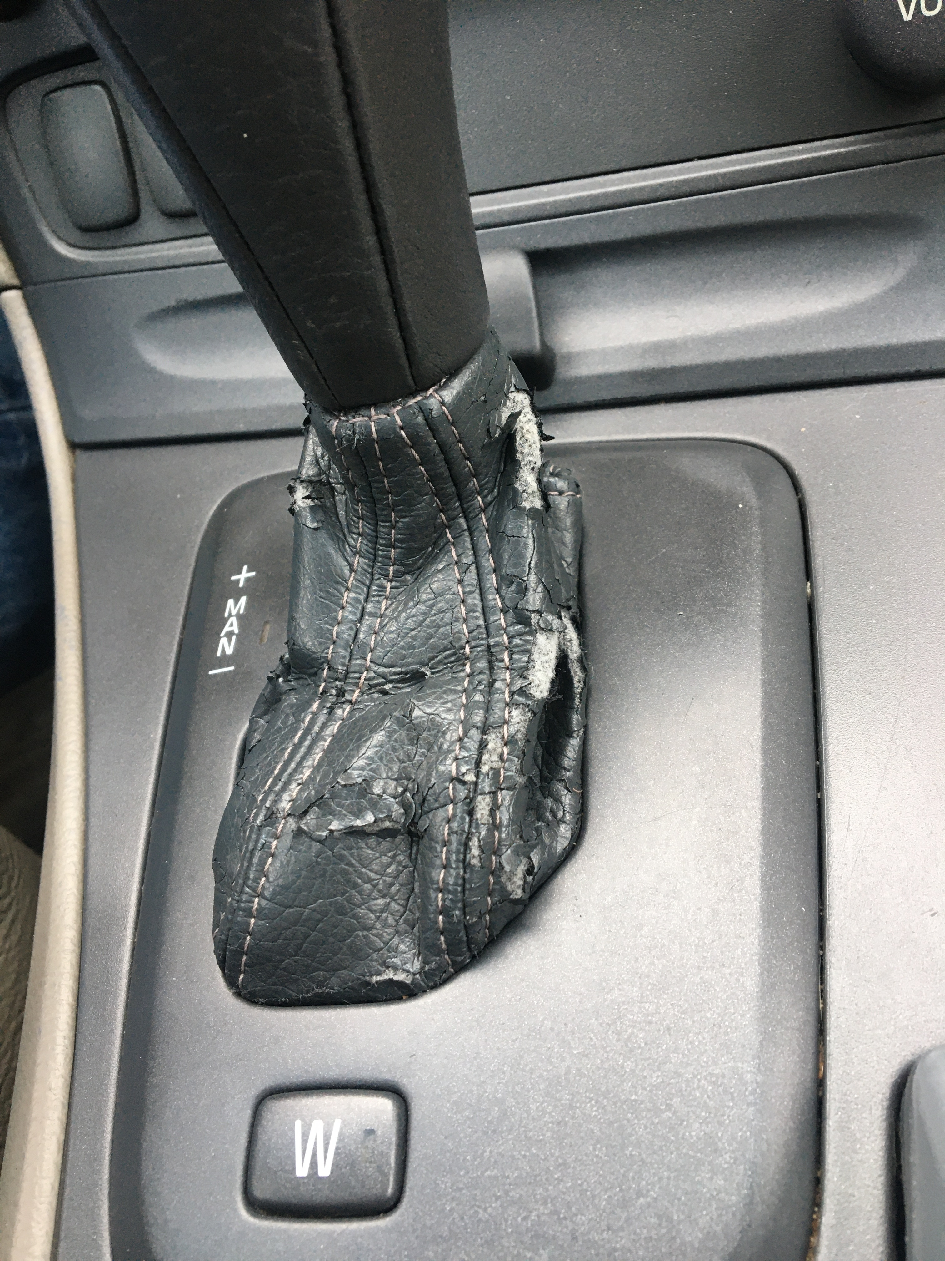

Does anyone know how to fix this or make it look better? The fake leather is peeling off my shift boot. I don’t want to buy a whole part for it. I can’t figure out how to get the knob off to separate the boot.

This video for an XC70 looks useful:
I've replaced the gear lever boot on a manual. I bought the replacement from eBay. The leather was glued to a frame that clipped into the plastic at the base of the lever and to a ring that clipped into the bottom of the gear knob. I need to cut the old leather away from the frame and ring and reuse these with the new leather. Contact adhesive worked OK.

I will add this, there is a clip at the top of the boot, it is oriented in a certain way when putting it back, then as in the video above, need to undo the plate with the digits, and I believe the boot is either glued or stapled to the plate. Need to detach first the boot at the top, then pull the knob: it will often times feel like it's impossible to pull it out, jut keep the pressure on it for 30 seconds or more, it will eventually come out

Fairly sure the auto and manual use the same boot..its really straight forward repair i bought an aftermarket leather one and did the handbrake aswell.
