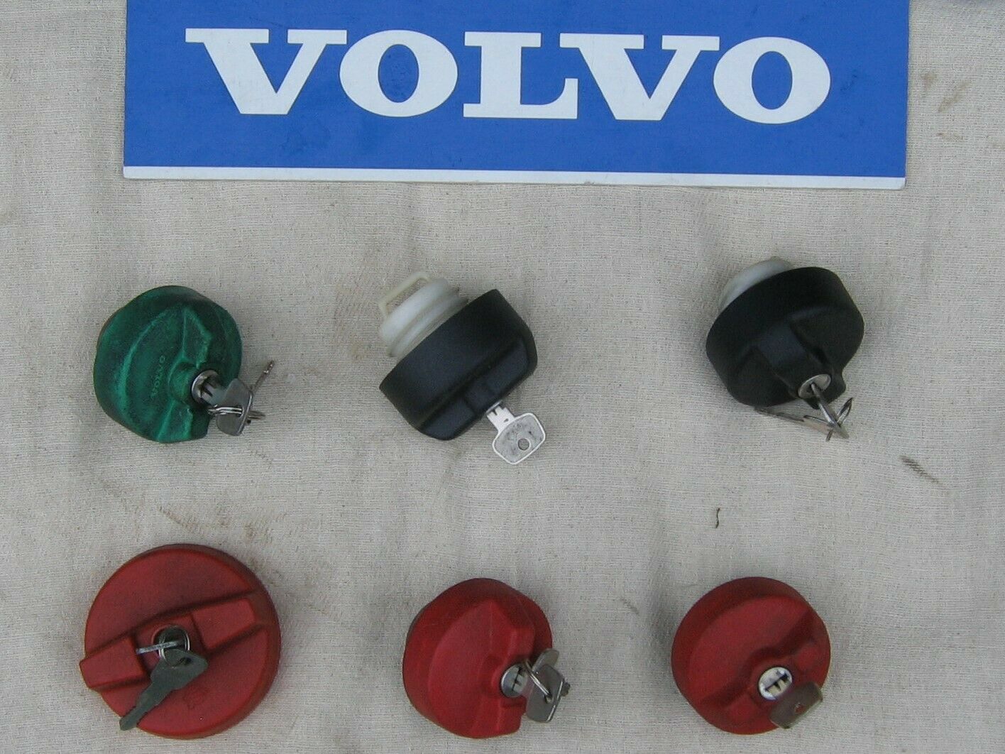

I also want it to lock immediately, i came across it in VIDA and could not change it. I decided to buy a Volvo locking cap as the flap lock is kinda a anti tamper lock anyway. Not sure what the green one but i got the black one, its exactly the same as the stock one but has a key. Dont get the red one as its older metal style and they will be rusted now, my red one sounded like a salt shaker.
NOTE> its impossible to unscrew the locked cap by force, the easiest way to steal fuel is to drill a hole in the tank.
