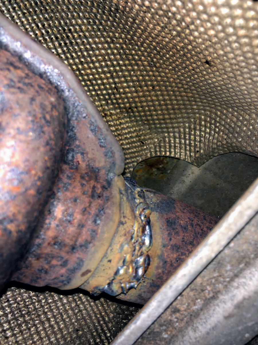

I took my car to the local exhaust shop today, Andy's Exhaust and Undercar in Salem, Mass: http://www.andysexhaust.com/ I had a FANTASTIC experience.
Andy, the owner and sole employee, was able to repair the break in the pipe, and also replace a broken rear exhaust hanger, the lack of which had likely led to added stress on the pipe upstream and contributed to the break. The exhaust is super quiet now. He was able to do everything for $80 - $60 for the repair to the post-cat pipe and $20 for the hanger. It took him about 5 minutes to do the hanger, and 40 minutes to do the pipe repair, all while I waited. The end result is a more stable and much quieter exhaust system. It's possibly even quieter than it was before the big break started, so I have a feeling there may have been a smaller, more intermittent break prior to the big one.
Here's a photo of the finished repair job. I don't know anything about welding, but I imagine this is about as good as it's going to look given the old, broken, and rusty state of the existing exhaust.

A friend once called that a 'black and decker weld'. When you finish welding, you get your Black and Decker grinder and smooth the weld bead.
It is good as long as it does not leak.

I don't believe he used a grinder on the weld. I saw him using an arc welder of some sort and then a welding torch. After the initial pass he started up the car and then went back over everything with a mechanic's stethoscope, I'm assuming listening for leaks or vibrations, and then he touched up a bunch of spots. Fingers crossed that it holds up for a while!volvolugnut wrote: 08 Jun 2021, 17:22 A friend once called that a 'black and decker weld'. When you finish welding, you get your Black and Decker grinder and smooth the weld bead.

When you are facing a 2K replacement repair bill, having someone do a great fix for 5% (or less) of that is a real source of joy, satisfaction and gratitude. Thanks for letting us know.
