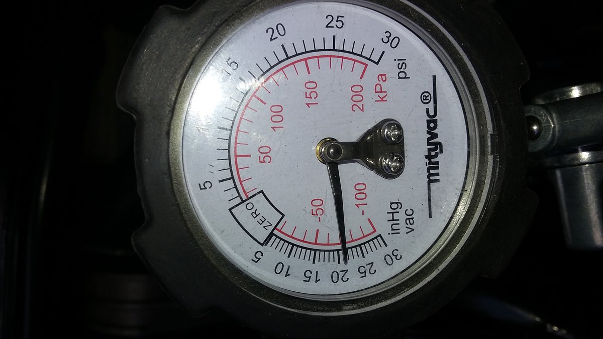

Last thing I did was a Vacuum Check from the smaller port on the intake I Teed into it and im getting -20psi it fluctuates as I accelerate up to 3k rpms.
It goes higher - 25/30psi if I tap the pedal hard it will drop to 0 for a second. I dont Know what else to do completely lost here...

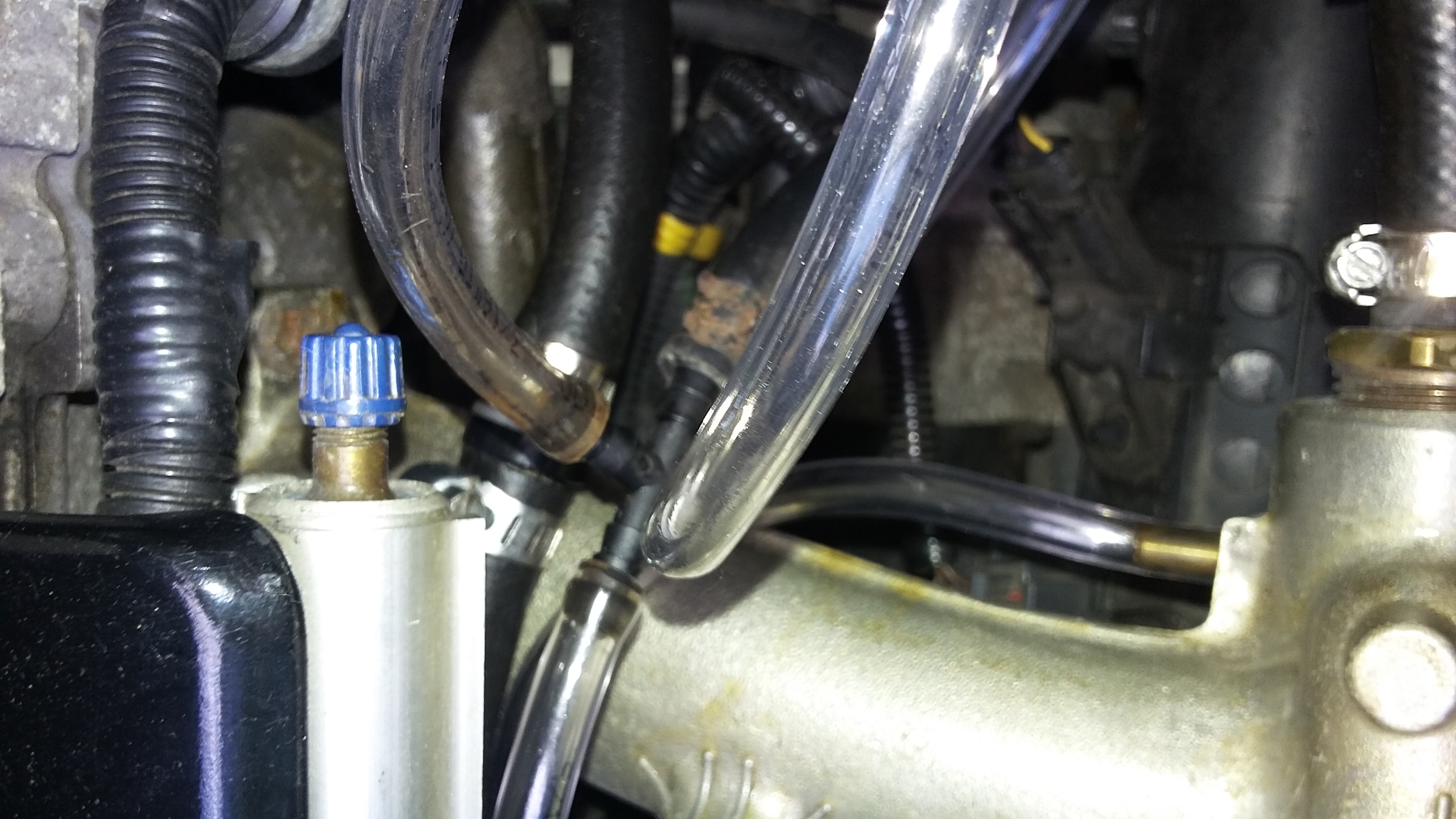

Here are pictures of where I tested vacuum from today....
