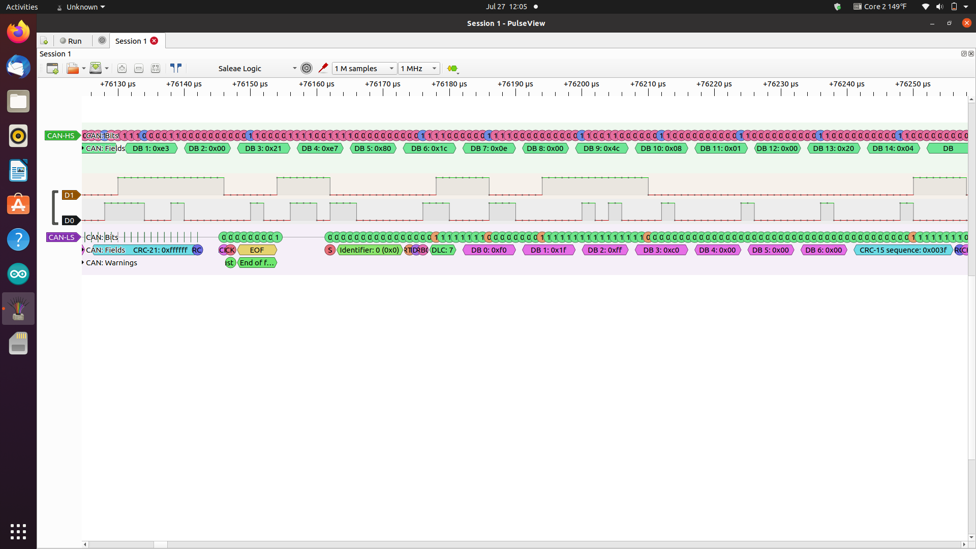

vtl wrote: 27 Jul 2021, 08:03
Do you have a logic analyzer like Saleae? Maybe digital oscilloscope? I would check first that Teensy actually sends anything to the bus and CEM replies back. You may find something simple, like CAN buses unintentionally swapped, or H/L lines reversed.
Found one error on the breadboard, cut a buss at the wrong row. Corrected that and I am getting activity on the other side of the CAN-HS transceiver. Still not getting the PN ... probably just noise or the CEM squawking.

vtl
Posts: 4936
Joined: 16 Aug 2012, 13:35
Year and Model: 2005 XC70
Location: Boston
Has thanked: 130 times
Been thanked: 686 times
Post by vtl »

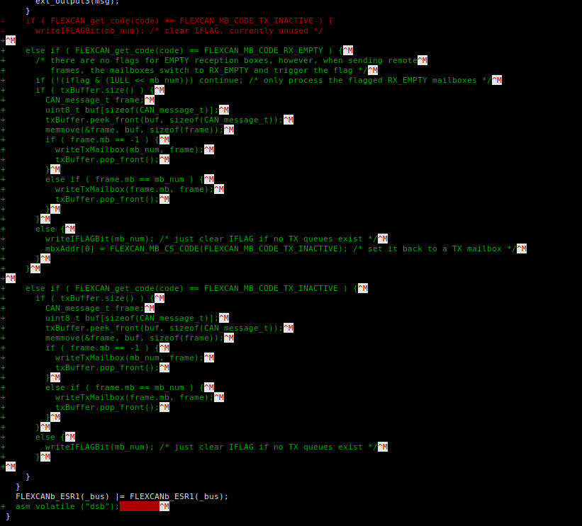

"DBG NORM: -1" is printed by the FlexCAN_T4 library: https://github.com/tonton81/FlexCAN_T4/ ... .tpp#L1092 I don't know what it means.
Could you paste the log for the first byte, and also the pin you read with xprog/ioterminal?
vtl
Posts: 4936
Location: Boston
Post by vtl »
The message was added in this comment:
Code: Select all
commit 7fdc3d921022ba49f0479ab869861419a736942b
Author: Antonio Brewer <[email protected]>
Date:   Sat Jun 20 23:42:40 2020 -0400
    Update FlexCAN_T4.tpp
The commit message is very indicative of the following quality :) Pardon me being a snob...
