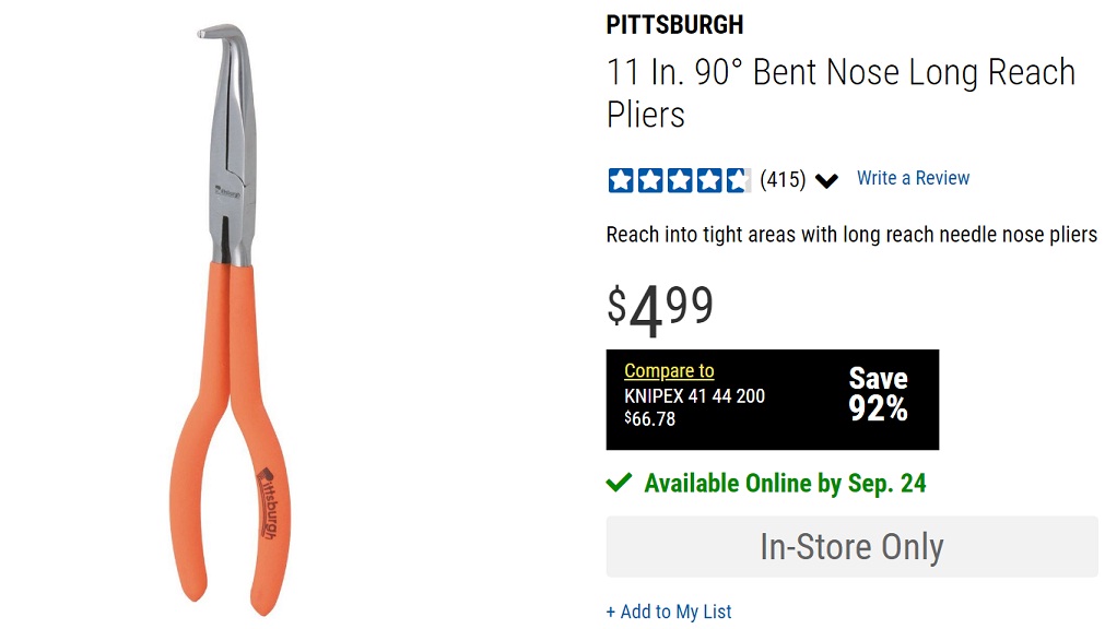

People with large hands may find a pair of right-angle pliers useful.
Just be gentle, don't squeeze too much.
Use these pliers gently like your fingers...

Thanks for that, however that is not the marker light. That is the turn signal bulb which is relatively easy by comparison.
Once you have got the turn signal bulb out of the way, the marker bulb is hidden to the back of the hole the turn signal comes out with a long plastic flag on it. I tried long pliers on it and that is how I broke it. It puts too much pressure on a small surface area on the brittle plastic. Even f you can get it out, you cannot see to put it back in as you are working in your own view-space.
Thanks all the same. I will do a write up with pictures when I remove the headlights to polish them.
