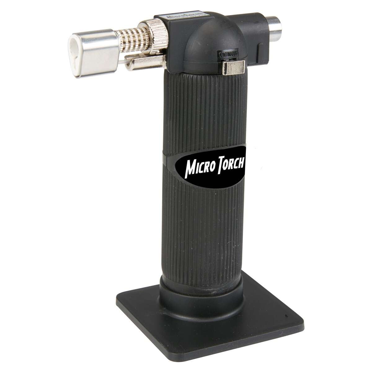

I like this for some tight spots; pencil flame capable of getting way hot if need be.
