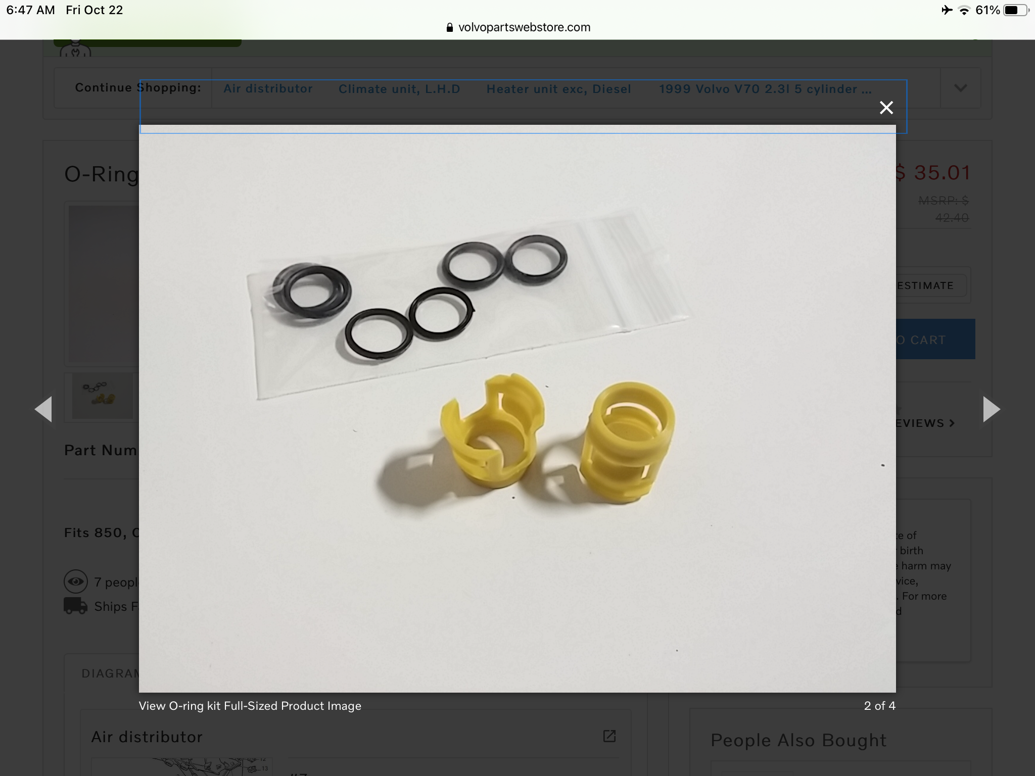

There is a little bit of confusion in Volvo webstore. These-rings are used in three places on the heater core
1 one on each pipe, in compression between core and pipes
B. INTERNAL O-ring sealing pipe to plastic junction inside car…one or two per pipe?
iii. At the firewall connection, where I believe the fitment is, from front of car ( amd so loading order)
Fat spacer, oring, thin spacer, oring
The diagrams in Volvo webstore, for air distribution box, conflict a bit.

Let me share the diagram I got with the set I ordered from skandix
You need 2 per hose, and additional ones for the heater core and internal connection if you replace those. I did not take apart the internals so can't help you there :|
Btw, make sure you pay attention to that plastic ring... It seems there are different clips, and with the longer clips you can't use the ring, the drawing confused me but in essence that is the reason behind the 2 different drawings as far as I can tell.
I first tried to leave the fat ring on, but it wouldn't fit. upon removing it I realized the differences in the old&new clips and in the drawing.
