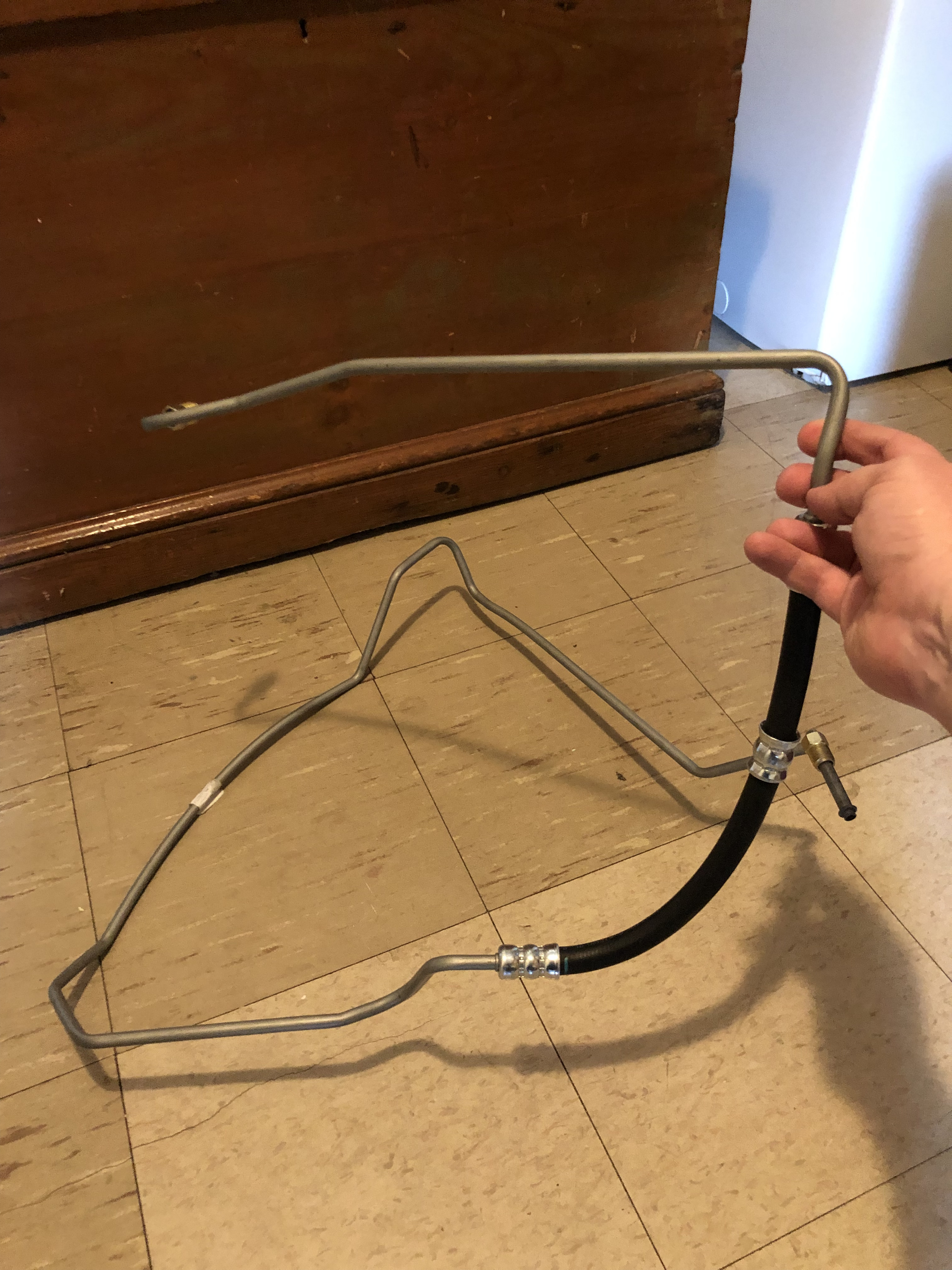

Got the replacement part today. In terms of dimensions and fittings it looks correct, but the geometry seems off. Does the metal pipe flex when being installed? Seems like the lower section of metal pipe would need to flex a bit to fit around the installation path. I don’t know if it got bent during packaging or if this is normal. The box didn’t show any signs of damage and the hose/pipe itself doesn’t look damaged. The part number matches and it looks basically like the part photos online, with the exception that the online photos has slightly different angles.

It looks like it got bent a little, I don’t think it will be a big deal though. Have you decided to do it yourself? Take lot’s of pictures of the routing as you remove your old one.
