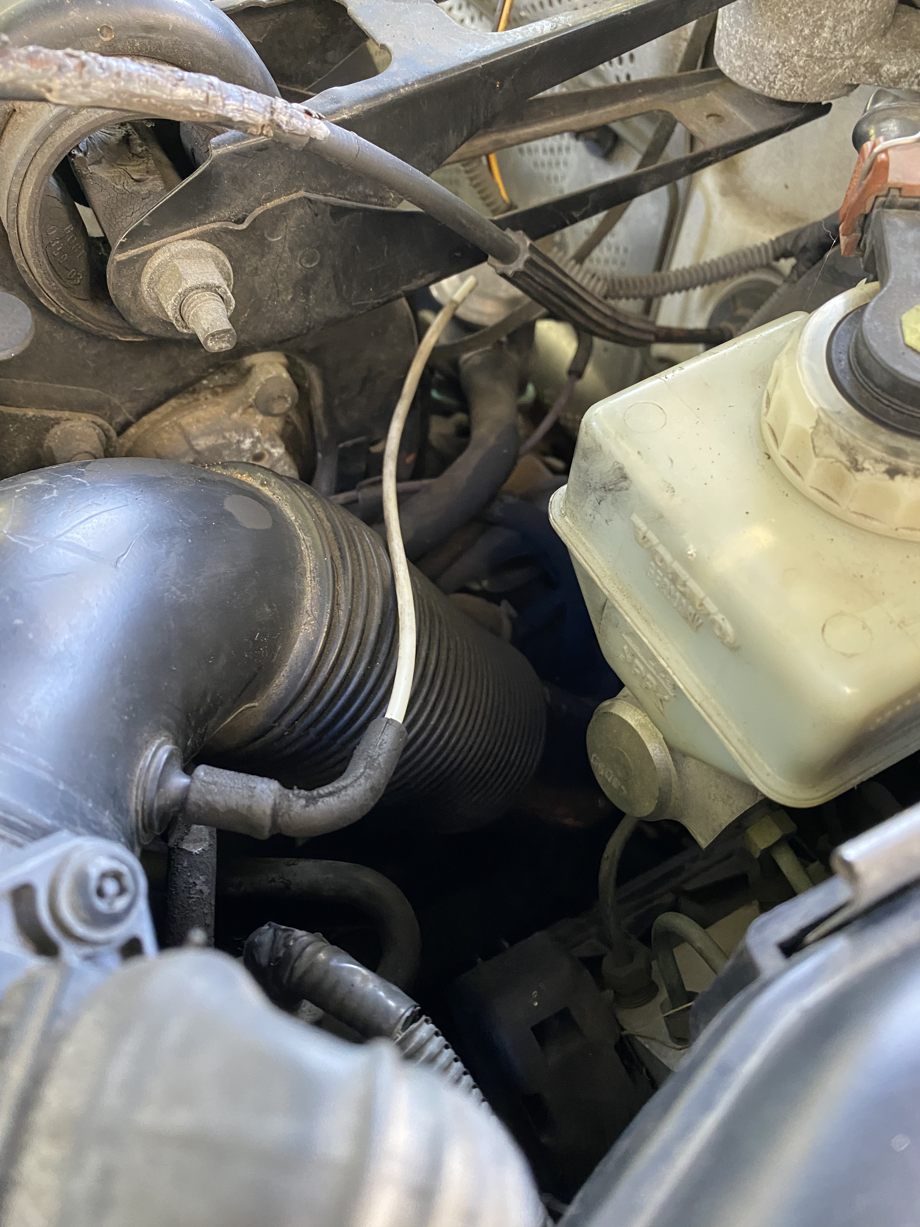

Working on a T5 m56 😀 and I have two open vacuum stalks on the snorkel
One has a short piece of white hard pipe and dives down towards the fuel pressureregulator
The other is open
Can anyone help with functions ??
Pictures , and foggy red chairs

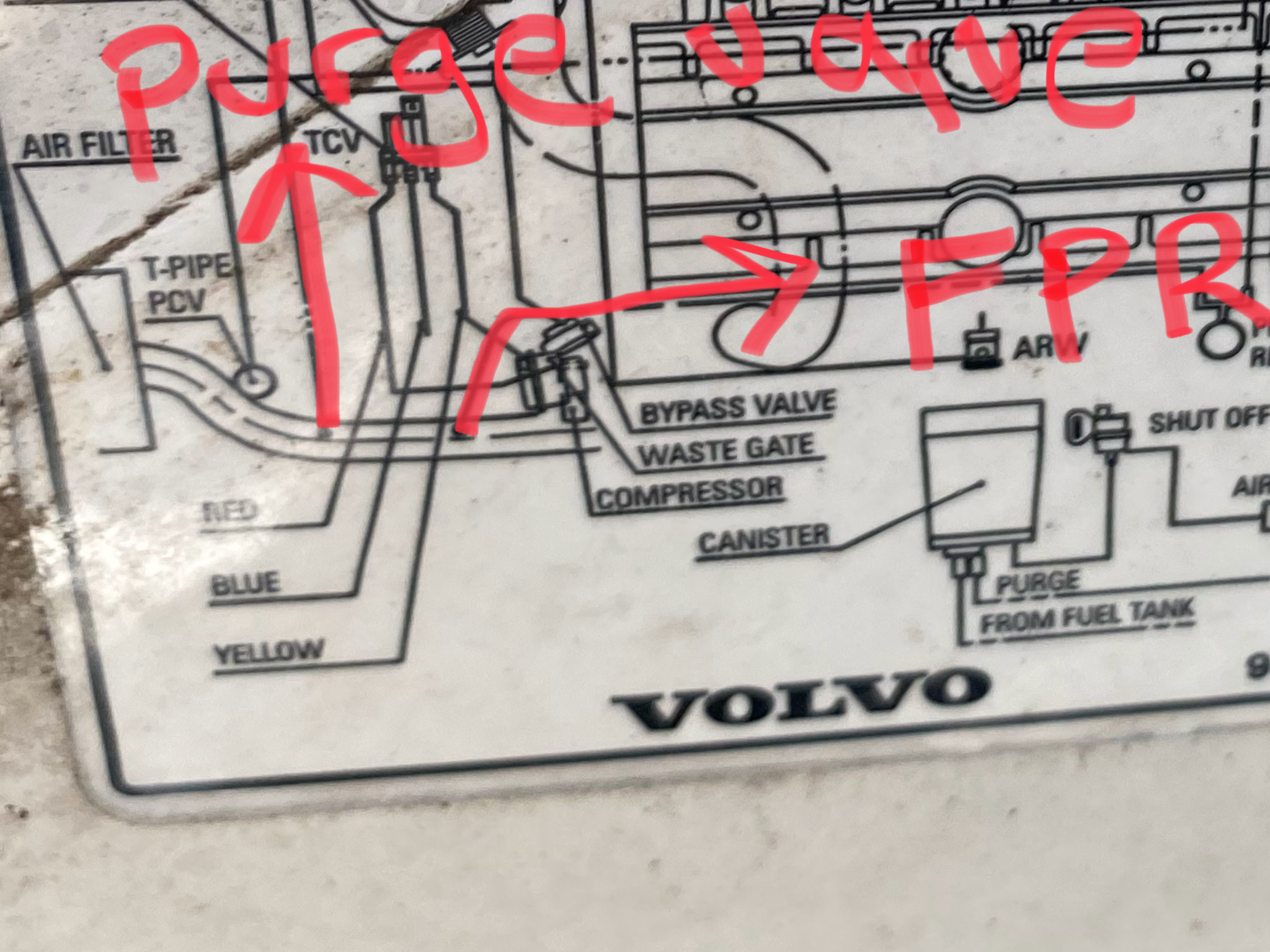

It looks like one side is an FPR Vacuum and the other is a purge vacuum source
