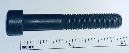

While retracing my path, which I will get too, tomorrow, would anyone know where this bolt came from? I found it laying on my work table when I was done putting things back.

Someone correct me if I'm wrong, but I believe that's 1 of 4 throttle body bolts. However mine were metric, not allen or torque.

TisMe wrote: 23 Nov 2021, 11:00 Someone correct me if I'm wrong, but I believe that's 1 of 4 throttle body bolts. However mine were metric, not allen or torque.
This I know for sure. Throttle body is regular bolt head; it's an M6x80 bolt.
Interesting, the only other place I've seen a bolt like that is on my wheel bearings. But that was also a regular bolt head. Sorry I can't be of more help.

About the bolt. I found it on my work table when I was finishing putting things back. No one can identify it. Stunning indeed.
