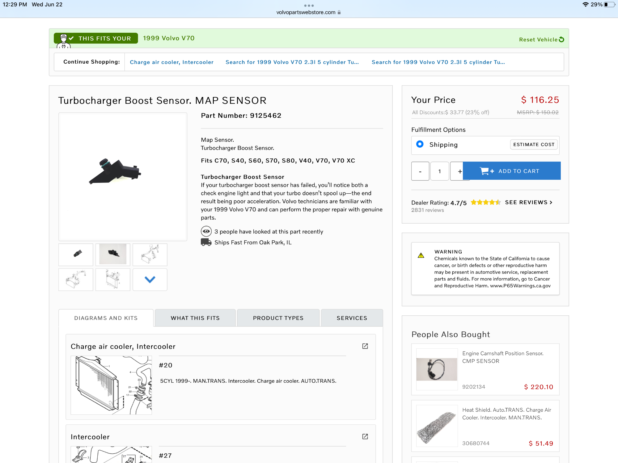

Expensive part, $112 at web store
Bosch 0261230029 map,sensor
B006K8ZKT6
Sensor 7/81 in VIDA
