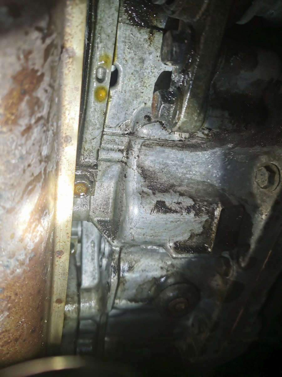

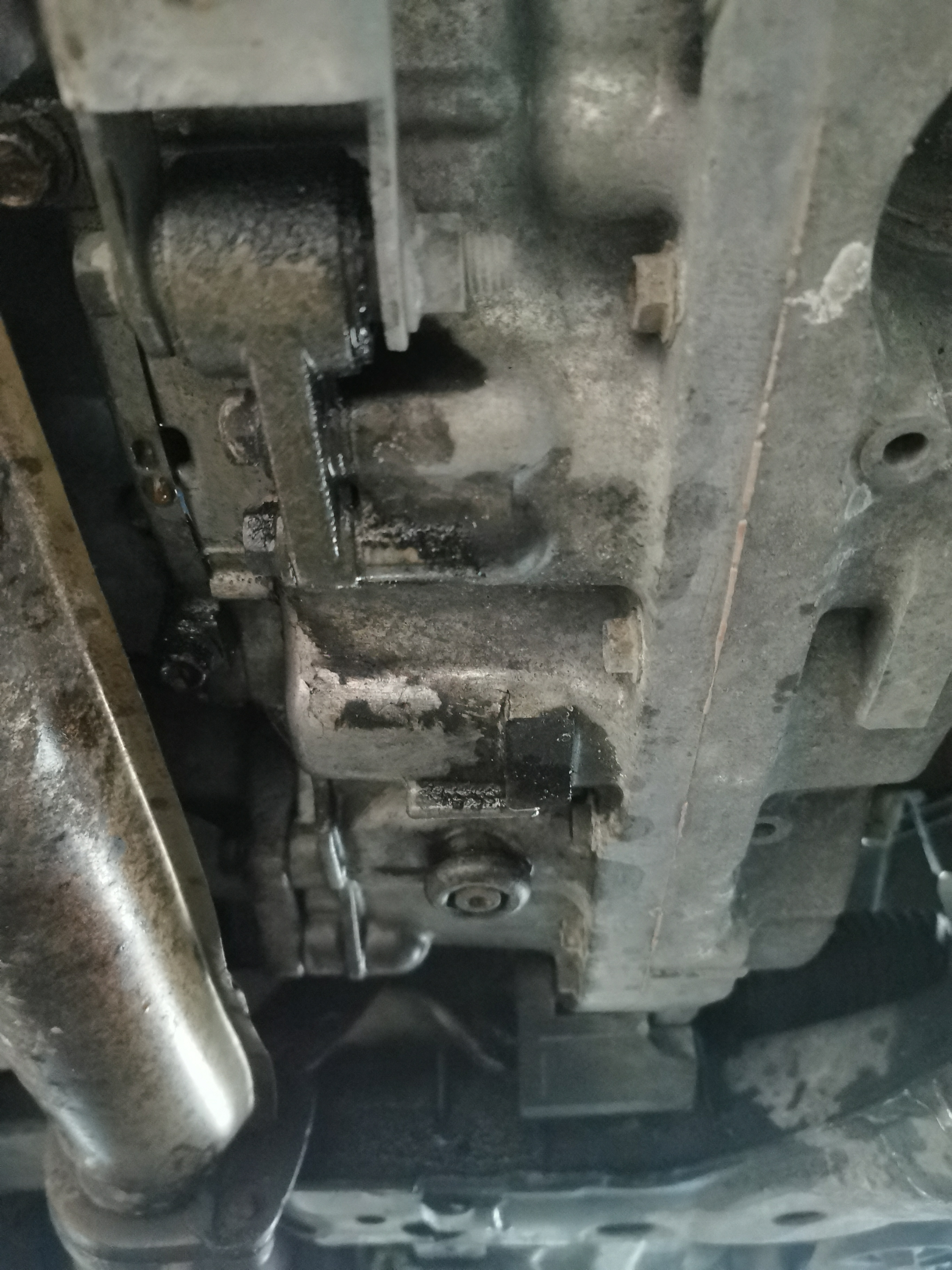

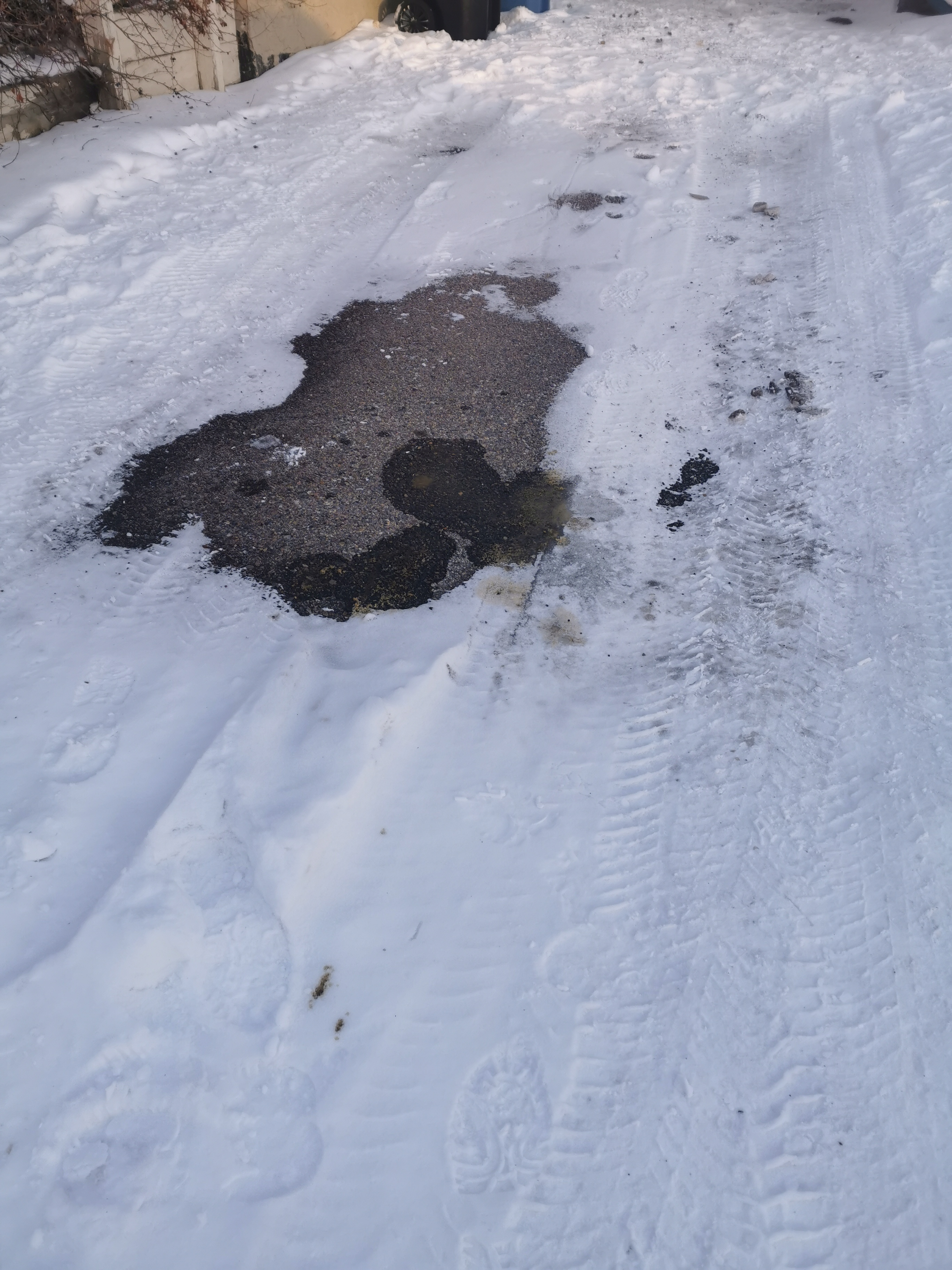

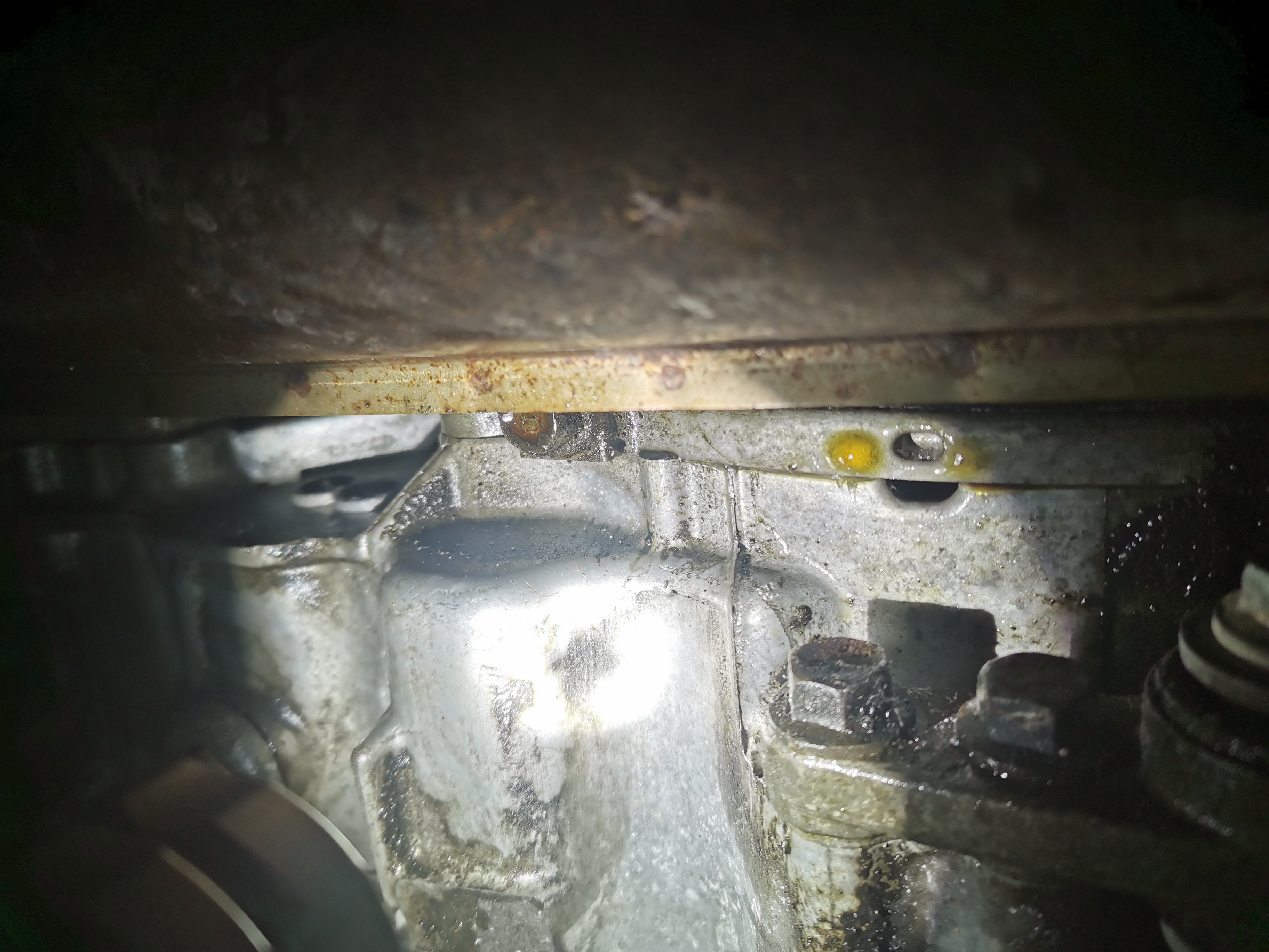

Hi all,
Hoping someone may be able to assist, I have a 2007 XC90 V8 with a leak of some description, I'm fairly certain it's a power steering fluid that's leaking I have a big oily mess on my driveway and an empty PS reservoir and very heavy and noisey steering. The leak has pooled and is dripping from the drivers side (left hand drive). My assumption is the - 35 celcius winter has caused it to freeze and burst a pipe or connection somewhere along the system.
I have no idea on how to actually trace it and fix the issue (is it easily accessed/done or will I lolely need a mechanic?).
Does anyone have a an in depth detailed step by step guide on how to do this?
The following YouTube link shows a very similar leak to mine for reference
https://youtu.be/I9pp7v0Pb14
I have attached some pictures of the underside of my XC90 also.

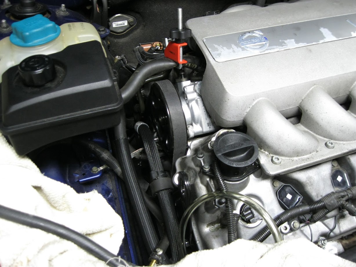

Diagram item 2 is the hose that connects to the rack, item 28 is the oil cooler and loop. It is indeed in a correct orientation in the diagram, the steering rack is not in the correct position. Too cold today to crawl up under one of mine to take some photos but if you follow the right nylon wrapped hose, you'll be looking at the high pressure line from the pump to the rack. The return line from the cooler runs along clips behind the passenger side headlight before it attaches to the bottom of the PS reservoir (see the line with the fitting on it at the bottom of the photo, I was in the process of doing a fluid flush after a pump replacement). Procedure is written on a few threads, here's one- viewtopic.php?t=8644
Possible it could be the pump or the pump connections but given the amount of fluid you dumped it's more logical to me to consider a break somewhere. Quick note, when replacing fluid, do NOT use Dexron. Compatible fluids are Pentosin CHF11 and CHF202 if not the Volvo stuff. Might be a few more fluids to consider but this is what folks have primarily used over many years.
Depending on how long this pump had been in the vehicle, if it's leaking at all you might consider a reseal or replacement. I have replaced leaking pumps outright (132k and 135k, separate vehicles) with Volvo exchange although recently this company (RKXTech) has been producing o-ring kits to rebuild them. I rebuilt one of my old pumps a few months ago (see https://www.swedespeed.com/threads/powe ... st-7843557 ) and have it sitting on a shelf in my garage to install and test someday. I believe it's a very viable option to the $500+ Volvo pump replacement.
Good luck with your repair.

Thanks for the detailed reply, I'm also fairly certain the issue is a break/burst since it's the whole reservoir that's been dumped.
From what I can see, the pump, reservoir and cooler loop all look dry, which leads me to think its the hose on diagram item 2, or perhaps where it connects to the steering rack.
Any advice on how to trace or get visibility on that hose?

From what I can tell its somewhere around where the pipes meet the steering rack, could be a cracked pipe or an o-ring? Unfortunately I'm not sure how to get eyes on that part of the system.
There is definitely still a leak however no where near as bad as the fluid dump I had in the - 30s.
