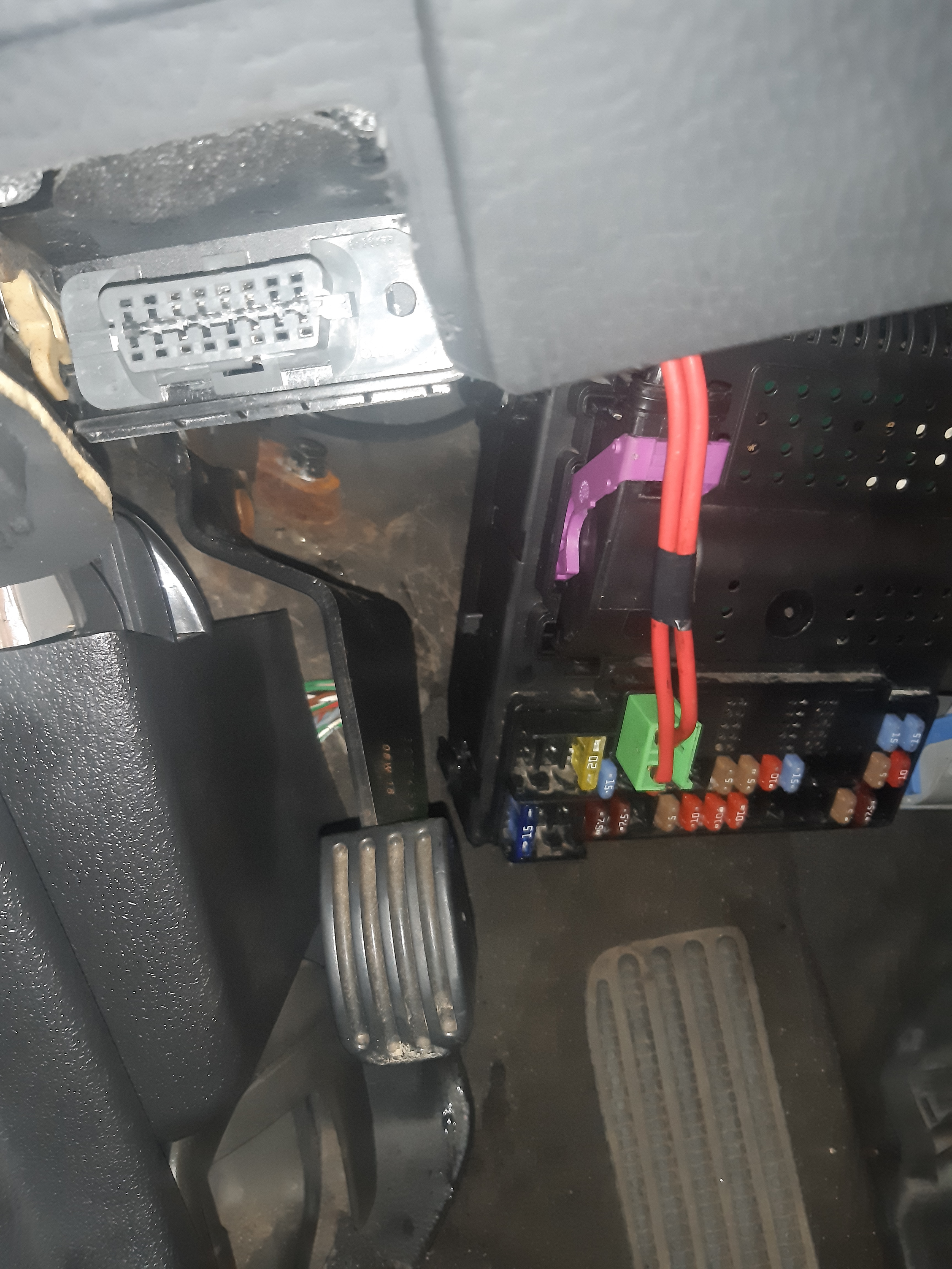

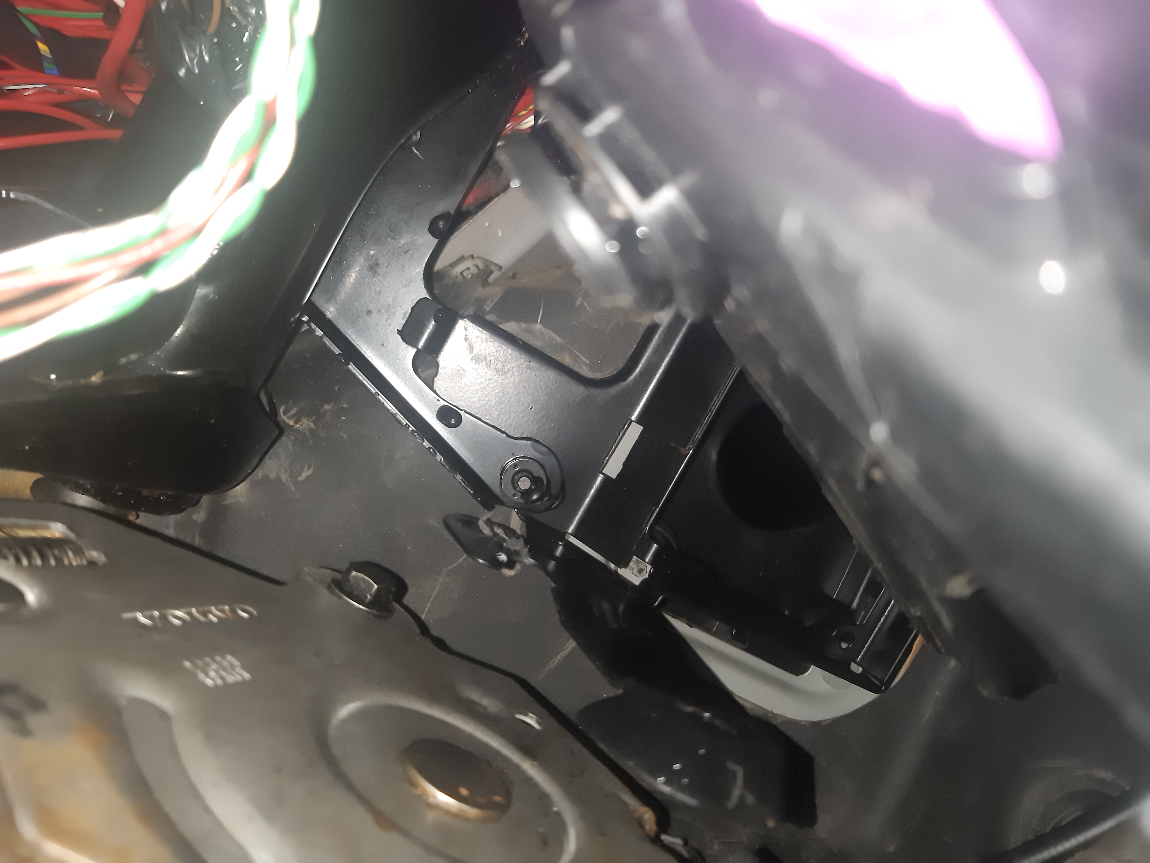

I'm still getting water drip on the left side of the CEM when it rains or I wash and I've no idea where else this can be coming from.
I pulled out the CEM and took a photo of where I see the water coming from.

Some of the Windshields have bonding issues on the Windshield seal. Check the seal around the Windshield. A leak on the top can drop on the headliner then run down a different path then the inside of the Windshield.

Thank you.RickHaleParker wrote: 25 Oct 2020, 16:51 Some of the Windshields have bonding issues on the Windshield seal. Check the seal around the Windshield. A leak on the top can drop on the headliner then run down a different path then the inside of the Windshield.
I'd check this too.
I'd probably pour water from different points because at times it seems like it's been solved than a heavy thunderstorm comes along.
