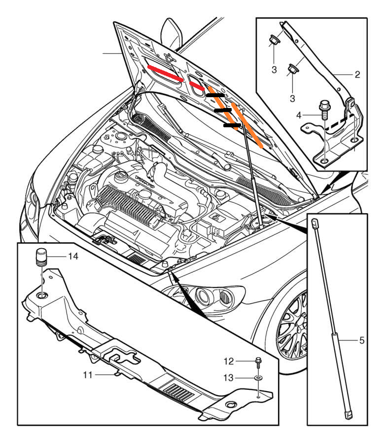

Can't use adhesive and can't use fastners?
What about weaving these or similar including method under the hood structure to secure the pad?

Perhaps 2 ways to do this. The hood has a structure support inner panel with large areas stamped out. Weave the rod through the pad and insert under this panel. The other method would be to rest the entire rod directly over the pad and make a few holes in the pad for zip ties to go under the inner panel. This should hold the panel against the hood.
You can go vertical, horizontal or any angle which ever best suits the inner panel. Red for weaving through the pad and under the inner panel. Orange for rod on top with black zip ties pulling the panel flat.
