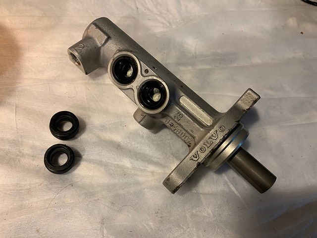

Feeling better after servicing the cylinder with two new Volvo/ATE seals. I'm adding turbo oil lines' seal replacement to my to-dos before brake booster goes back in - any thoughts?
FWIW: the booster seal has come off between 12 and 10 o'clock - what may have caused the seal to be pushed out like that?

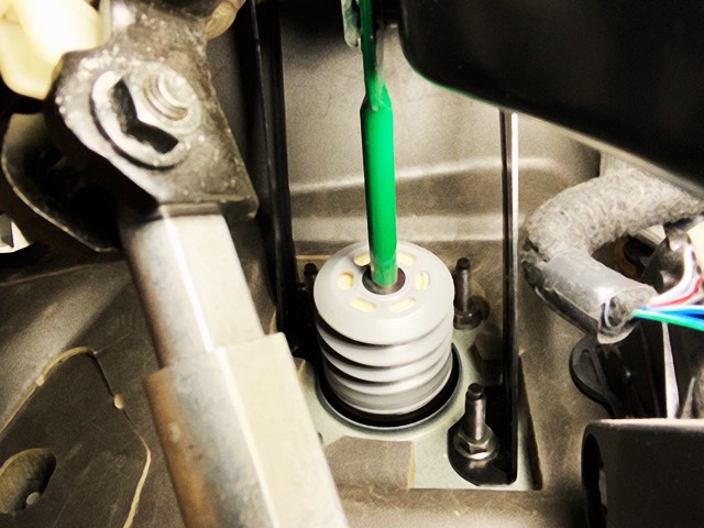

Imagining brake booster with green push rod, it may help gas pedal to run a little greener.
