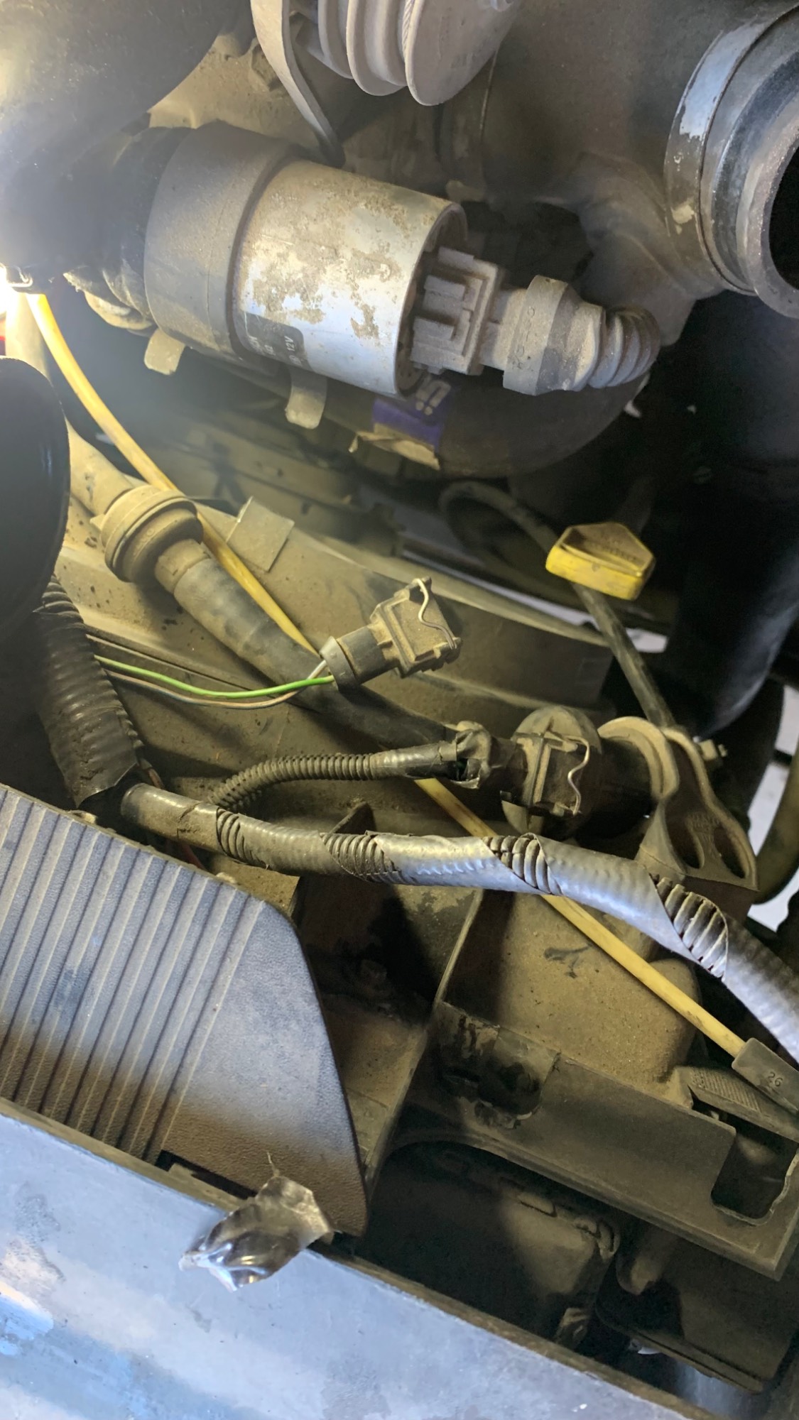

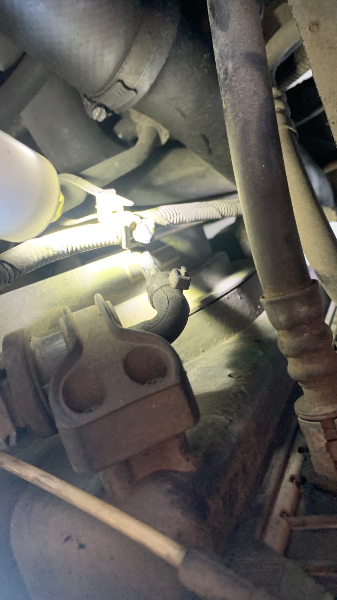

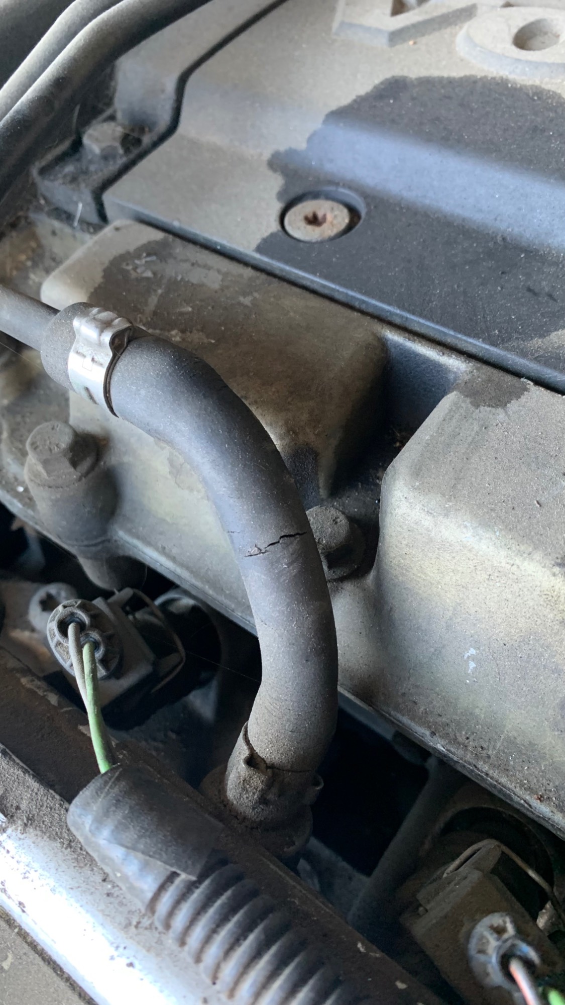

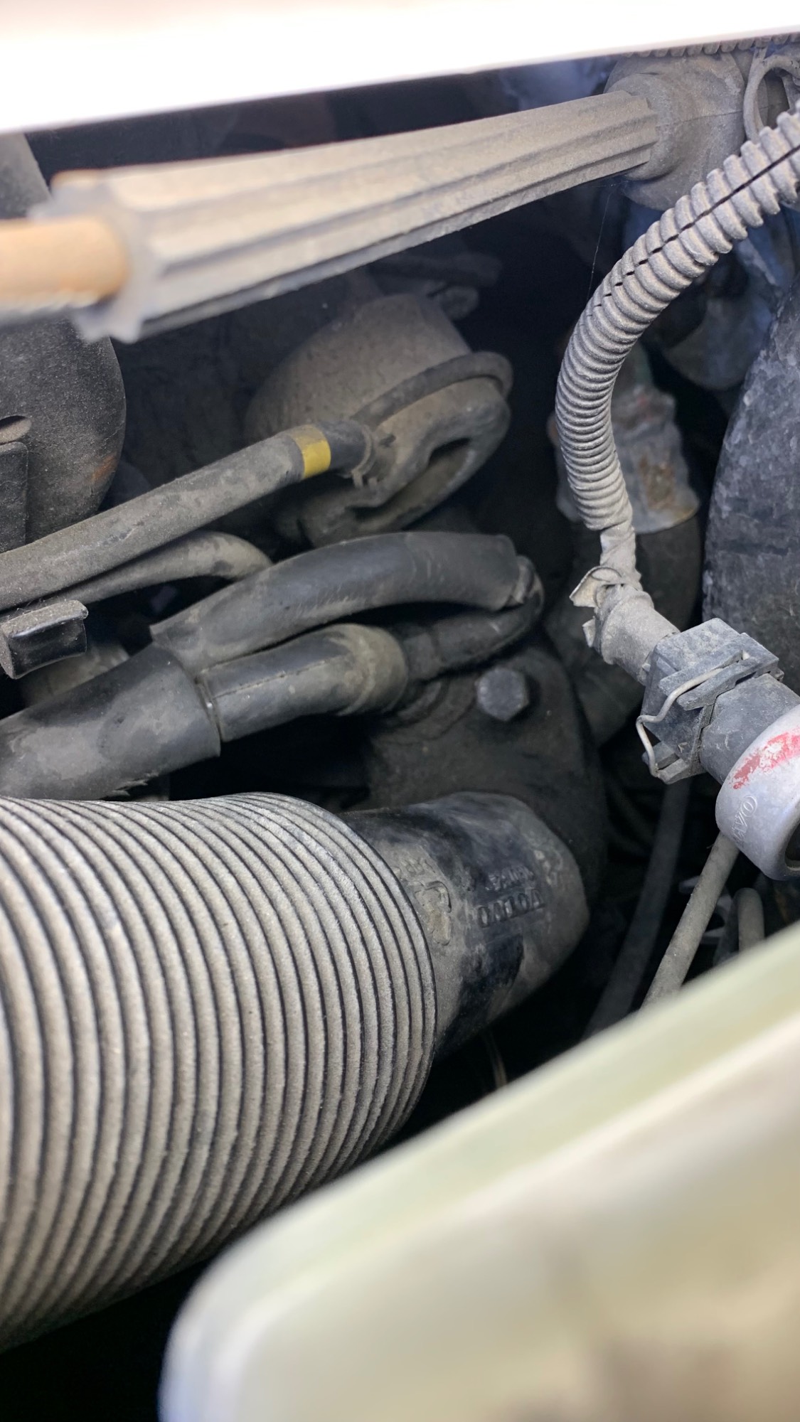

Ok, more digging has been done and boy did I find some cracked hoses. I've attached some pics of some hoses that are cracked and look suspect. I think the new PCV hoses will take care of a few, but for the others I'll need to figure out what I need and get some length of hose and cut it. I also need some elbows, pretty sure I saw an elbow kit on IPD.
Hoses These didn't look cracked but did look questionably put together to me Also - the loose connecter under the fresh air intake. I can't see where it would plug in... Bit lost there. I also found a couple of other connectors, one that was disconnected and hanging lose, and the other was connected to something (looks like some kind of termination) but was also just stuffed into a hole and not tied down. Does anyone know what these are/are for?
Original loose connector, any ideas? 2 other connectors - they look the same connection but one is open, the other was swinging in the wind connected to some kind of terminator thingy, both were found in the drivers sid front area next to the charcoal cannister (if that what that can is down there) If anyone knows what these are I'd love to know...
Next steps are to get some hoses. Think I've found a good resource of the lengths I need, here: viewtopic.php?t=87490

1st pic: Fuel line, please replace ASAP
2nd pic: some vacuum/evap elbow
3rd pic: all look like they should be replaced
connector: cannot say, could be anything, possibly headlight motor or wiper or whatever
last connector: looks like a temp sensor possibly, ext. temp, coolant temp, brake reservoir have similar connectors if I'm not mistaken.
Also strongly agree with what was said: O2 might not throw a code. Cat could be bad.
Replacing all vac lines is a start, I'd get a boost/vacuum gauge to see what is going on (if there is any change), but I doubt it is the fix. I had all kinds of leaks on my 850, emissions were fine. Once the leak is bad enough and the idle control can't compensate the car won't run good or at all, in my experience. For sure the easiest thing to fix and start with.
