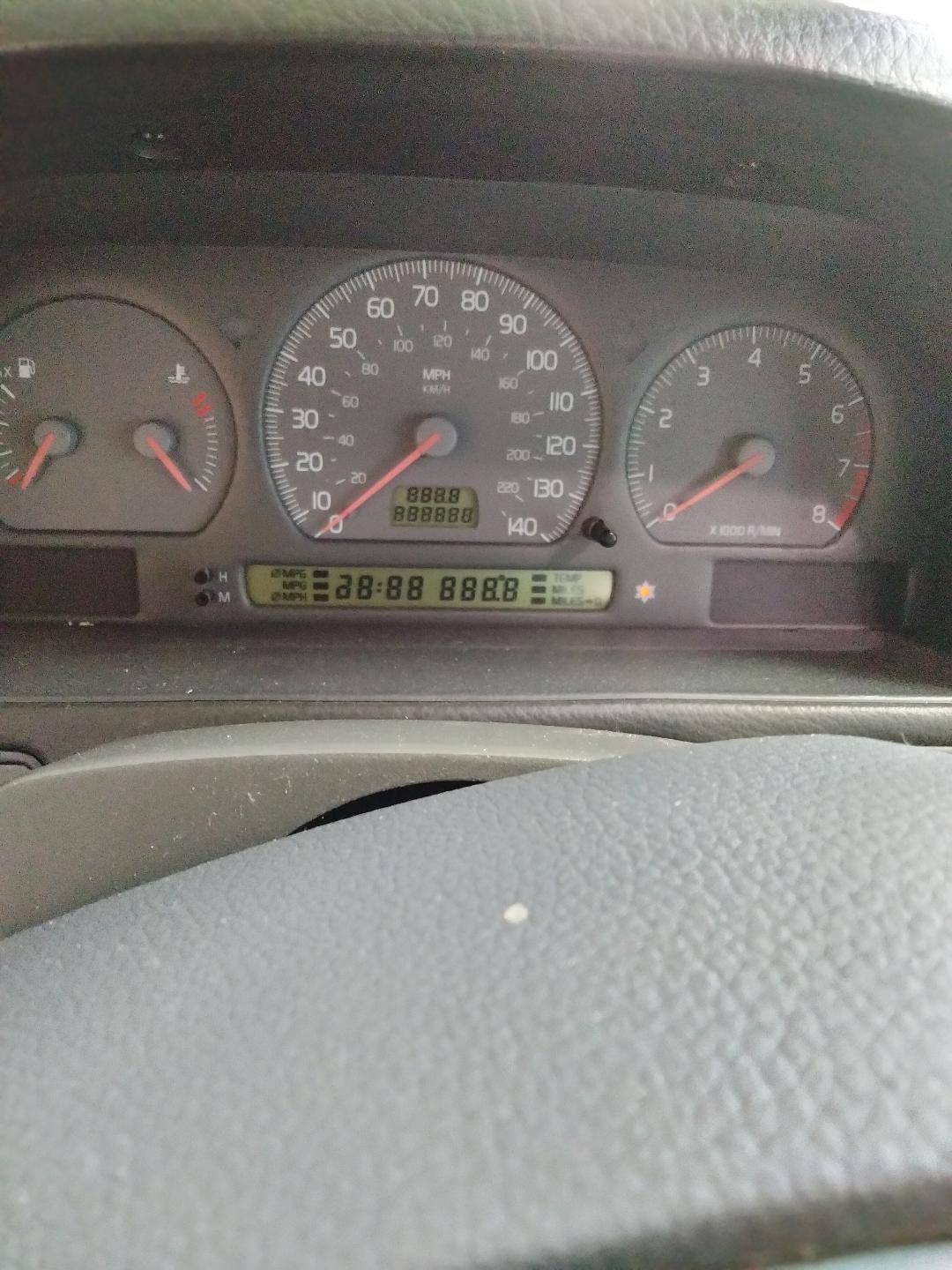

what the issue with my dashboard it get the 888888888888888888888 and dont turn off after door shut and lock
see picture
2002 c70 electrical issue

It may be an issue with the ignition switch. Some of the displays do stay on when you switch the car off and stay on for a short while after you exit and lock the car. What the 0000 number are telling you I don't know. I think this is a badly worn electrical portion of the switch. What happens if you jiggle the ignition key in the ignition? Does it make any difference? If it does then that is your issue.
There is a small rotating switch which allows you to change the read out. Try changing the position on that as they can get oxidised when left on the same setting for a long time. I think this is unlikely in this case though.

Low voltage to the CDM. Bad battery or wiring fault

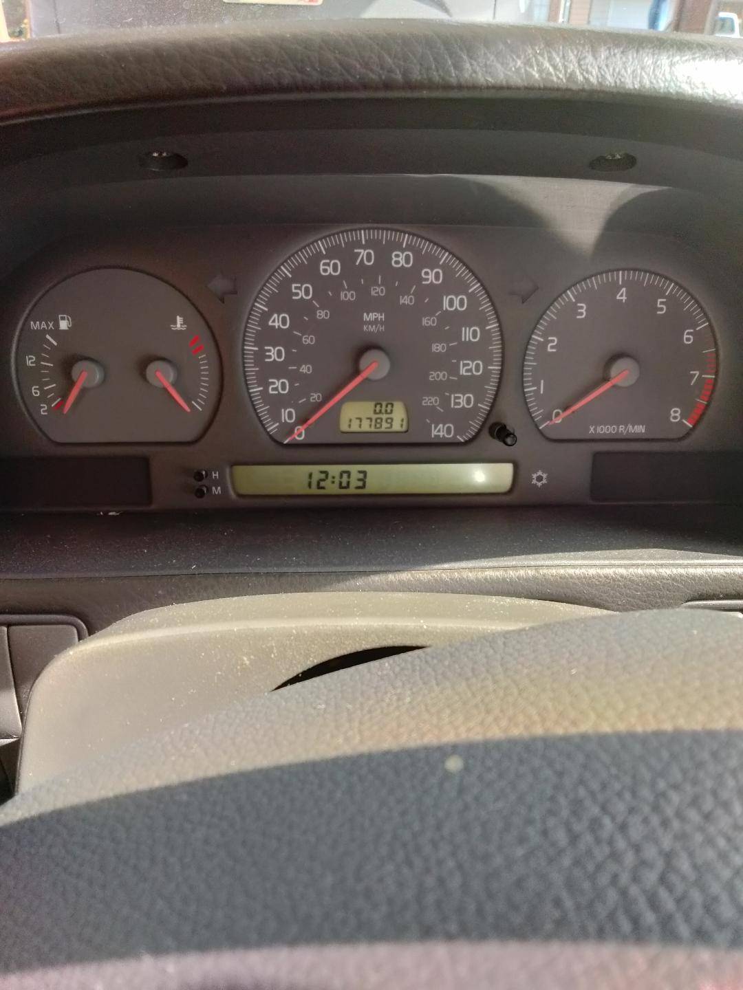

The first picture is when it is cold?
The second picture is when it is warmer.
The display is outside it's temperature range. How freaking cold is it there?

hello rick im in atlanta it 70 outside
the second picture after i turn key off
