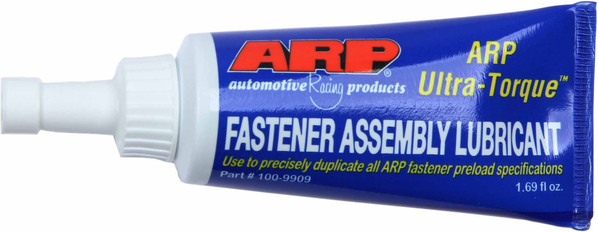

In case you don't know it, the head bolts must be oiled (no dripping oil though) prior installation or you loose about 1/3 of torque. Even better use a special torque lube.
