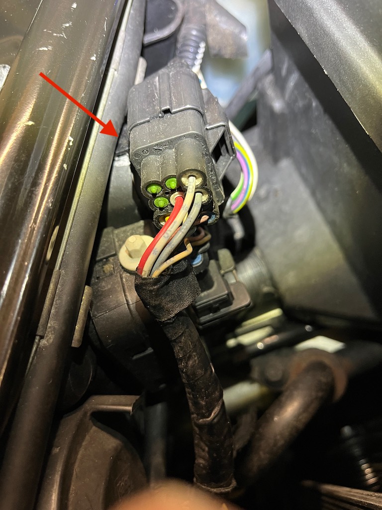

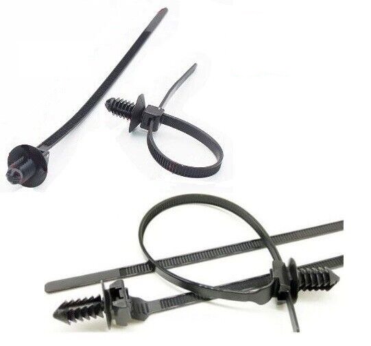

Blacklab467 wrote: 08 Dec 2023, 08:03 I was going to comment on the wiring routing around the top of the radiator on the previous picture but I see you've gotten it sorted out in the subsequent photo. Beautiful car and engine bay!
All the clips for the loom onto the fan cowl were destroyed by some ham-fisted garage monkey. I manages to buy 'fir tree cable ties' last week and it's now all tidied and back to factory stage zero :)

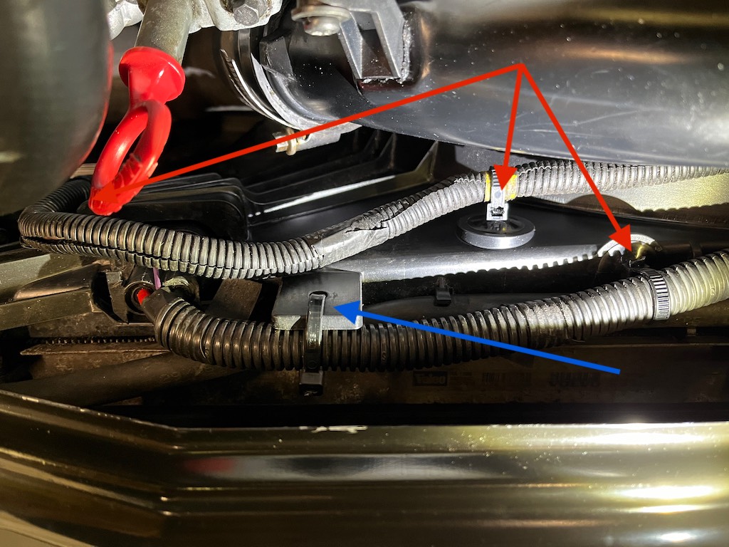

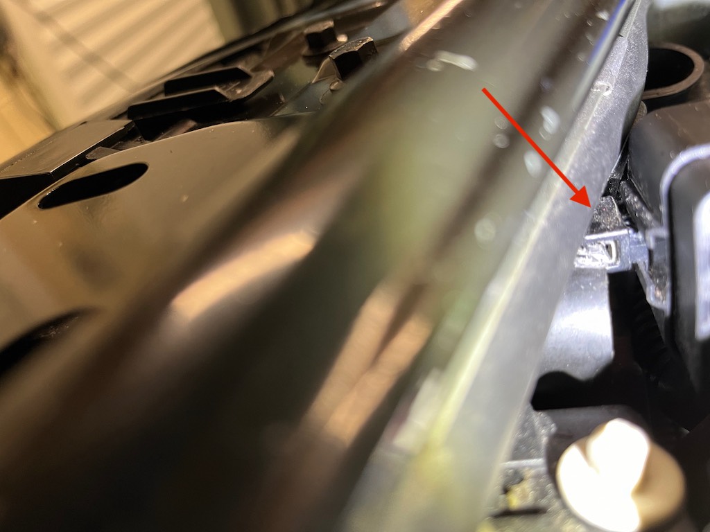

Would you mind taking a couple detailed photos of how and where the wiring attaches to the shroud? Mine's incorrect and I can't tell for sure exactly how its supposed to go, also I have some clips on the headlight wiring loom that are supposed to affix the wiring to flat sheet metal and Im not sure where they are supposed to attach, thanks.

Not sure my pictures will be much help

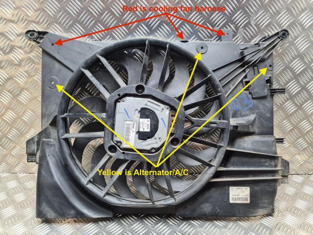

This is an eBay image to show the position of the holes
All red arrows are where the cooling fan harness is clipped into.
All yellow arrows are for the alternator A/C harness (I presume that's where the wires go!!!)
I'm not sure if there should be a fir tree clip where the blue arrow is, I feel it would throw the line of the cable out a bit so I just used a plain cable tie for that hole
Headlamp connections clip onto the top plastic of the headlamp backing

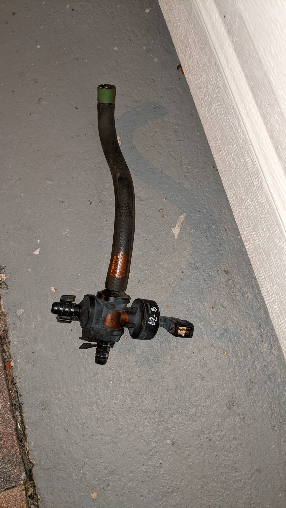

P80GLT wrote: 07 Dec 2023, 10:17 It's the switch for the brake vacuum pump part number 31400692 and yes it's in the correct location
Thanks for the PN! I did find my part from the salvage yard for less than $20.

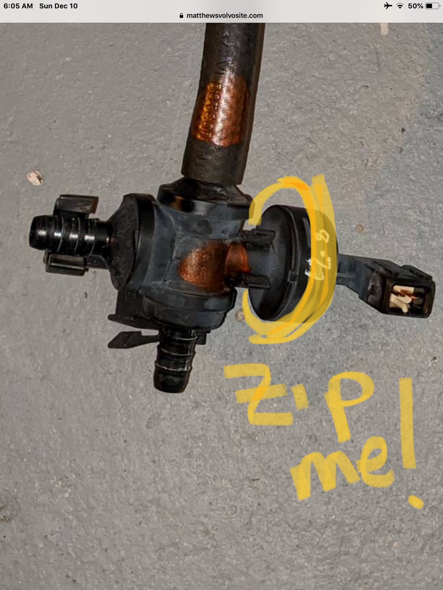

Don’t forget to zip tie your new / old part!
