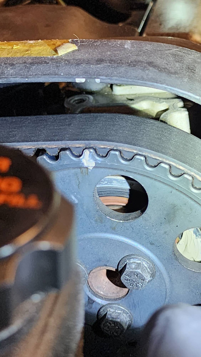

I just physically checked timing and it looks to be in time compared to whats in the TRQ timing belt change video.abscate wrote: 23 Nov 2023, 05:41 See my thread on ECM 644A, probably will show below in ‘ related threads’
Getting timing set right in VVT cars is a bit finicky

- Posts: 36137
- Been thanked: 4063 times
The VVT have to be within onectooth, with the VVT unit clocked correctly to get the valve timing right. It’s not just lining up the marks

With the system saying the timing is over-advanced, would you wager I should retard both cam gears by one tooth and then see if it throws a code?
