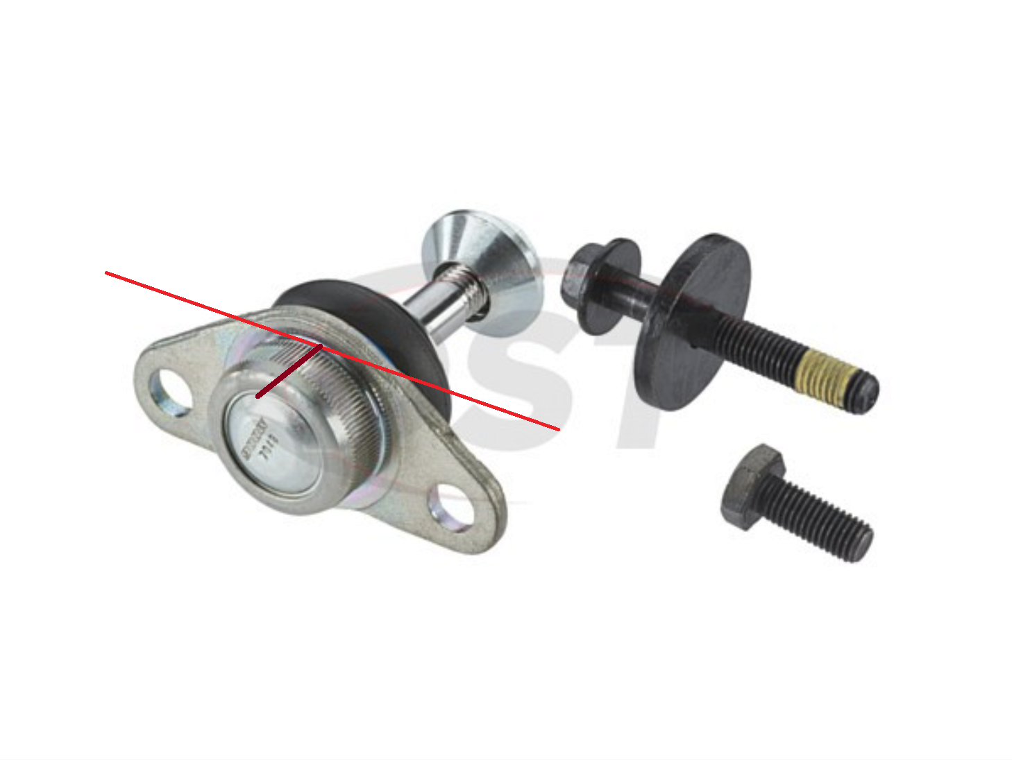

If possible cut the edge off the ball joint and drill into the side downward to relieve tension? Photo borrowed from link.
https://www.suspension.com/moog-k80700

Not a bad idea, thanks.
I ran out of time, needed to complete the job on both sides in one night, so I put it back together with the old ball joint. Ball joint was old but not loose. I'll have to get back in there and fix it, however.

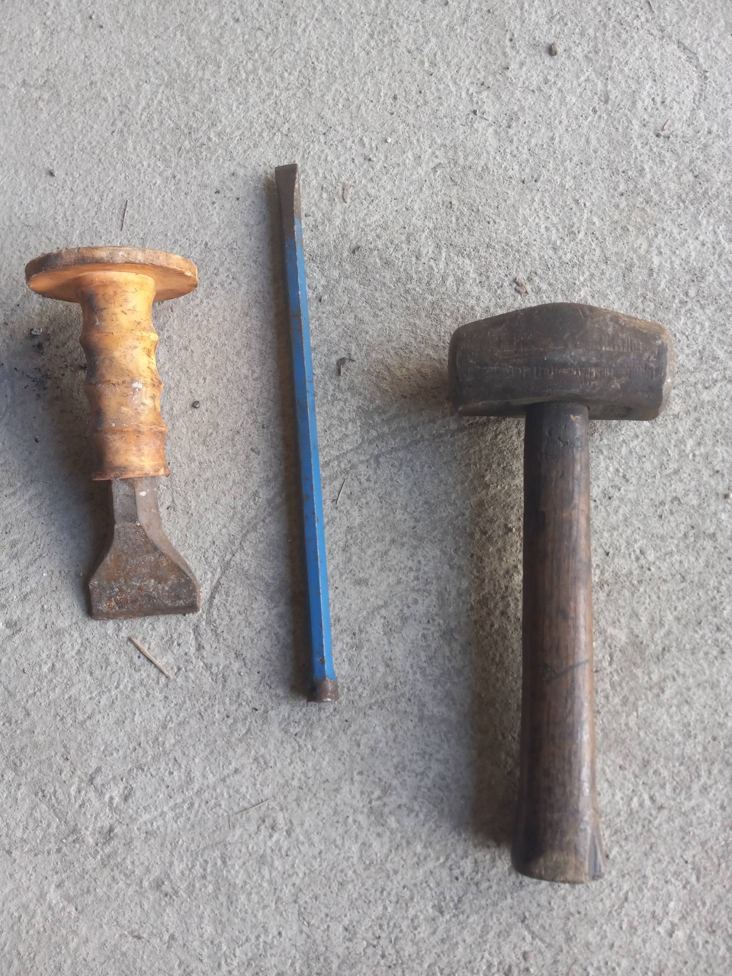

Yeah, I'm not likely to drill anything except as a last resort. But the chisel is a lot more work than zipping it out with an air hammer, which was foolproof for the first five I did. The question is, what will actually work?
