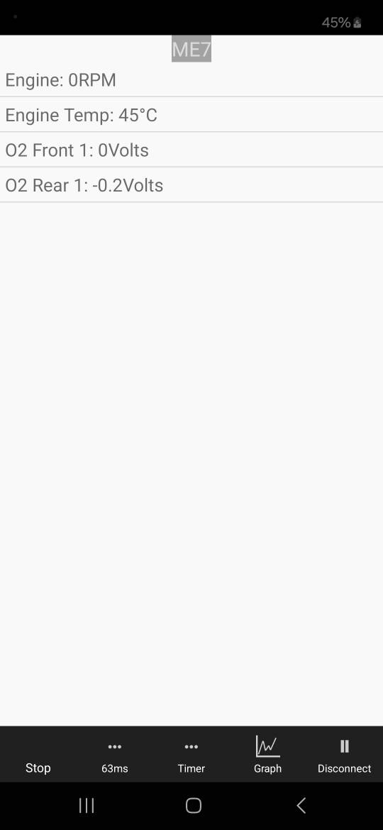

I am gonna leave this now as boring technical information which i did end up confirming now too with on my bench ME7 ECM.
ME7 Volvo (not all?.. all? i dont know) ECM only shows PID 15 Aka Oxygen Sensor 2 registered for Standard OBDII Emission data even though shows for two Sensors to be present so no PID 14 Front Oxygen sensor reading for this Standard OBDII way.
.. but after little accident i found how to make natively ELM327 talk Live Data finally with CAN Bus very flawlessly on P80 and P2 systems so now after couple days work included ME7 in there as starters.
