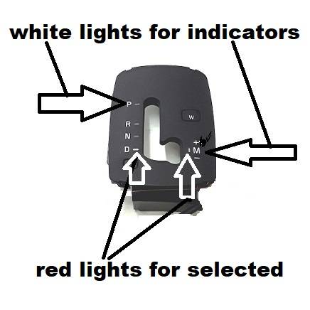

Took plenty of time on replacing. Positioned just as shown below (smooth side up, ribbed side down). I think the slider with the magnet can only go into the blind one way. I never disconnected the shifter top circuit board as there was room enough to simply move it out of the way. Seems to me everything was reassembled correctly. The shifter shifts smoothly, all lights on the faceplate I notice that the white shift indicator lights for illuminating for P,R,N,D, and +M- light when the key is turned on. The small red indicator lights work with P,R,N,D as selected...but there is no red indicator when shift moves to the right to select +M- (and of course no geartronic). I am wondering if the shift blind magnet may be causing this? or if it may be a bad control board? Or even if the blind magnet may be inserted in the blind body incorrectly (from the manufacturer) ...possibly reversing the magnets polarity.
I'm at a loss here... If anyone has had this issue... can you let me know what fixed it?

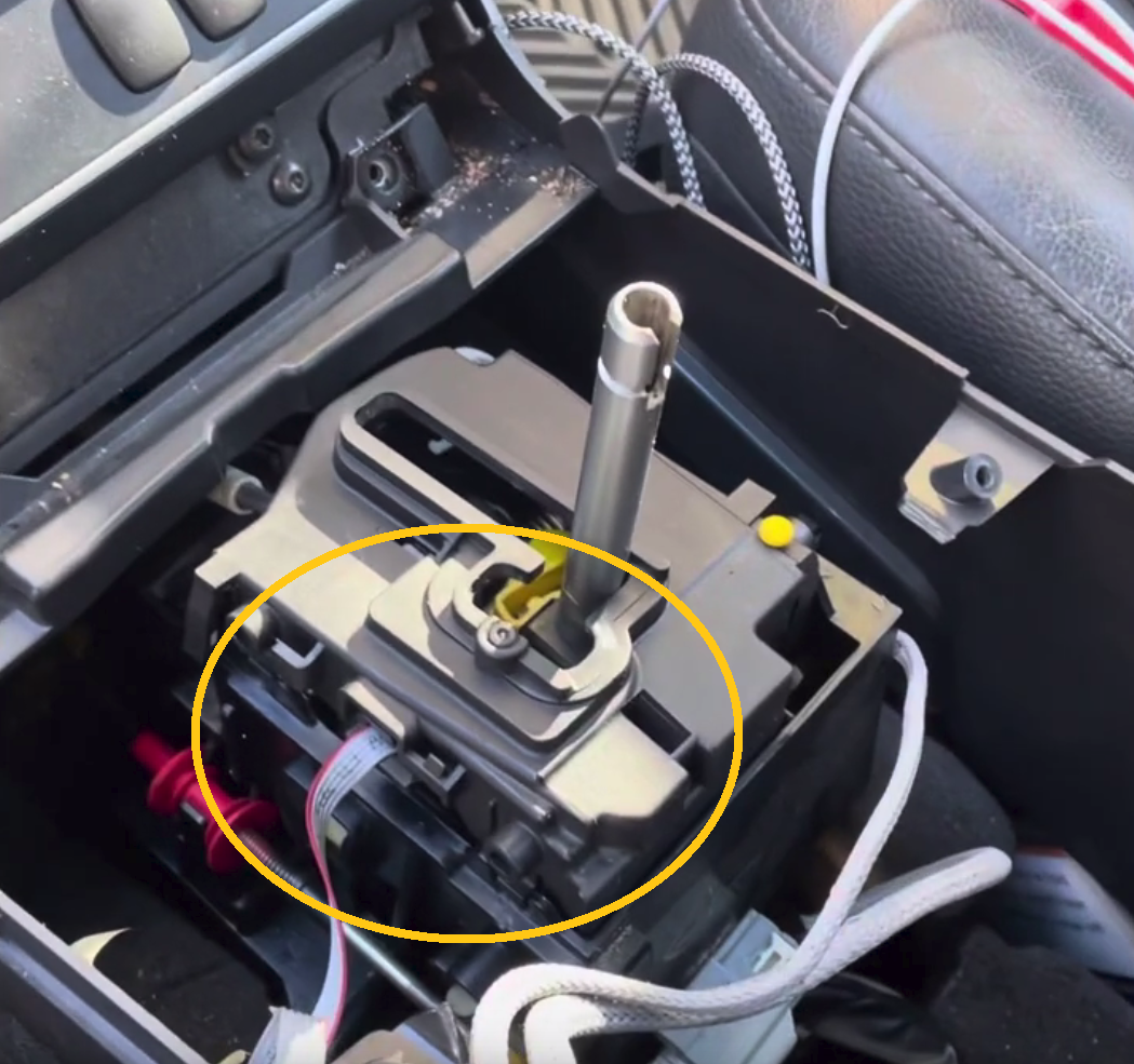

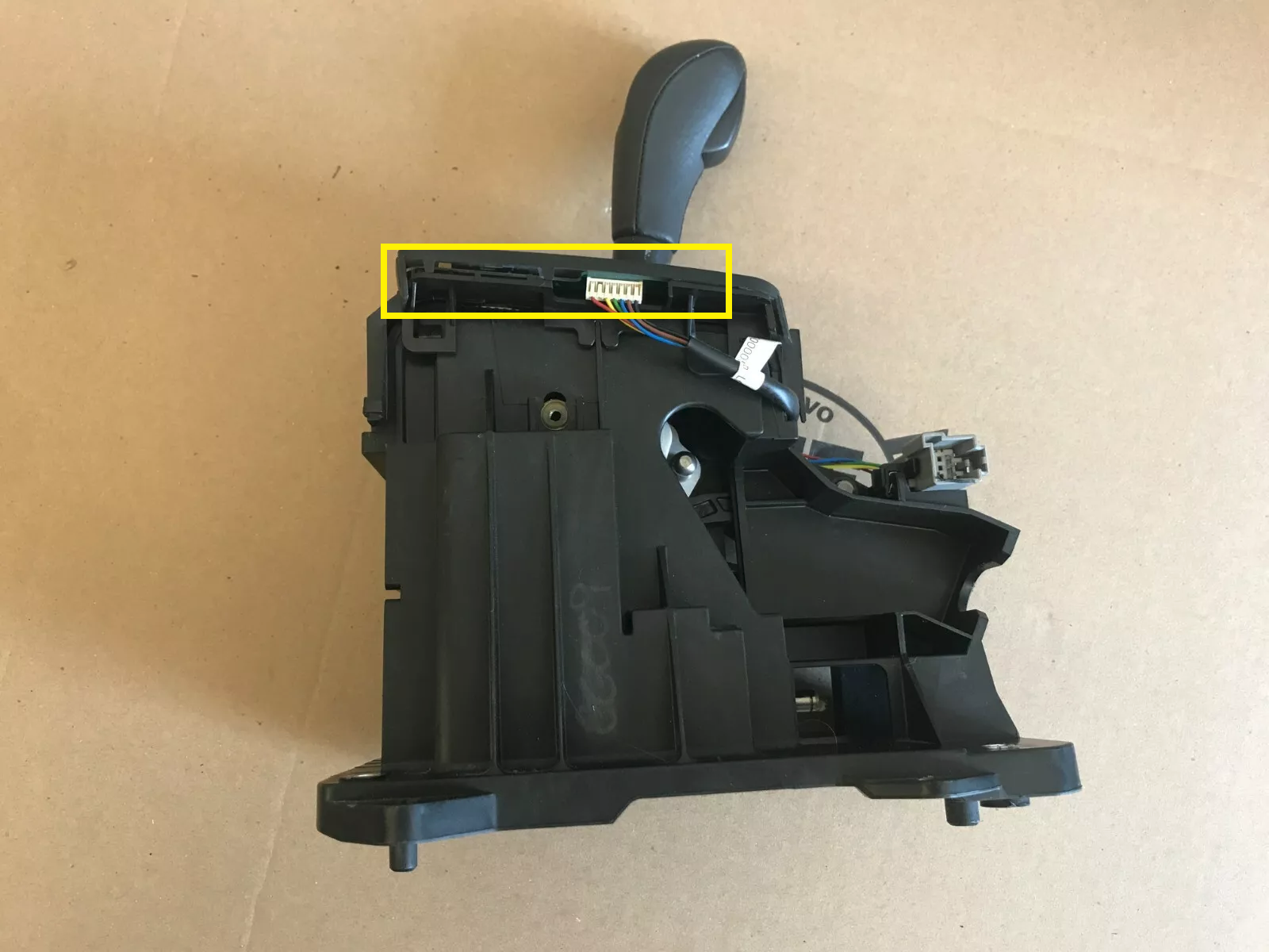

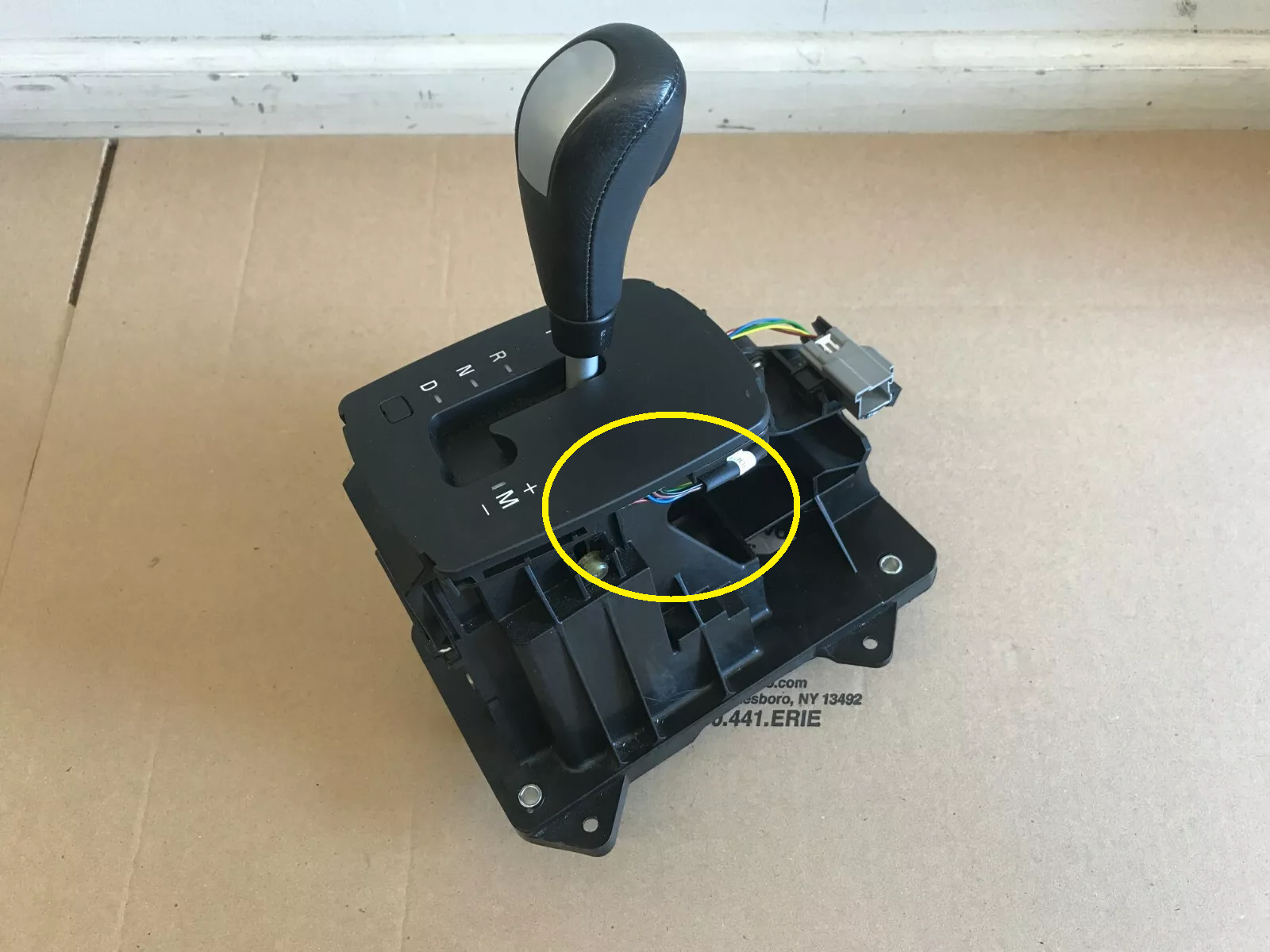

Though the 09 C30 shifter differs from the 12 XC90 they should basically have the same type of system for the shifter. Our C30 T5 is a M66 so guessing about your issue.
In repairing the shifter lever I became acquainted with all the parts. If the system principles are the same then here is the part that's responsible for the Geartronics. Check your wiring and cables (if any). For the XC90 once in Drive the cable doesn't move fore or aft when you slide to Geartronics so it's up to the sensors in the board. Can purchase the shifter panel with the circuit board or without. The circuit board is lengthy.

**********UPDATE TO THIS POST: ***************
I notice that the white shift indicator lights for illuminate for PR,N,D, and +M- when the key is turned on. The red indicator lights work with P,R,N,D as selected...but there is no red indicator when shift moves to select +M- (and of course no geartronic). I am wondering if the shift blind magnet may be causing this or if it may the control board?
Anyone had this particular issue?
