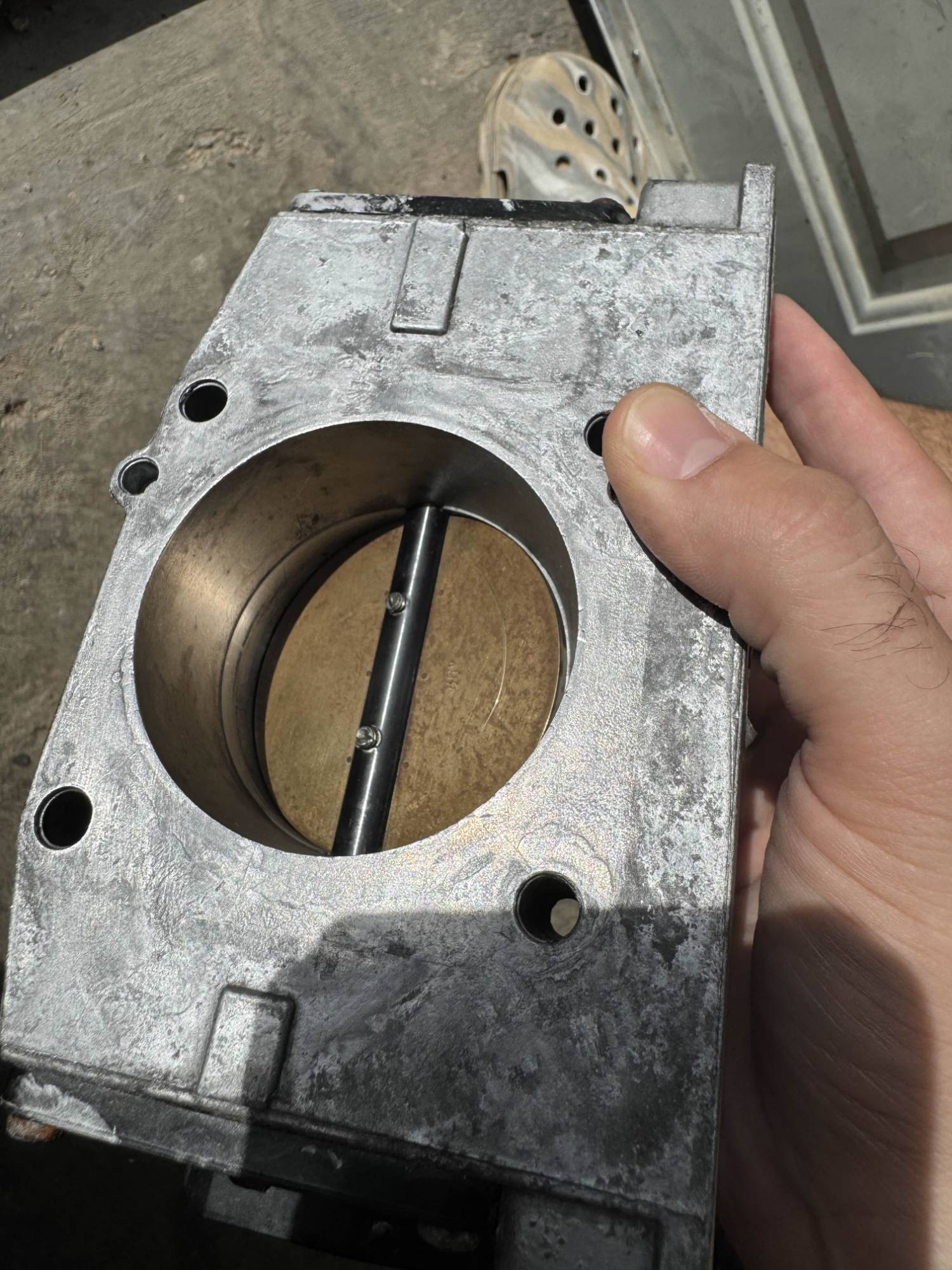

ETM cleaning will begin today with the one currently uninstalled (one that was removed before I tried my alternate)

I am not 100% sure if i have a cable or electronic operated throttle body. I believe it is electronic, but I cannot confirm yet.
I have attached a few images.

You have an electronic throttle module (ETM). Volvo started fitting there in 1999 Model year.

I tried my best, but I cant help but OCD over how poor the result looks. I understand its likely normal for an old used part, but I'm really not satisfied with how the result looks. I probably spent a good 5-6 hours cleaning this over and over with a flathead surrounded by Q-Tips and a multi layered cloth soaked in Throttle Kleen, followed by another round with just Q-Tips and the rag, just a rag, a tooth brush, and a slightly harder plastic brush. By the end I could not handle the fumes and threw in the towel.
Throttle body cleaner: The following are other spare parts or items I have available.

Spare throttle body:

- Posts: 36145
Throttle body looks nice and clean
Its also a Xmodex rebuilt version, which Is good news
