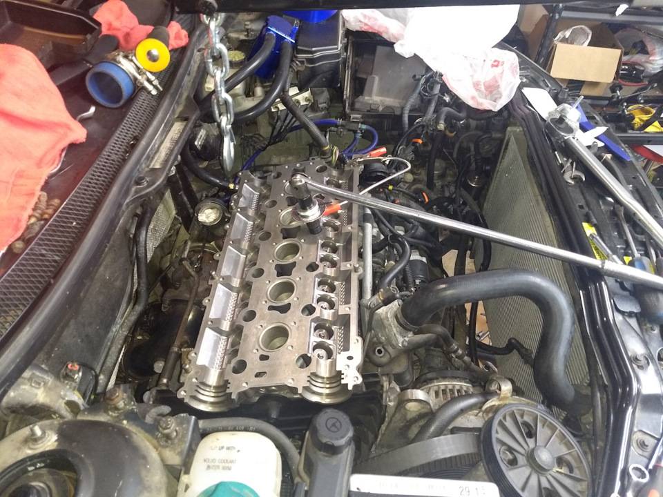

Just got the head installed on a 2004 XC70 with a 2.5l 5 cylinder. Torquing the first two stages was pretty straightforward, but now I need to do 130° of further rotation on the 10 new head bolts. Are bevel protractors and actual tool that I can buy at an auto parts store? I've never seen one in the wild before. Should I just draw 130° on the top of the head with a sharpie and hope for the best?
https://charm.li/Volvo/2004/XC70%20L5-2 ... rotractor/
Update: the local auto parts stores do not have these in stock "anymore". Had to go with Amazon.
Resolved: 130deg wasn't that hard w a 24" breaker bar. Thanks for the Amazon suggestions.

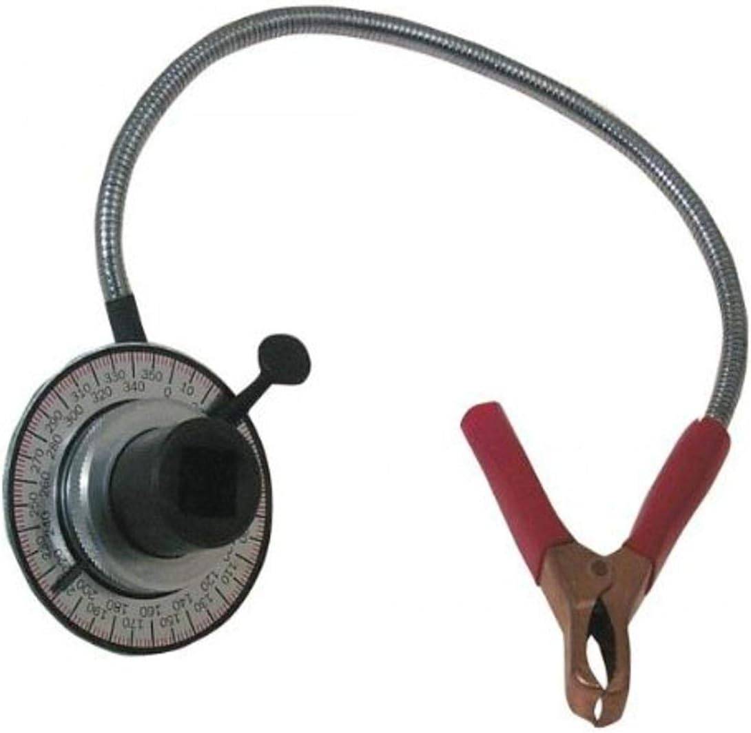

The cheapo I got one was a Chinese one. They come in different flavors, the gyst is to have it stay still so that you can do the final 130 degrees.
A small warning though, 130 degrees is very very hard to do 😃

It is a thing, yes. Don't remember, Amazon or Harbor Freight.

Lisle 28100

I've never used one of these, I've just made paint marks to judge where I was. Does the jumper cable-looking clamp just hold it from rotating?

BlackBart wrote: 23 Oct 2024, 13:59 I've never used one of these, I've just made paint marks to judge where I was. Does the jumper cable-looking clamp just hold it from rotating?
Yes.
