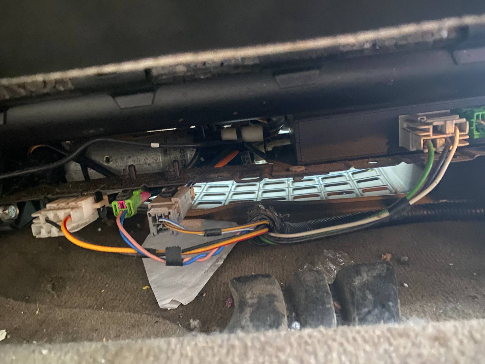

the connectors all look clean - like brand new type clean. I can t figure it out. It has to have something to do with the seats being switched.
I will try and take a couple of pictures of the connections under the seats and put them up here.

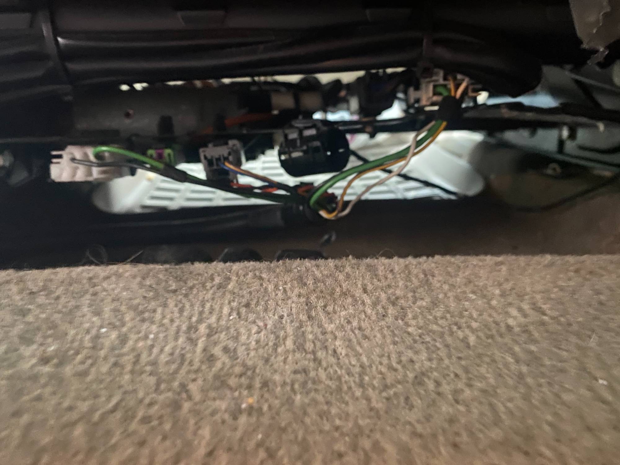

here is a shot of both front seats drivers first and then passenger

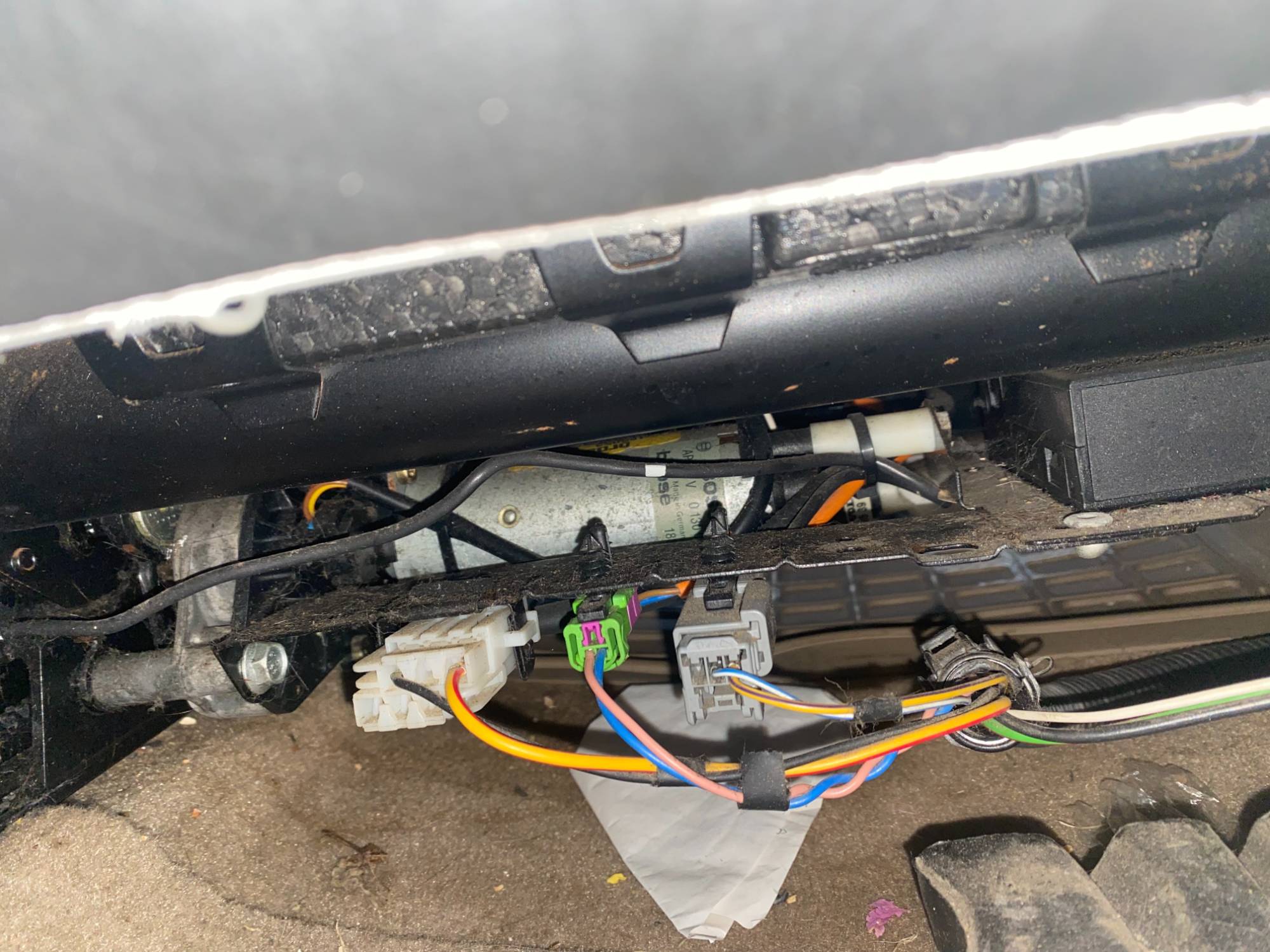

sorry - here is a better one of the driver side - i selected the wrong one...
