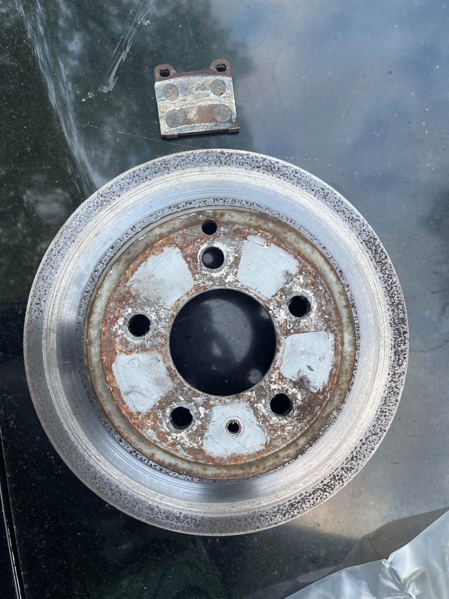

Rear brake RR 183.5 by9 may
Followed this thread
viewtopic.php?p=677777#p677777
New Volvo rotors FCP
New Volvo rotunda pads
UBG calipers from Shagg
New hardware
Parking brake shoes were good
13 mm caliper bolts
1 8mm passenger bleeder, 1 9mm bleeder driver
Pushed 250 mo per caliper
