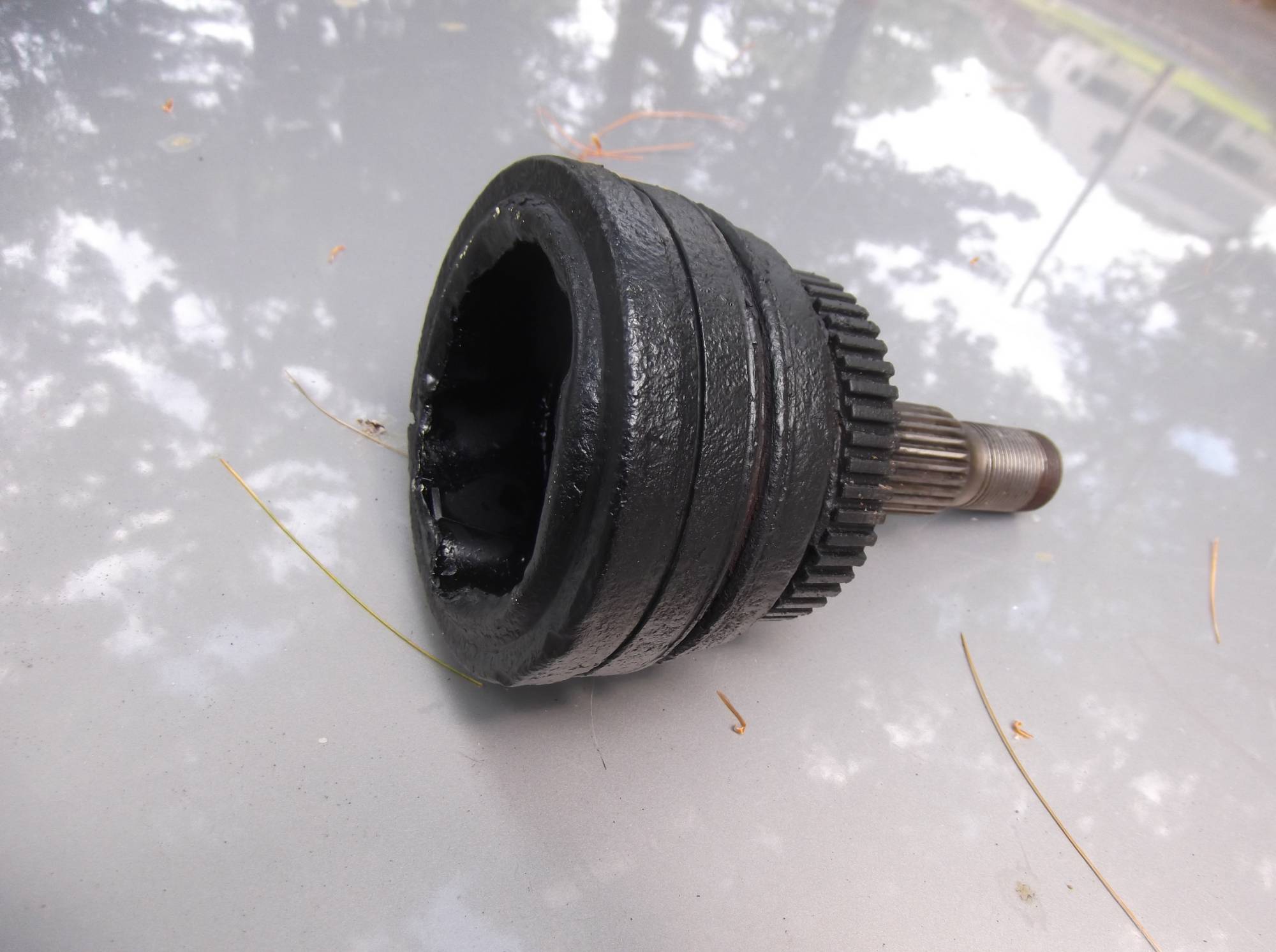

this project has been dragging a bit but I am back on it.
Kind of odd but after I got the knuckle off and onto the bench the wheel bearing seemed fine. In the car it appeared defective , the wheel wobbled when spun with the caliper removed .
but I had bought bearings so fine I swapped it out. I thought maybe the axle shaft was an issue but it actually was fine also.
The wheel was wobbling in the way my ford truck bearings would when the lock nuts back off , the drivers side did not wobble .
After removing the hub which was fine , I found the snap ring was rusted to the point it was not removable in the normal way it had to be chiseled out. The new bearings did not come with snap rings or possibly I lost them the bearings have been on the bench for a few years now.
I had to bring the knuckle to capeway bearing in plymouth MA and have them measure and hook me up with new snap rings which cost $10 each .
I dismantled the axle shaft to make my stub axle and will put it all back together tomorrow.

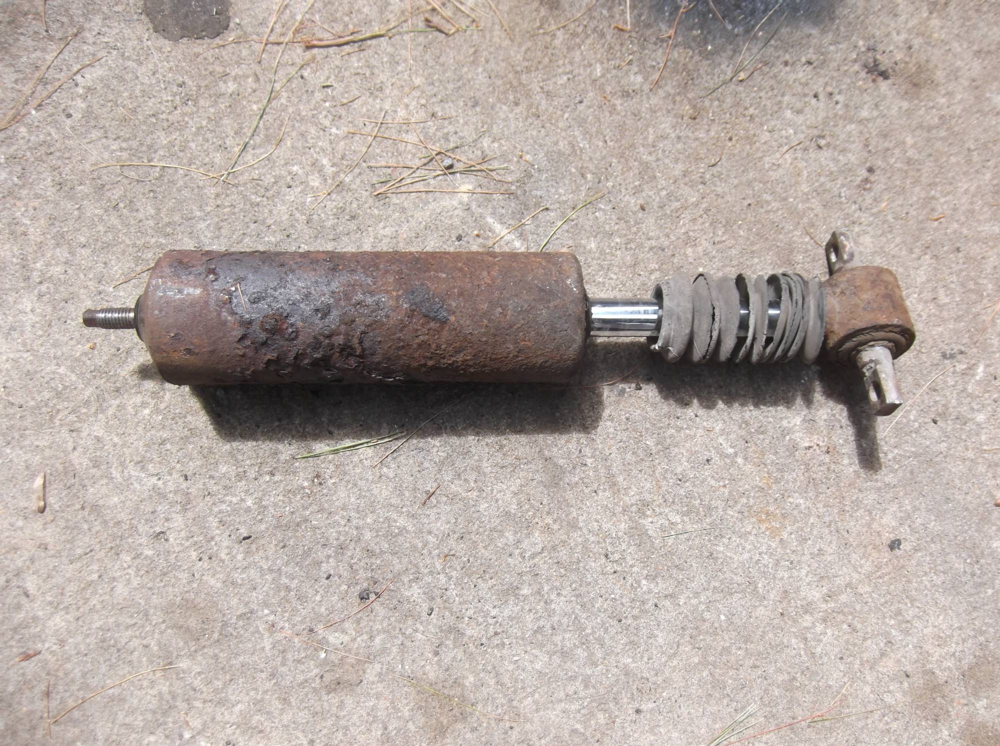

In the meantime however I decided to remove the shock and replace it but I dont think its a normal shock , its massive .
Is this a nivomat(sp?) shock? It appears to be fully extended and will not compress , is that what they are supposed to do or is it defective?
I only ask because it is much larger in diameter than any of the replacement shocks I'm seeing online but extended length seems to be the same .

Yeah, Nivomats. You won’t be able to compress them by hand. If they still work, consider yourself lucky. Magical when new/functional though

the passenger side is put back together with the stub axle I didnt put the ebrake stuff in because the cable is in need of replacement but I bolted the tire on and giving it a spin it rotates much easier than it it does with the axle attached to the rear diff.
Kind of odd because the stub end of the axle basically acts like a spindle now only it rotates instead of being fixed.
seems a little strange but it should be ok.it serves no real purpose except to internally support and preload the wheel bearing and keep it from walking out of the knuckle.

I just assumed they were no good but if they wont compress does it indicate they may still be ok?V50M66 wrote: 24 Aug 2025, 21:08 Yeah, Nivomats. You won’t be able to compress them by hand. If they still work, consider yourself lucky. Magical when new/functional though
I'll put them back on for a while if they are

turns out the drivers side nivomat shock had a dime sized hole in it and all the oil had leaked out.
Potentially that one was non functional and the other was jammed extended

When new they don’t compress by hand. But yeah, those are shot.
You’ve got a couple options for replacement. Obviously new Nivos are an option, but not wallet friendly. Magical if you haul stuff frequently though.
If you want to retain stock ride height, get a set of non-Nivomat springs (they’re different) and use either S70 AWD non-Nivomat shocks or press QA1 BAR505K t-bars into any P80 FWD shock of your choice.
If you want to lower it, get the aforementioned S70 shocks or make your own AWD shocks and pair them with BNE’s adjustable rear spring perch setup and some Eibach linear springs, then use the front half of a FWD lowering spring kit up front.
