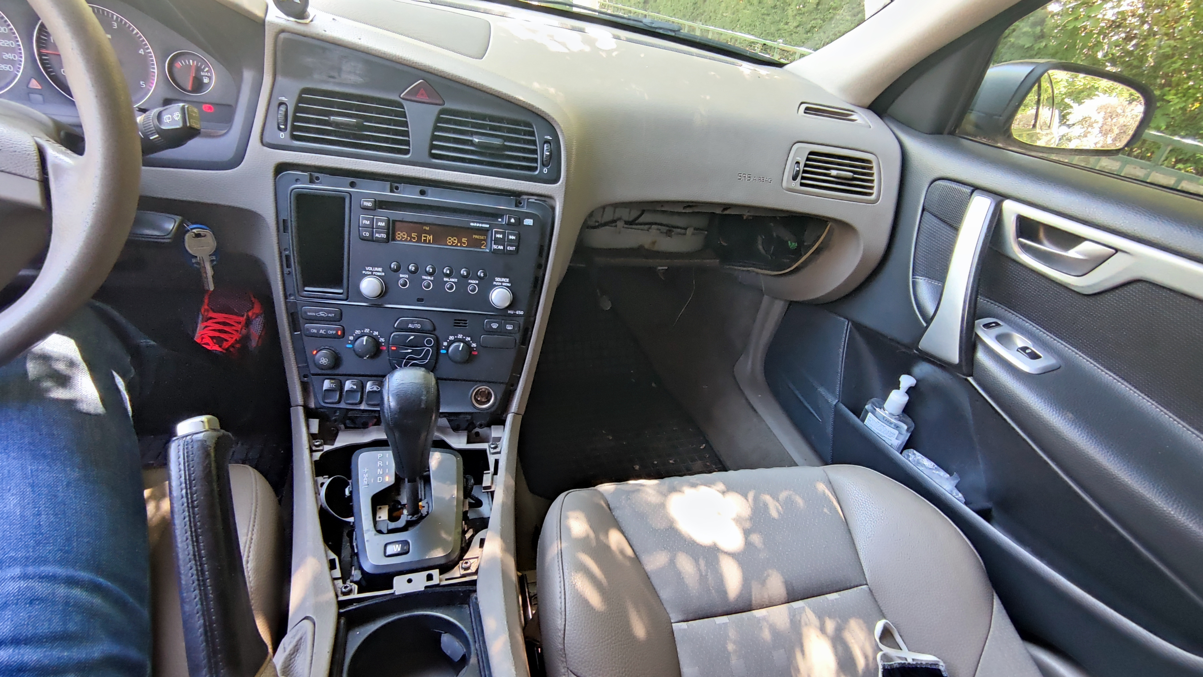

As you can see I already remove the glovebox and I have acces to all blend door actuators ( none of them work )but on the driver side, like you said, it's painful, so I'm willing to remove everything in order to have better acces and also do a little maintenance.
If i can't find the problem then...I will transform it from double climatronic to single climatronic
Thank you very much
