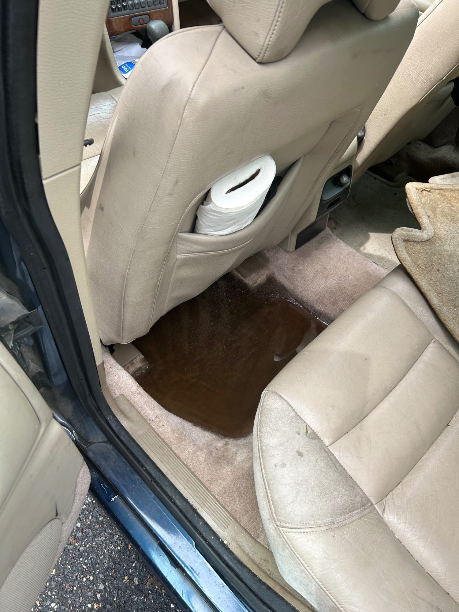

I have water in the boat. Getting tons of water in Karla.
Sun roof drains running clear , check..
Door seals maybe?
Coolant level ok. Vacuumed two gallons out today.
P80 green board…no wait…water in the engine room , Sir! [Blocked cowl drain, left side] Topic is solved

Well that is hard to miss. Only in back foot well? Wet seats? Pranked by the Ford truck up the street?
- Posts: 36137
- Been thanked: 4064 times
Dry seats. I’ll check three sunroof drains.
No signs of water thtough door seals.
Stumped.
Stumped.

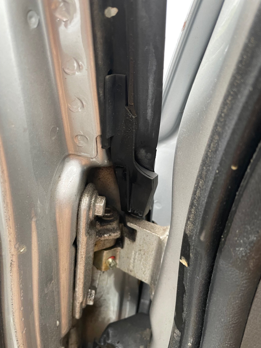

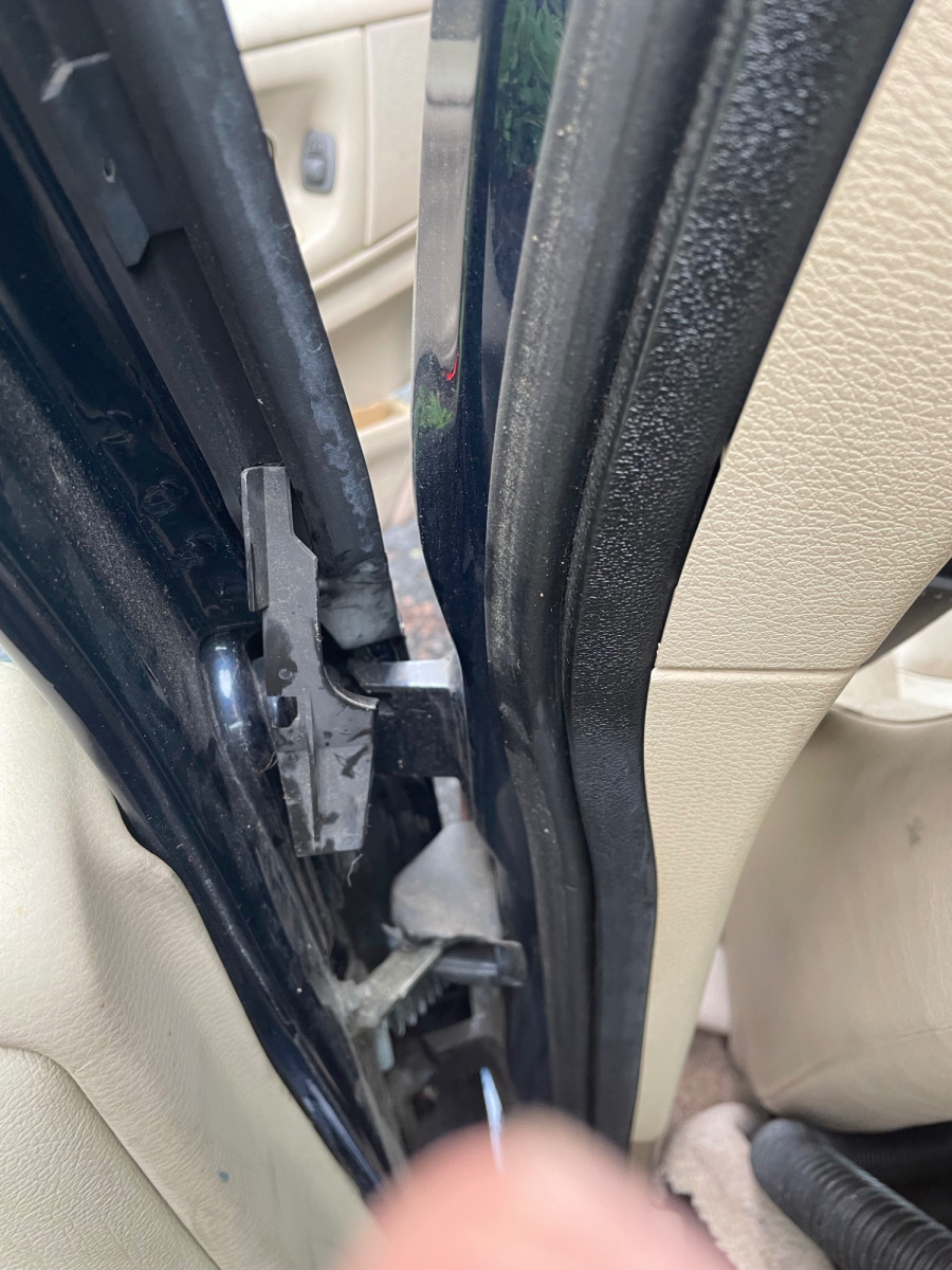

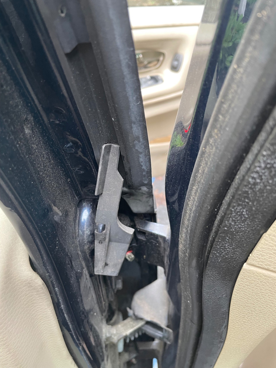

6 inches of rain and water in the boat again. Looking at door seals I have something going on here, not right.
there is a piece of plastic trim out of place on the LHS rear door that might be re-directing water into the cabin
