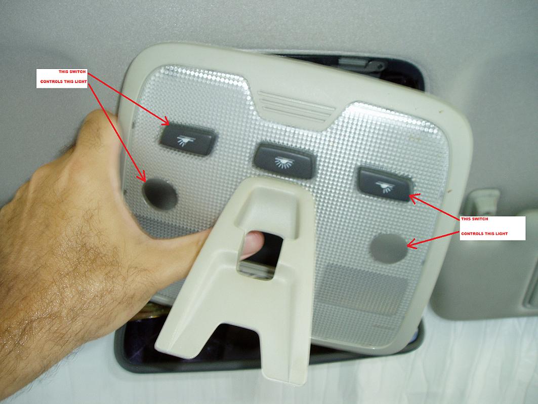

Are you sure you are pushing the correct switches for the lights? See below:

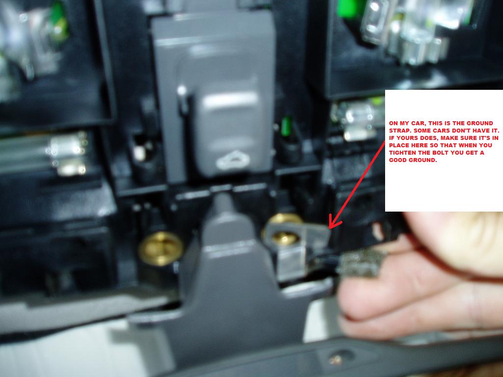

Here's a pic of the ground strap. If your car has one, make sure it's in place as shown.
i dont find the ground strap...i thinck my car don´t have one...
