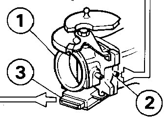

Question is where is the air pressure sensor located? ,there is no unit on the intake elbow as with the multi point systems

I don't know a thing about your sister's car but looking it up on VADIS, it sure is nice looking! Do you have any pictures to share? VADIS (when switched to European models- I'm in the U.S.) shows an "intake load pressure sensor" on the throttle body. I'm assuming this is the same thing as an air pressure sensor. It is #2 in the diagram below:

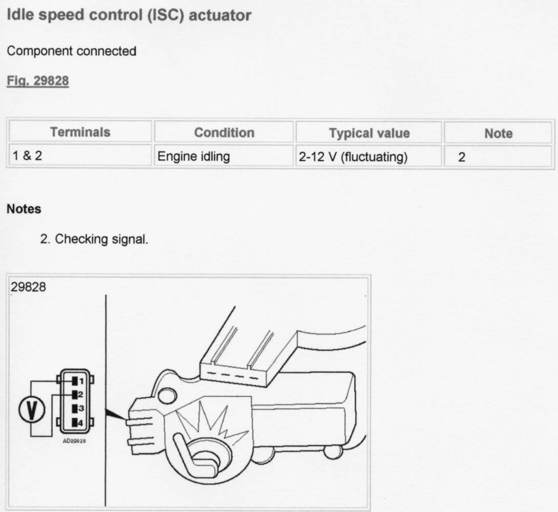

To check the MAP sensor: 2-2-3 on the single point injection is the Idle Speed Control (ISC) actuator, signal error/signal absent.
Possible causes are wiring short or open circuit.

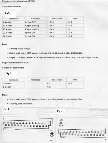

If you have more power then the MAP sensor was probably iffy.
Check the Engine Control relay and the ECM:
