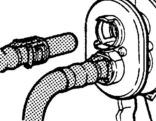

I believe there's a special connection at the block and you're going to be stumped trying to figure out how to join the two outlets. It would be much easier to join the two hoses that connect through the firewall. The diagram below shows you how they pull out of the firewall:
heater core hose ends.jpg (61 KiB) Viewed 667 times

MadeInJapan wrote:I believe there's a special connection at the block and you're going to be stumped trying to figure out how to join the two outlets. It would be much easier to join the two hoses that connect through the firewall. The diagram below shows you how they pull out of the firewall:
Very cheap fix for the above illustration. Should be a couple of inches of appropriate hose (3/4" from above notes) and a couple of hose clamps. The water pressure is on the low end, so if this is a temporary deal, just get the ends of the hose connected together. The water goes to the heater core in a bypass fashion, so if the hose kinks, it shouldn't be a huge deal.
