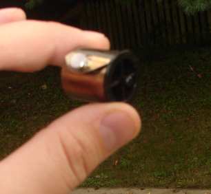

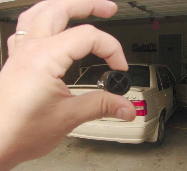

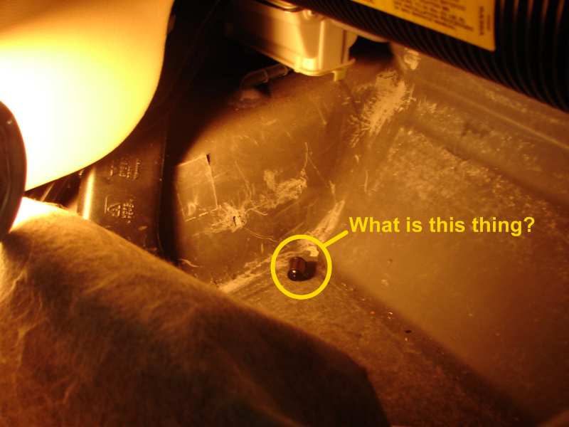

In an effort to get to my heater core, I pulled back the passenger's side carpet and the plastic shielding in back of it, and this little creature popped out. What is it?
Please see the pictures -- it resembles a miniature roll of film.

I could be wrong but it resembles the mechanism that enables the "push" operated ashtray. It only looks familiar "cause i broke mine trying to take the entire tray out instead of the insert just to empty it.....yes this is my first volvo...lol

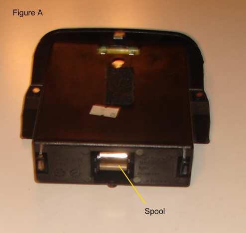

Correct, this thing aids in the push-to-open feature of the ashtray. It's a plastic spool with a wide band of copper (?) wrapped around it that works as a coil. When the ashtray is pushed, this thing works in conjunction with a number of components to open the ashtray in the opposite direction from which it was pushed.
It took me about 20 minutes to figure out how to get this thing installed-- this ashtray is quite a little engineering marvel. Hopefully I'll save somebody time and frustration - but if you like puzzles, you may wish to figure this out on your own.
The design is such that the spool sits in a couple of grooves in the back of the ashtray sub-carriage (see Figure A). The copper coil must reach over the top of the mobile sub-carriage to a silver peg that will be lodged in the hole adjacent the light window of the housing (see Figure B). The spool moves with the sub-carriage as it opens and closes, while the peg stays affixed the to the immobile housing.
The trick seems to be to remove the silver peg before you do anything else - set aside, but within reach. The spool should also be free from the unit at this point and the sub-carriage should be in the 'closed' position. Unwind a good length of the copper coil and put it through the opening in the rear of the housing and onto the top of the sub-carriage. Push until you ensure that it stays atop the sub-carriage and continue pushing until you can pull it out at the front of the unit. You may have to shift the sub-carriage to the 'open' position during this process, but I forget.
Secure the protruding coil with one hand and install the spool with the other. Then place the peg into the hole in the coil and slip the peg into the hole in the housing.
