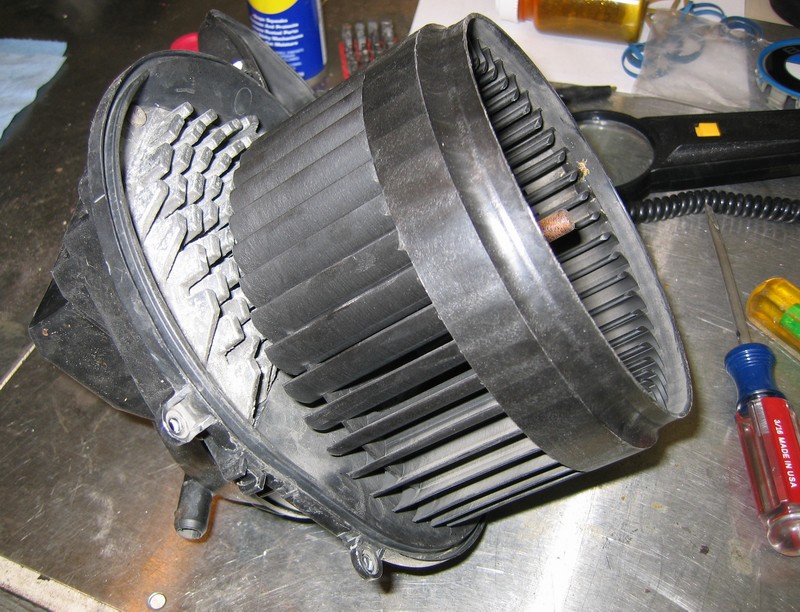

JimLev
Posts: 60
Joined: 2 May 2009
Year and Model: S60, V70, 540BMW
Location: NM
Post by JimLev »
Yes, that was where it is located. I did take a few pics of the fan when I had it out. If I can find them I will post them.
I did remove the glove box.
IIRC you need torx bits to remove the fan.

Post by JimLev »
Here is the only pic I took of the blower.
