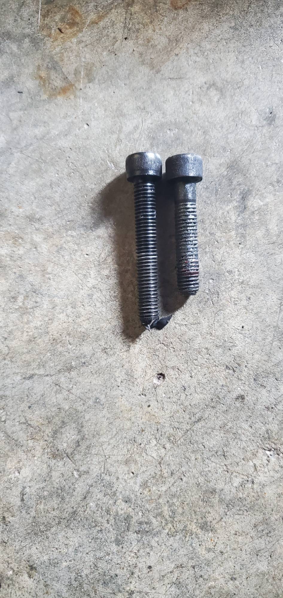

The bolts that came with the kit I bought are longer than the original and stick out of the back of the angle gear flange. I didn't want to run into a problem down the road where the exposed thread rusted and made it difficult to get these Allen head bolts out, so I reused the original bolts, that I had kept in their original placement relative to a mark I made on the flange.
My bolts were clean, and the Allen socket heads were clear, but yours may be crusty and not worth re-using.
I definitely recommend putting the car up with jackstands on all four corners so all wheels spin free so you can put the transmission in neutral to spin the shaft to whatever position you need, and then put it in park with the e-brake on when you need to put any torque on it.
A bit ratchet with a 6mm Allen 1/4 bit will make removing/replacing the bolts after they're broken free a lot easier. Harbor Freight sells one as a "ratcheting right angle screwdriver" for $3 but it doesn't come with any Allen bits.

Dab them up with antiseize and they will be fine. Originally these were used to balance the shaft but we have seen enough of them running unbalanced with no problems that probably is overkill
Volvo specs a bunch of colour coded bolts for balance but I’m pretty sure they aren’t available any more

Never had an issue. I have only ever seen 2 different lengths and never seen one yet with different length bolts in the same flange. I have re-used all of mine and have a whole bunch more from pulling AWD stuff out of junkyards!
The most important thing to do is to clean out the hex heads. I use a pick to get it clean.
