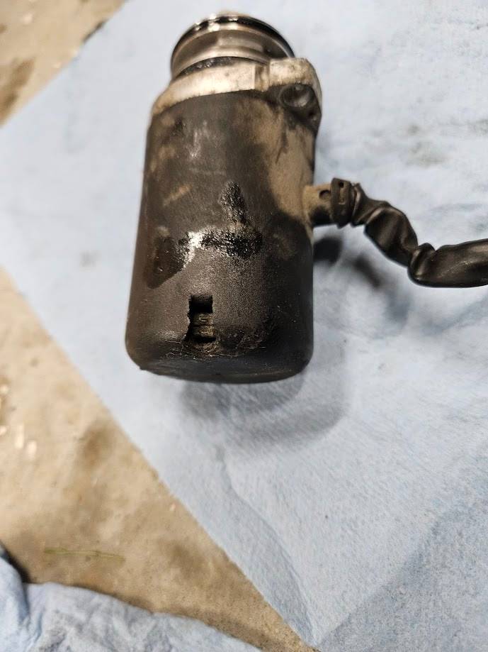

Well I found out why the pump died.
Some debris must of got up there and cracked the case? That crack is on the top side of the pump so I couldn't see it until I removed the flange. After I get her up and running again I'll take the case off and inspect it further.
oil pump damamged casing.jpg (57.92 KiB) Viewed 700 times

Post by vtl »
It's a man-made hole.

Post by XC70Rider »
vtl wrote: 25 Jan 2024, 08:53 It's a man-made hole.
It does look that way. It might of got damaged when I removed the flange nut with an air impact gun. I didn't secure the flange while loosening the nut.
