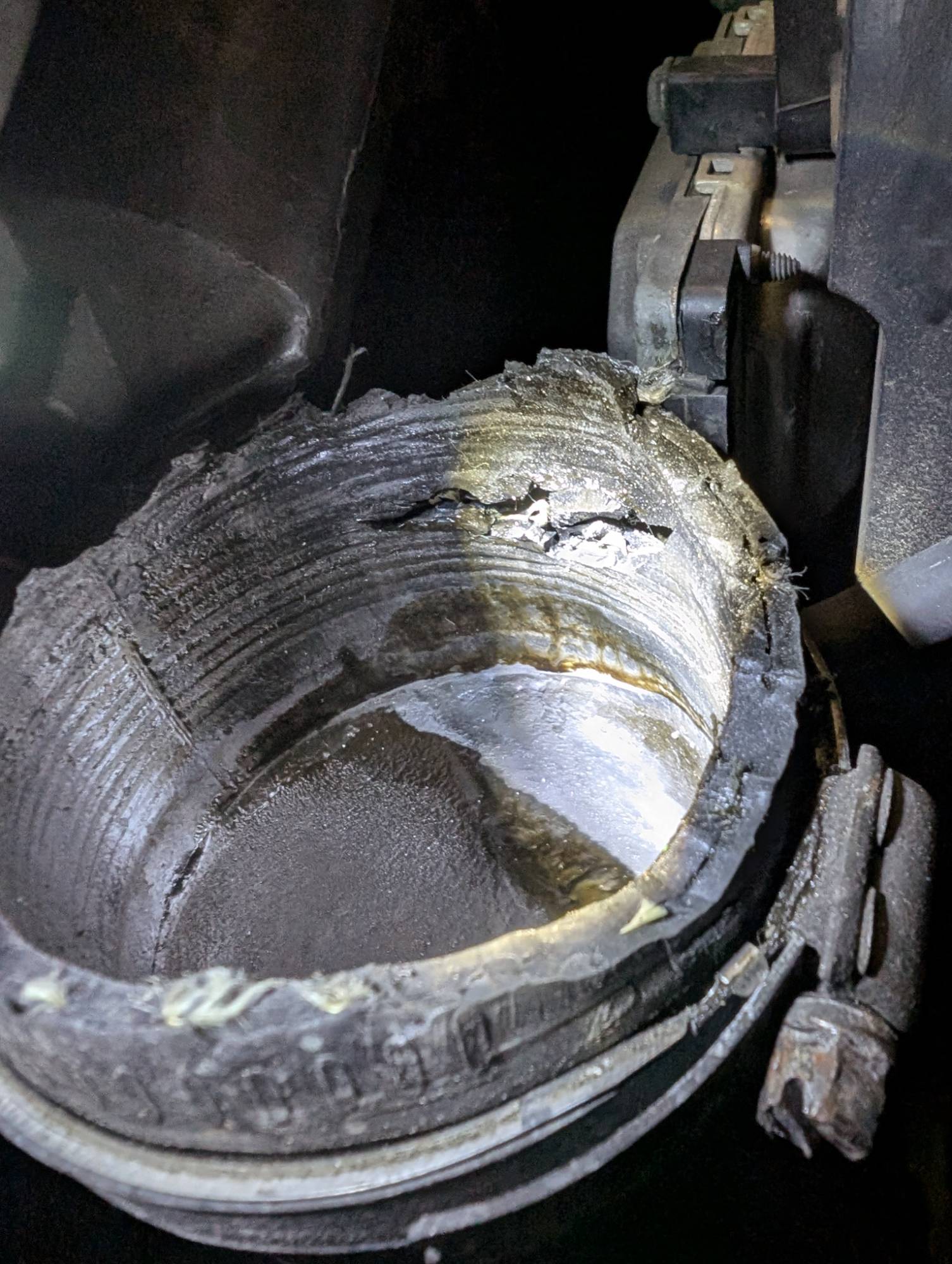

You can see the condition of the pipe. It was split where the pipe clamp stopped and sprayed oil all over the engine front and the throttle body inlet pipe.

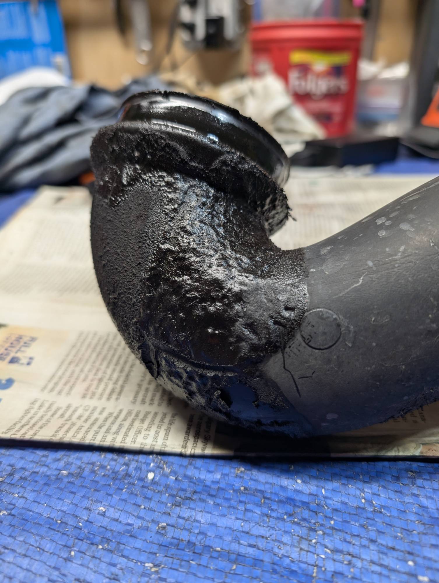

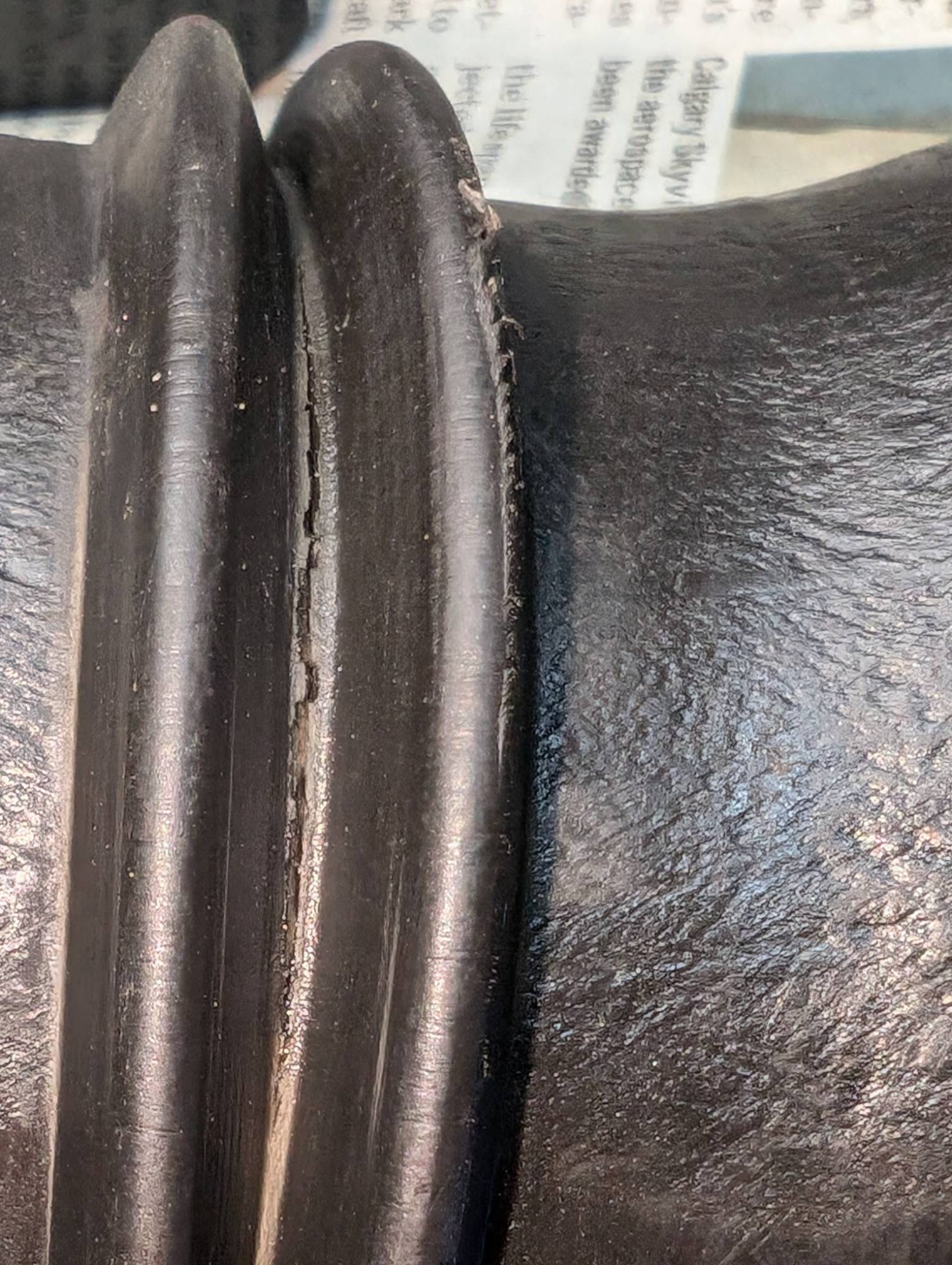

This is the crack in about the middle of the intercooler outlet to TB inlet pipe. Hopefully you can see the crack!
This is probably the worst one, but all had some oil on them.

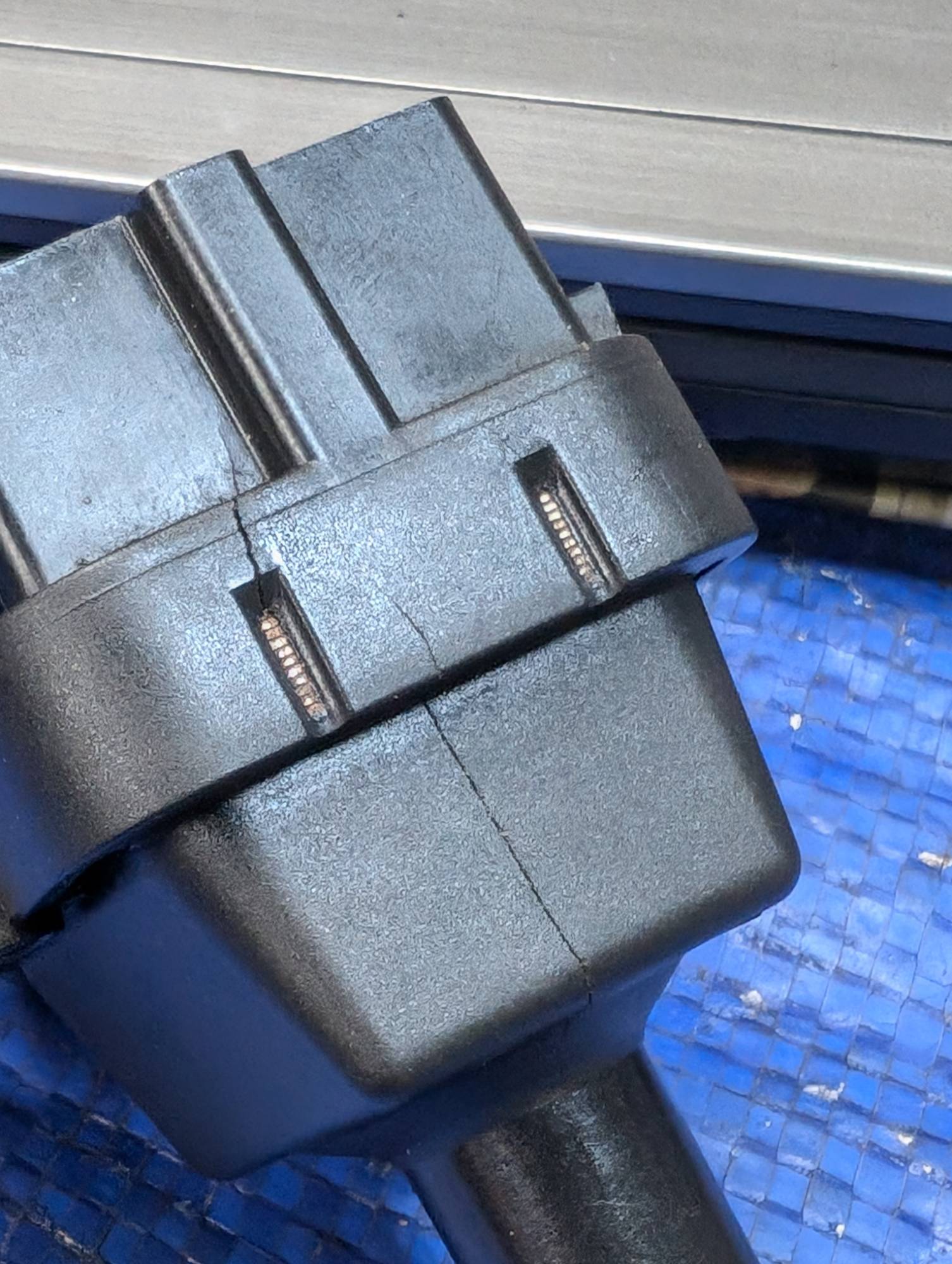

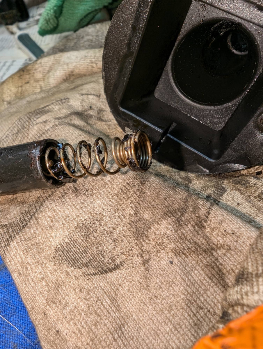

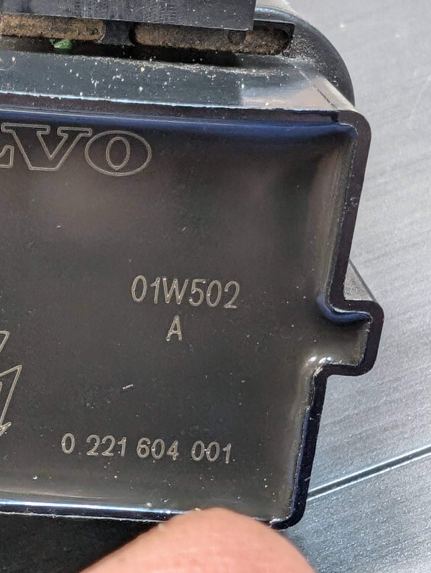

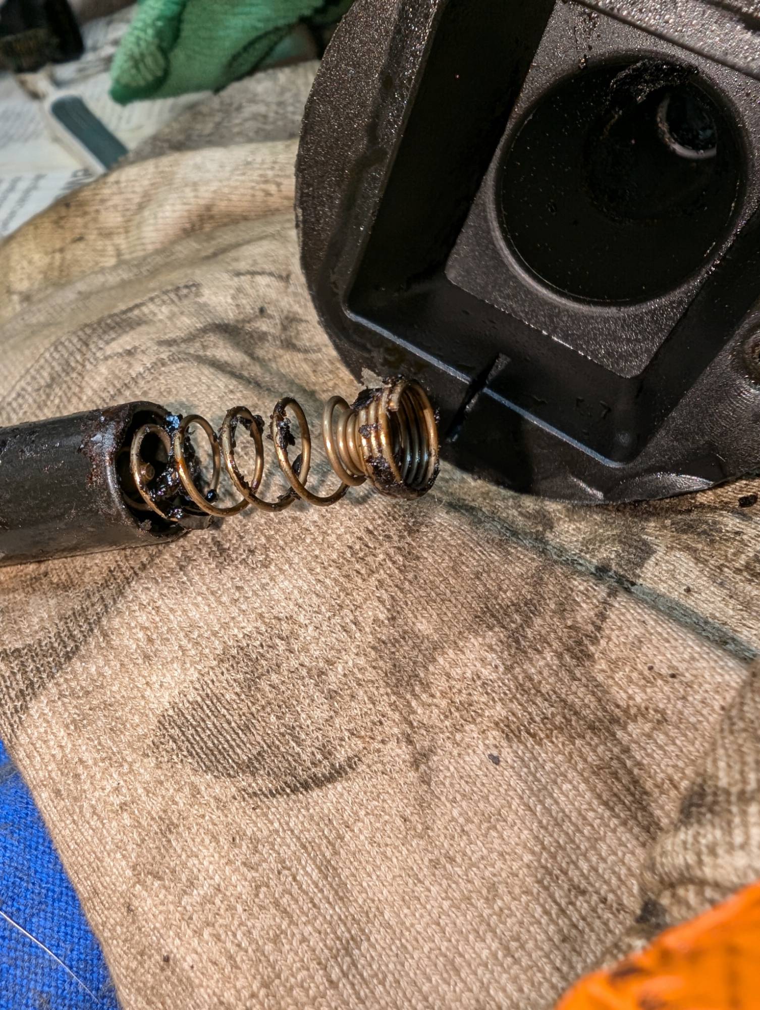

Original coils date 2001. All have multiple cracks in the casing and all had oil inside the rubber boots:

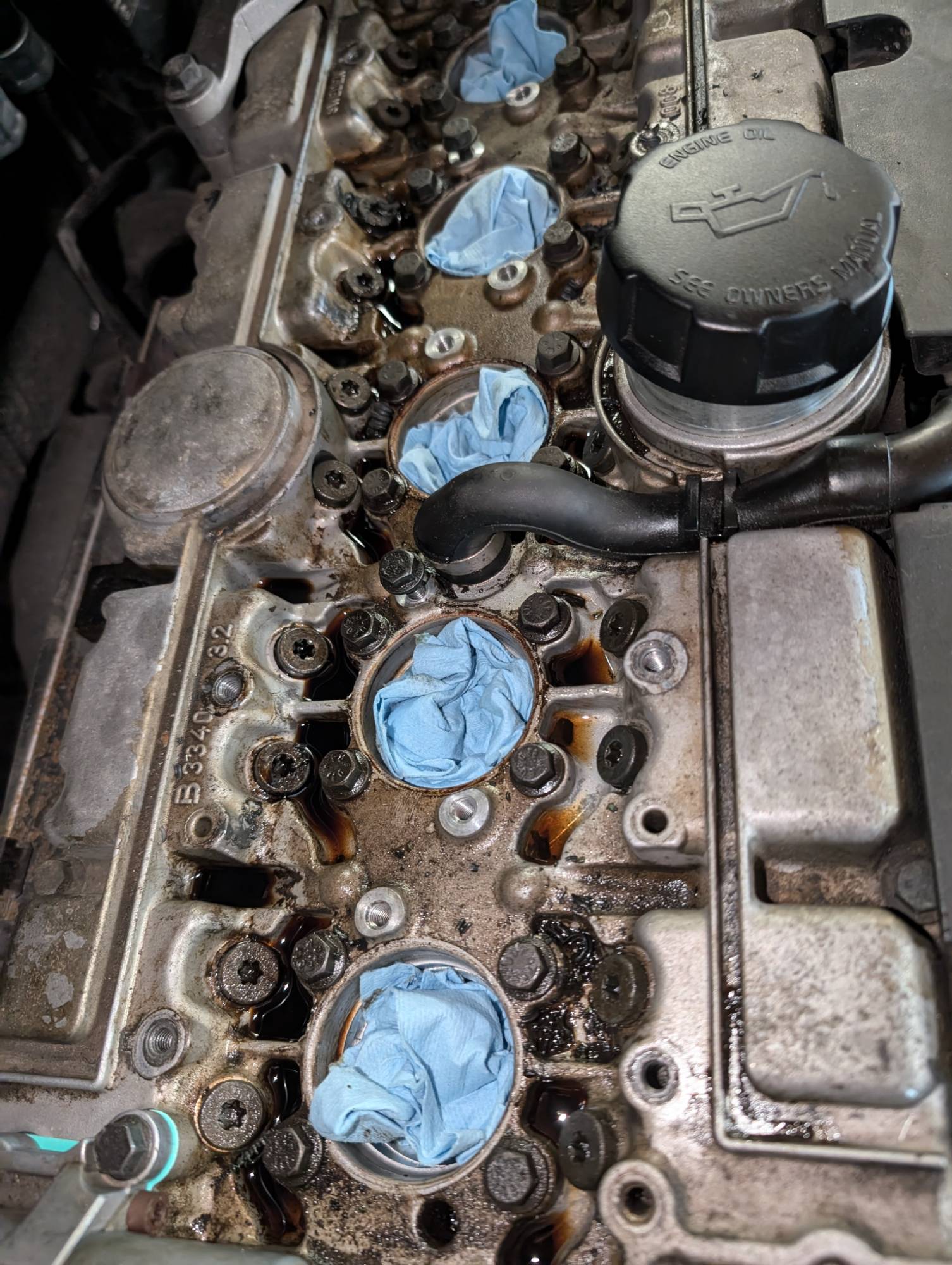

This is the top of the coil and spark plug area before cleaning!:
I guess a before and after is necessary!
Some of the work to date!

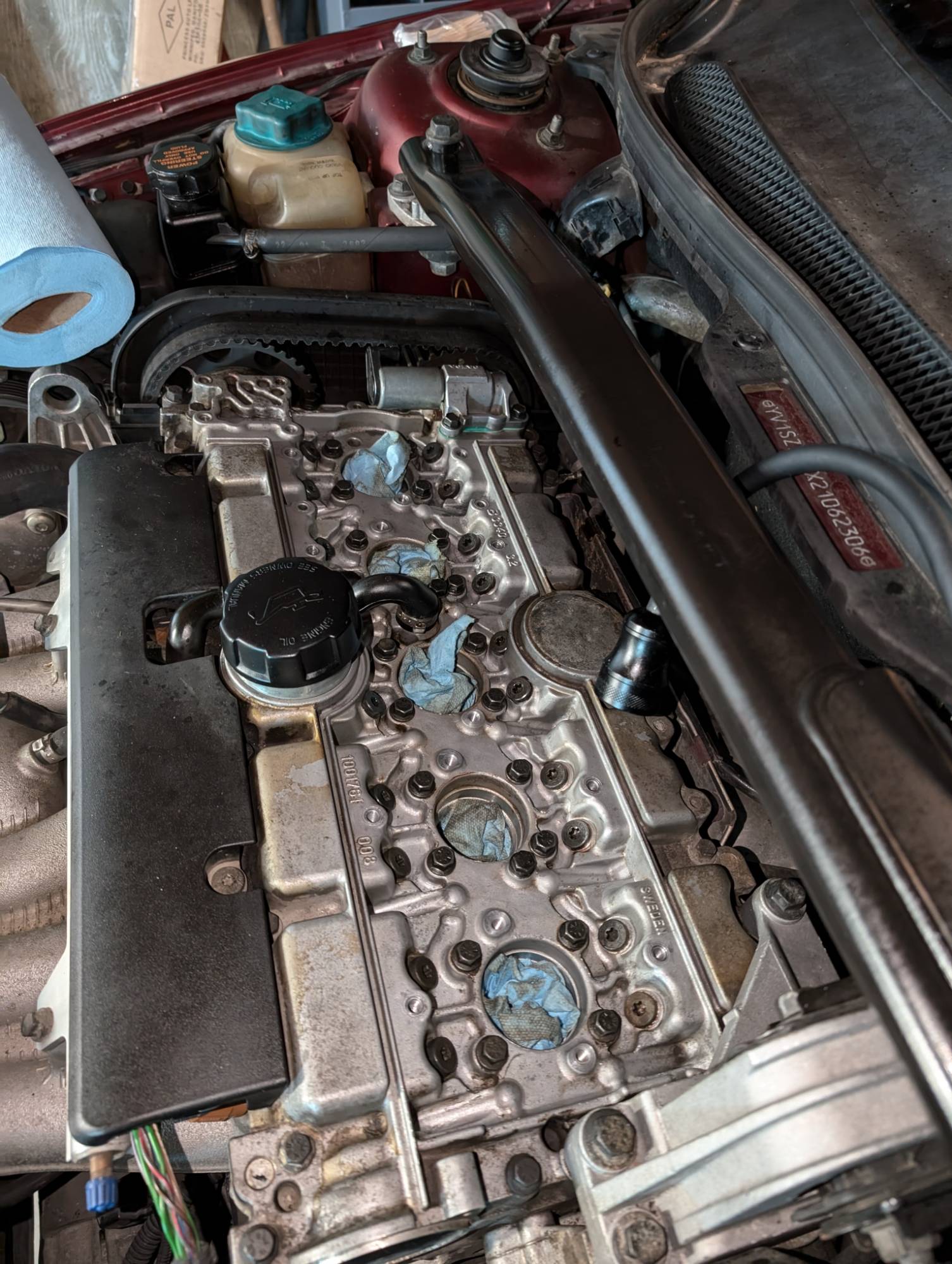

Bit of a slow day on the car due to lack of time. Plugs were gapped yesterday so lubed, fitted and torqued.
I then decided the coil and VVT harness needed some refreshing. A lot of the outer corrugated plastic covering had deteriorated and was crumbling. I cut and removed the bad sections and fitted new temp resistant tubing and taped it up. Took a lot longer than I was hoping!
Didn't refit the harness yet as it is easier when the coils have been fitted. A friend it dropping by tomorrow with a few and I also have some, so enough to fit better coils. Then the harness can be refitted which is a long way down to being able to hopefully start the engine and see if any of the work has improved is.
Had a look at the TB with a mirror. It is remarkably clean. I think I will try to clean it in place tomorrow. Then the pipes can go back on to the TB from the intercooler and from the turbo to the intercooler.
Last think to do is remove the MAF and give it a good clean. With a lot of luck maybe the car can get completed to get it started.
I will leave the spark plug cover off to allow me to see if there are any remaining sources for all the oil on the top of the engine. I cleaned the oil filler cap and replaced the crusty hard seal. I have doubts about the integrity of the oil separator to cylinder head line. I can't see if it is cracked where it goes under the spark plug carrier. The top and sides seem ok, just can't tell about the bottom side. Also as the section that fits onto the tube on the top of the hear is brick hard, I'm not sure if it is leaking where is crimped to the head. I have seen those pipes get really hard and then leak between the pipe and the tube it fits too. Will need to be monitored.
