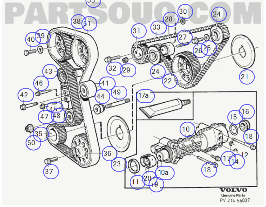

For any future Volvo 740/940 owners with the B234F engine I have created a list (below). I have seen it recommended that on your next timing belt change you also take the opportunity to upgrade some of the screws from stock 8.8 grade to 10.9 grade. Apparently screws are graded for their quality and endurance. Volvo will sell you 8.8 grade.
Here are the items you'll want to buy (from a third party):
(40) Crank/Camshaft Pulley Screw
M10x50mm x2
volvo pn: 987002, 955322 or 970952
aka: 4011105001_10
(42) Timing Belt Idle Pulley RH Screw
M8x55mm x1
volvo pn: 982801
aka: 4111805502_10
(26) Balance Pulley RH - Screw
M10x35 - x2
volvo pn: 982818
aka: 4102103501_10
(31) Balance Pulley LH - Screw
M10x55 - x1
volvo pn: 982822
aka: 4011105502_1
(37) Oil Pump - Screw
M10x30mm x1
volvo pn: 1
982817
aka: 4102103001_1
(47) Timing Belt Idle Pulley LH - Screw
M10x70mm x2
volvo pn: 982825
aka: 4111107001_5
I ordered these from tornillos-express.es in Spain, the same (French) company has brands across Europe. The final string of numbers in each section refers to their part number. All 10.9 Grade. Important if you want to make an investment in your interference engine.
One question for any total hardware freak- when dealing with higher grade screws, does the torque requirement change?
I haven't yet found the torque numbers for these items, not sure where that is published. Volvo garage will surely know. I did find this brilliant video of a guy changing the timing belt on a B234F which is nice.

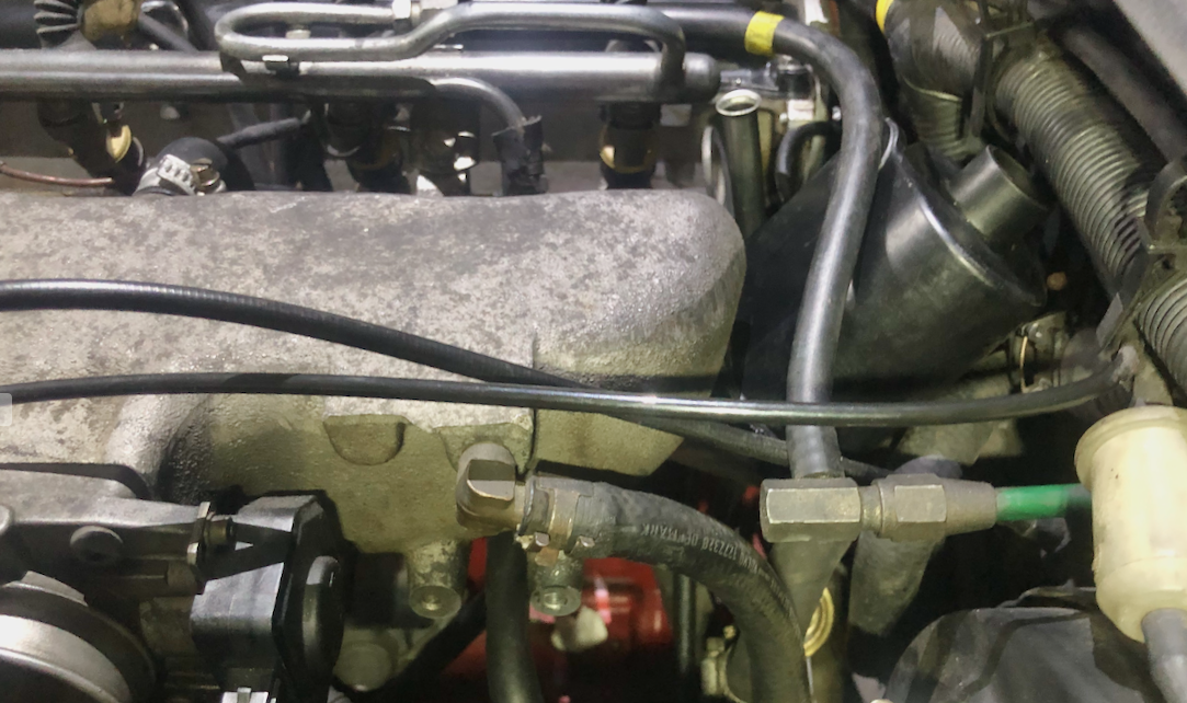

I suspect the front crankshaft seal at the pulley side, based on the location of the oil (directly under the crankshaft) and reading guides regarding the B234f engine online. I further suspect that this is due to pressure, due to PCV woes. Understand, I have not yet removed the "oil trap" aka "breather box" aka "PCV box" aka "crankcase breather". The Swedes know it by the term Vevhusventilation, either which way it is Volvo P/N 1326252.
Working along from the throttle body on the intake manifold... along to the MAF... along to the air filter box (air filter housing) I found traces of oil in and around the MAF and the air filter box and all the hoses along the way. The air filter... which appears not to have been replaced in a shamefully long time was disgusting. A bit of oil at the bottom of this housing. Rather disappointing as the seller had proudly advertised the engine was totally overhauled only 600 miles ago. Seems he forgot some basic stuff, and upon reassembling has forgotten to hang harnesses on various hooks and generally made a bit of a mess.
One thing at a time. Oil trap.
If you are finding this post in the future, I would highly recommend this introduction to vacuum leaks on FCP Euro, notes are based on working with a B234F engine. How lucky!

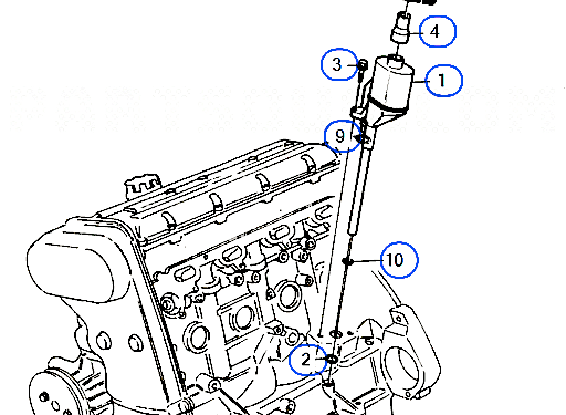

I have decided I must completely remove and clean the "oil trap". I hadn't done this earlier, when dealing with the flame trap because it didn't seem obvious at the time whether it could be removed (safely) without removing the intake manifold.
On the B234f the "oil trap" (1) has the quirk of having a long solid pipe connected to the base. This cannot (or should not) be removed, obviously (see a very amusing/confusing forum thread here).
Mentioned on that thread is the fact it is possible to remove the oil box without first moving the intake manifold, which is great if true. They mention moving the transmission dispstick to gain access, so I infer these are Americans talking about their automatic transmission version of the B234f. My 940 is a manual (M46).
Can it be done? Can the oil trap be removed from a Volvo 940, M46, B234f engine without the need to detach the intake manifold?. Perhaps the difference between what lies beneath the manifold, manual vs automatic is more to the point... is there much of a difference?
Perhaps on Sunday I will find out. Below is "before", hopefully a much cleaner image to follow showing "after". Wish me luck.

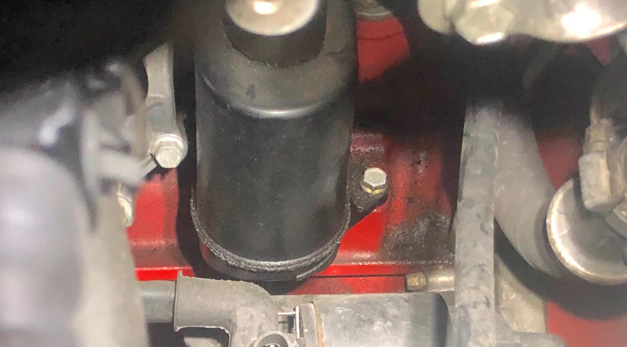

I can confirm it is possible to remove the oil trap from a manual B234f engine without the need to remove the intake manifold. It is not easy. First you must unscrew the bolt that holds the engine dipstick, located just below the distributor cap. This gives you almost enough space to wriggle the thing out. You must convince the oil trap out. It is far from straightforward. You will very much risk breaking the long pipe which is part of the bottom of the oil trap itself if your part is old and brittle and you'll have a very poor view of the seals, which if they are all dried up may fall directly into the oil pan.
Here's an image of my Volvo 940 birthing an oil trap...
I was lucky, you might not be. I could not recommend this method. Someone else in a volvo forum far away explained it as straightforward.
Good news / bad news: my oil trap was in fine shape - very clean. How annoying! I took the opportunity to reseat the wire loom that runs under the inlet manifold, which someone had previously reinstalled in the wrong order (under the heater core supply hose... it seems it should be OVER the hose). I also reconnected the ground braided cable back to the engine cover, which some idiot had left dangling around. I tightened up some other hoses related to the PCV system and generally fiddled around. The result is that when revving the engine I get a slight puff puff but also a bit of a vacuum (testing using a sheet of tissue over the open dipstick pipe. Not very scientific, but a 15% improvement I would say. Hah! I will continue to investigate other parts of the vacuum system. Return to that FCP Euro article.
