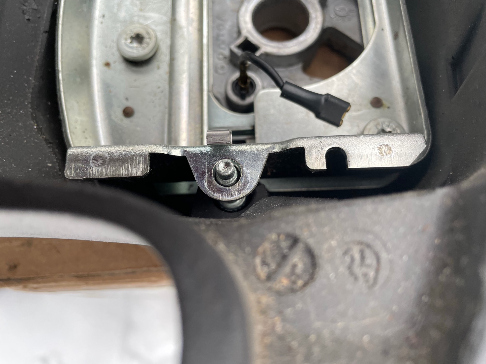

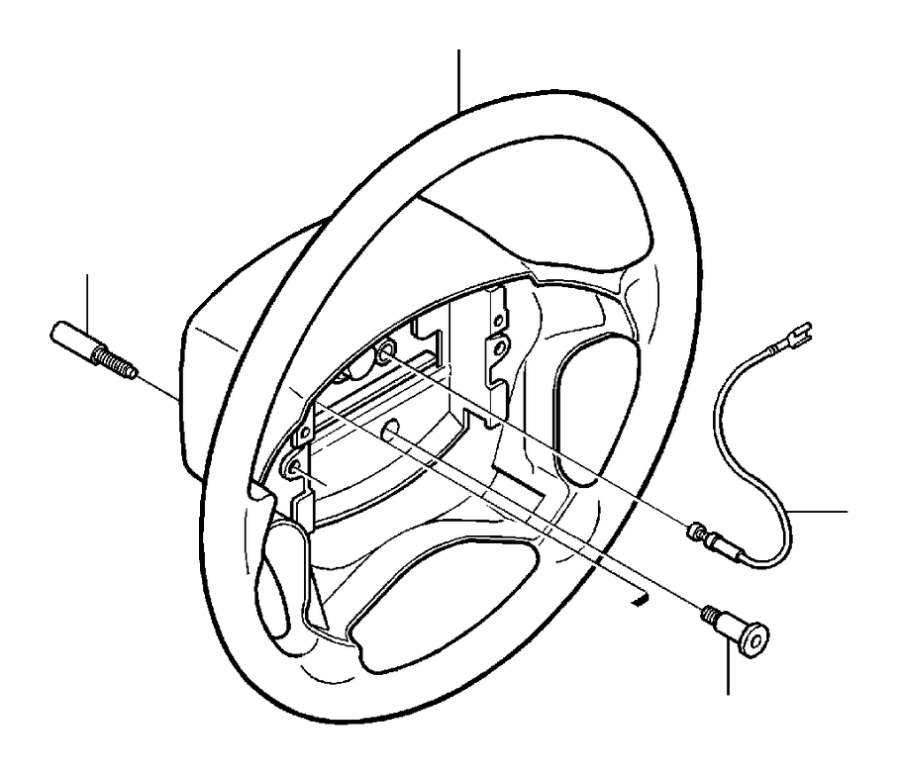

There may be light at the end of the tunnel and not a train at that.. I grabbing the airbag from the pick and pull I was able to to see the way its assembled and what type of bolt it is.
.the thick part is not a shaft its actually a pillar bolt reference picture above. I have access to the pillar part of it. I may be able to grab it and break it free and unscrew from the side..

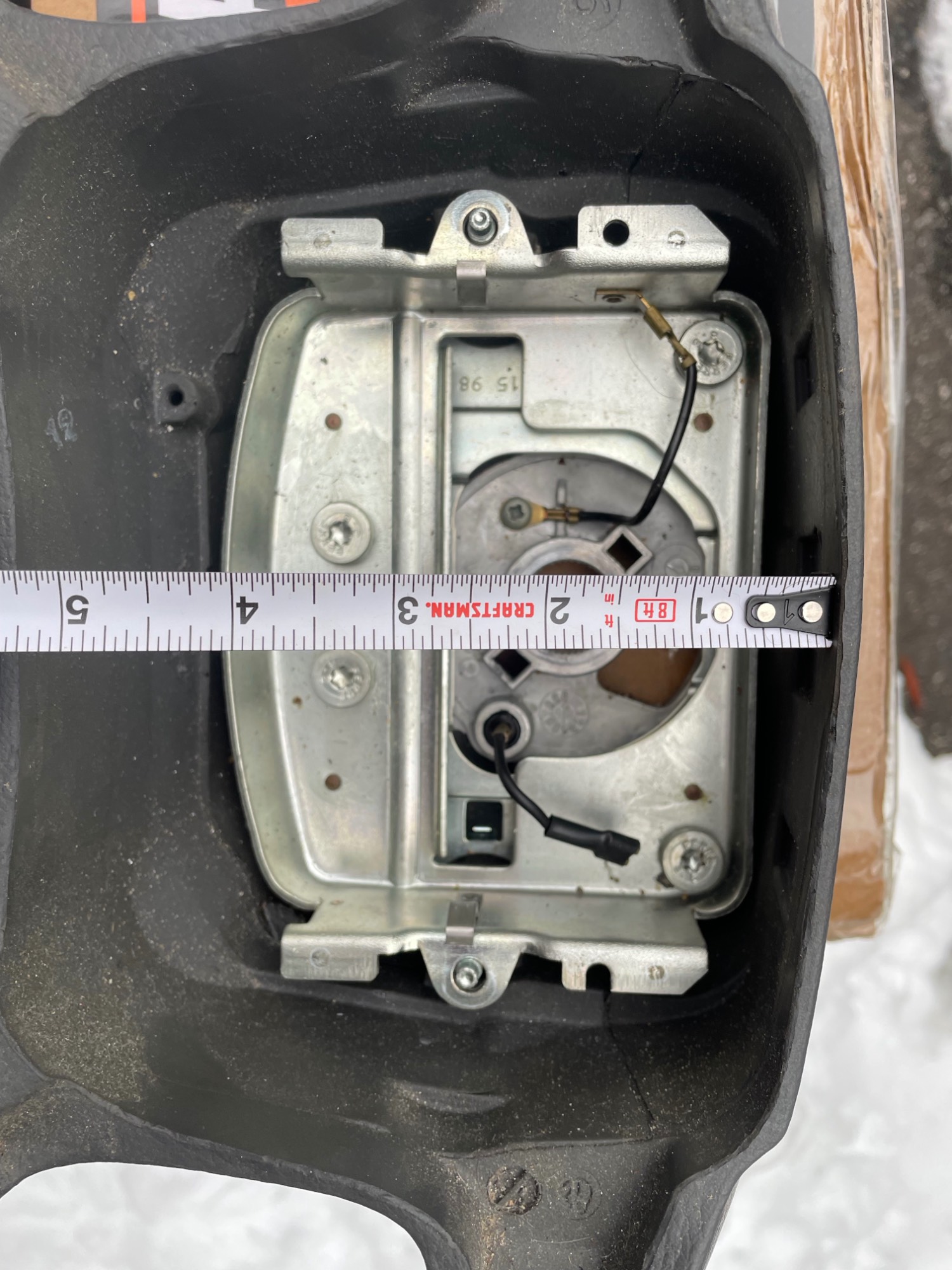

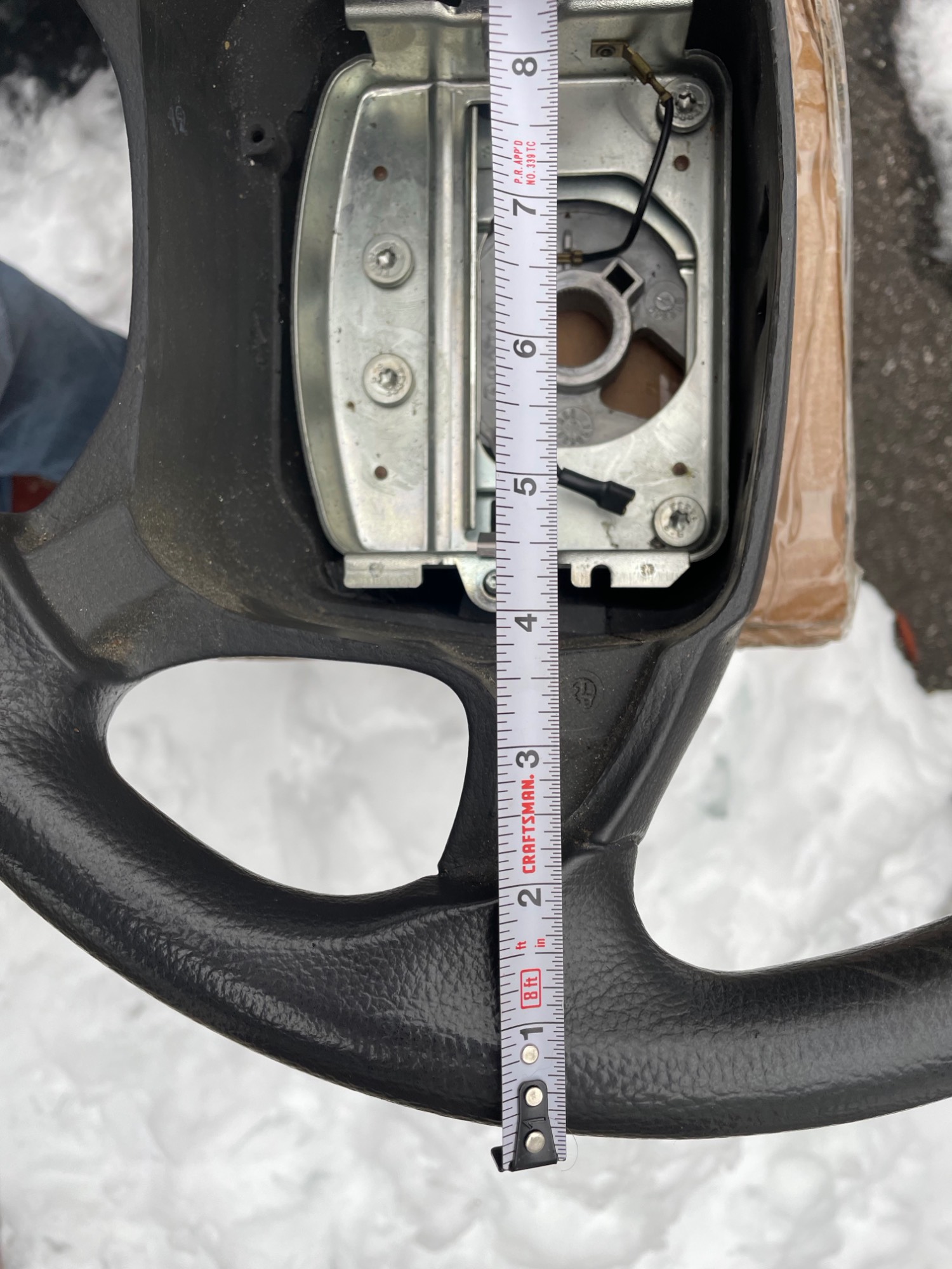

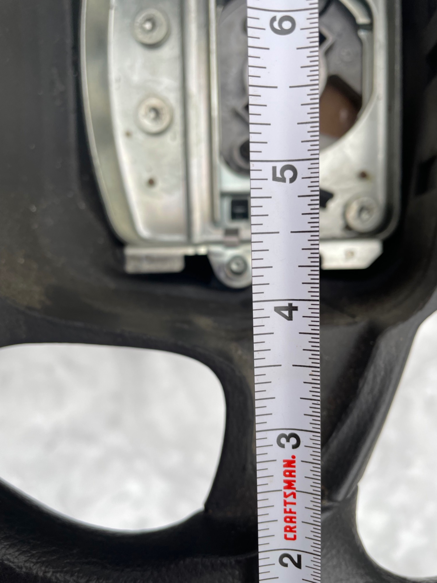

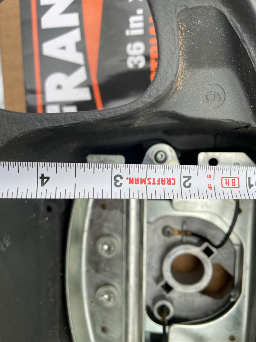

Hope these measurements might be useful….I have tipped the camera to correct for parallax to get the distances correct +- 1/16 inch or so.
Caveat - I think those Torx are captive in that metal plate, so you may have to cut them to the rear (REAR is rear of car) of the plate to release the airbag. Thats going to make a mess. I would circle hole cut through the airbag and grind off the screws from the rear of the steering wheel, I think - then use my replacement

SUCCESS!!!!
after ending up cutting away the side of the steering wheel cover to reveal the side of the bolt. I tried to grab it a few times with my Knipex and got semi-decent grip but it wasnt enough and there is very little clearance to turn. There is a metal brace right above the bolt shaft which gives you little to no room.
I had my hole saw out and was preparing for the nuclear option, but decided i would go one last attempt before the nuclear option suggested by abscate. I drilled a 3/16' hole in the side of the bolt shaft and put a 4 inch long round pin in the hole and pulled sideways, the first attempt bent the pin slightly, I turned the pin 180 degrees and tried again and viola it broke loose!! then i put an allen wrench in the end and worked it out..
post mortem - this steering wheel had been removed before. when it was reinstalled he used thread lock and torqued everything way way to much. luckily I was able to gently break the other bolt which still had a decent torx head on it. The bolt which gave me the problems was mangled clockwise, so when I went to turn the bolt out, there was nothing to grip. the allen wrench gripped slightly but would spin with light pressure so not enough to break the bolt free.
