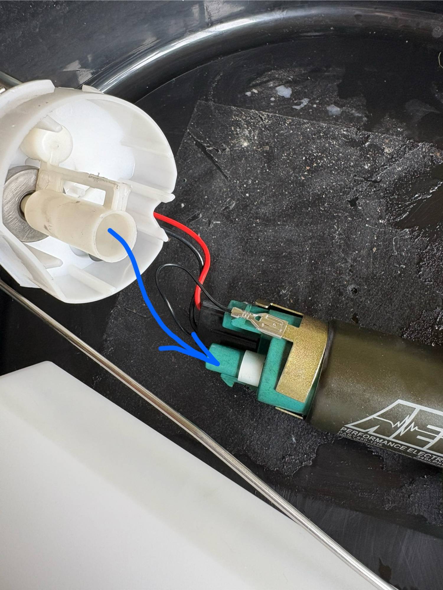

Hello all, I'm finally posting an update and providing closure on this issue. Upon further inspection, there was an access panel already cut in the floor for the fuel pump. The pump (which apparently been updated to a 340 LPH AEM unit) had slipped out of its tube, such that it was not pumping to the rail; fit it back together and the car fired right up! I still need to find a better way to secure it in place, but I'm very happy to have found the culprit.
Thank you all for your knowledge and time, it certainly helped keep me on the right track.

Hi, thanks for the quote, good to keep that in mind with this car in general. It's already happened again; this time I was ready with the tools on the side of the road. The car is FWD now with an M56, so fortunately the angle gear and supplemental components are gone. Haven't had luck finding an installation manual for that AEM unit yet. It looks like the rebuilt unit from Vast is using two o-rings.Vova585 wrote: 05 May 2025, 20:00 Great many thanks for update. My old friend was always saying " better is the worst enemy of good" . If this happened to you ones, chances are it will possibly happen again. I would look for instruction for AEM UNIt instalation. Maybe previous owner missed a part or a step. If all looks legit, identify area of weakness and try to correct it. If no way to correct it-save yourself nerves and go to local junk and get oem setup and install it there(chances are there would be an opening made already). This is not 2JZ-GTE Supra so expectations should be reasonable as well. This car still has awd ir it is only fwd? Angle gears and collar sleeves are not cheap or easy to come by, so I see no point in "performance " parts that can leave you on a road stranded. Glad you found the issue.

The car is definitely a sleeper right now. I would like to be able to daily drive it (or at least weekly!). Unfortunately the OEM fuel pump is NLA and I've read that the ProParts Sweden replacement is unreliable. The root of my issue seems to be the totally shot suspension in the rear, such that the car is frequently hitting its bump stops, thus shaking the pump loose. I'd be okay with replacing the AEM pump with an OE version (Bosch for FWD, Walbro for AWD) but based on the design of the housing I'd be worried about it shaking loose again. I'm going to try to fit a small tube with clamps between the outlet of the pump and inlet of the housing as a modification.
