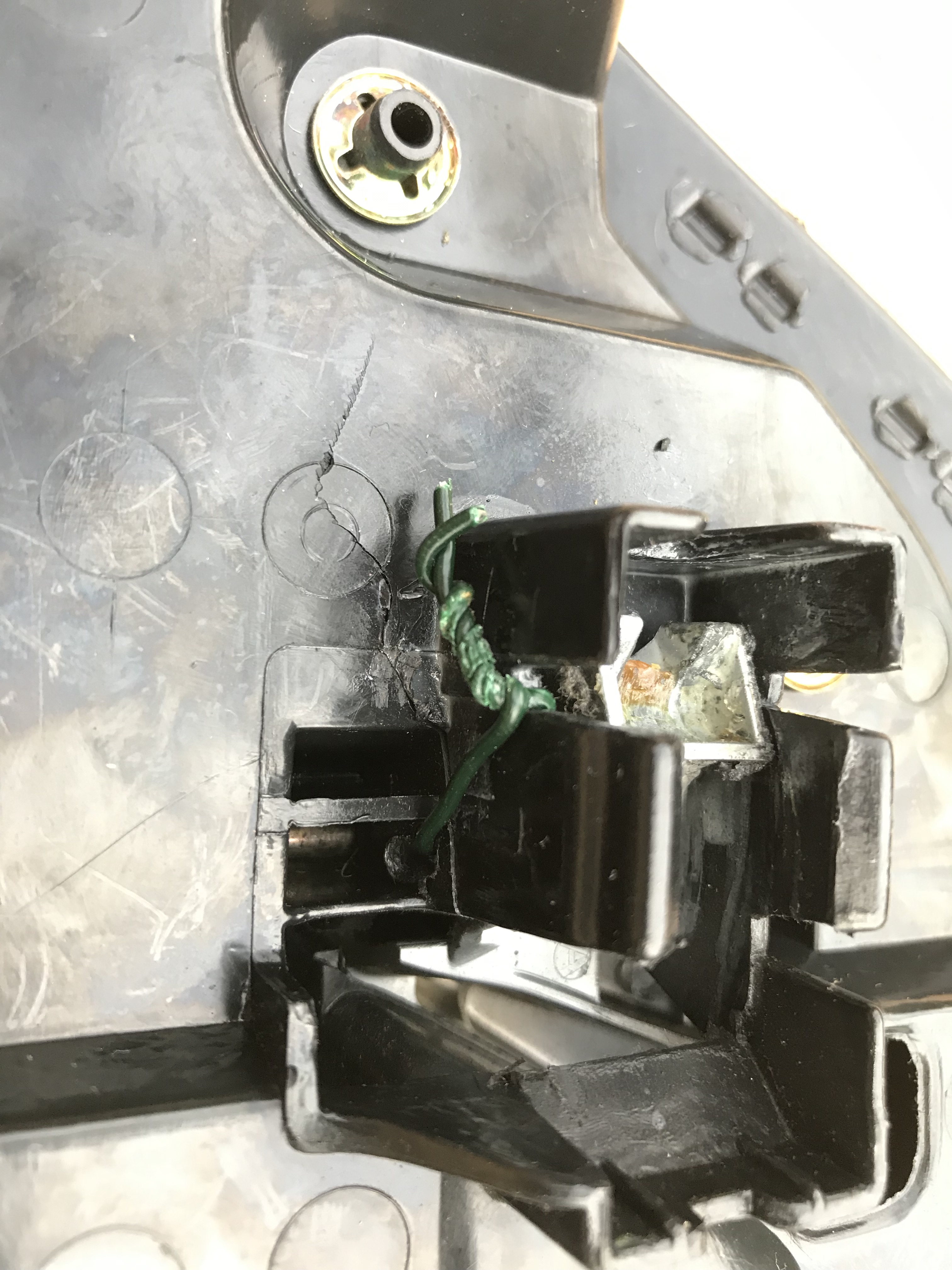

Not sure if the S60 setup is the same like my 2005 XC90, but the fix in the XC90 is drilling the holes + single zip tie:
viewtopic.php?t=72385

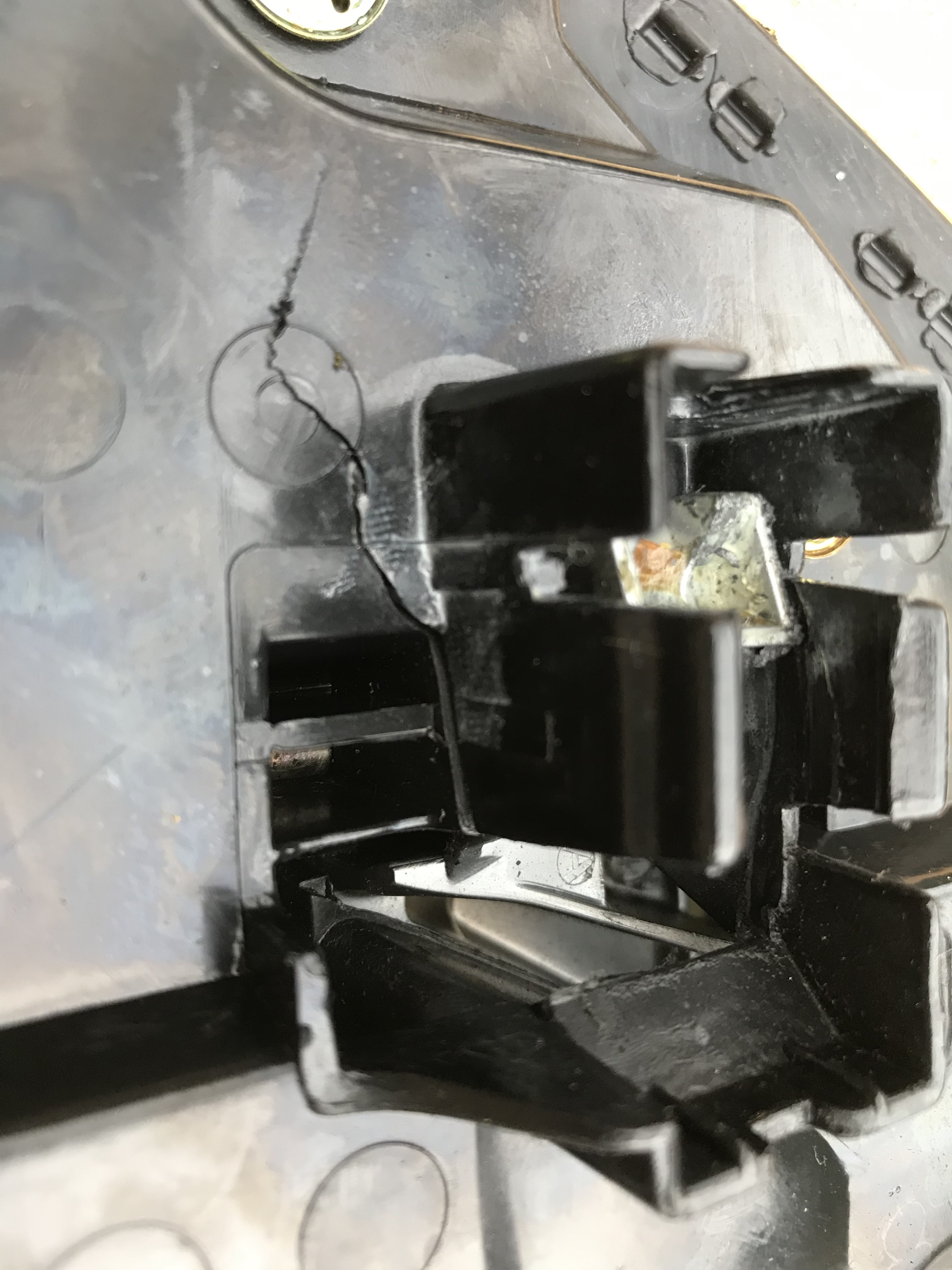

Drilling the stop crack hole is important in plastic! Find the end of the crack and relief the stress by drilling it outcn90 wrote: ↑18 Oct 2018, 08:35 Not sure if the S60 setup is the same like my 2005 XC90, but the fix in the XC90 is drilling the holes + single zip tie:
A bread clip would fit perfectly as agussett plate to bridge the repair with SuperGlue (Tm?). Bread clips have been obsoletedfrom ACrepairs by zip ties of course.
