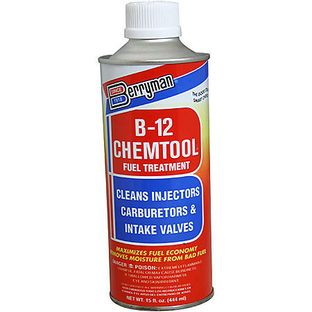

I am putting in a junkyard engine. Pulled to oil pan and there is a lot of sludge in there.
What is the best way to clean sludge from the bottom end of the engine? The engine is on a hoist. I am assuming I should also pull and clean the oil pump pickup itself, the part with the pickup screen that stays in the block when you remove the oil pan.

you can use
B-12 chemtool liquid or carb spray - I like B-12
You can use diesel or gasoline but it as not as safe.
- 7040112_bry_0116_pri_larg.jpg (33.14 KiB) Viewed 5149 times

I used SB-12 with good results, as well as Simple green. Simple Green works very well, but just make sure to not leave anything soaking in it, as it can start to corrode the aluminum.

Thanks for the quick responses. I think I might go with the B-12 for the lower engine block then, so I don't need to hassle about cleaning out every drop of the Simple Green. The block is not so easy as the oil pan, the pan I can do in a separate tub.
