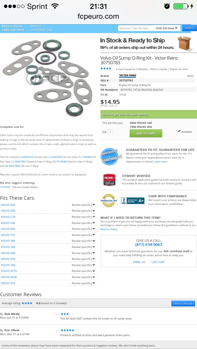

My Volvo 850 turbo has the ticking from the top of the motor. Was told top end is being starved of oil from worn/damaged o-rings from inside the oil pan. Ok purchased the o-ring kit for &14.95 from fcpeuro.com. I've looked at multiple DIY to remove the oil pan ok. Now when i do remove the oil pan, which o-rings/gasket am I replacjng ? Please mention part# from image provided, thanks again
- Oil sump o-ring kit from fcpeuro.com
- image.jpg (194.49 KiB) Viewed 1209 times
- Which O-Rings am i replacing ?
- image.jpg (81.79 KiB) Viewed 1209 times

The kits have more stuff than you need. The ones you will be changing in the sump are 7, 15, 20, and 29. You will also need the anaerobic sealer.
While you are there, clean out the square port from the PCV real well.
