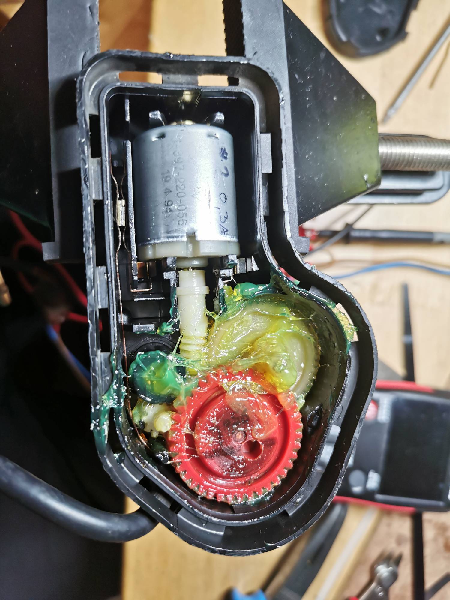

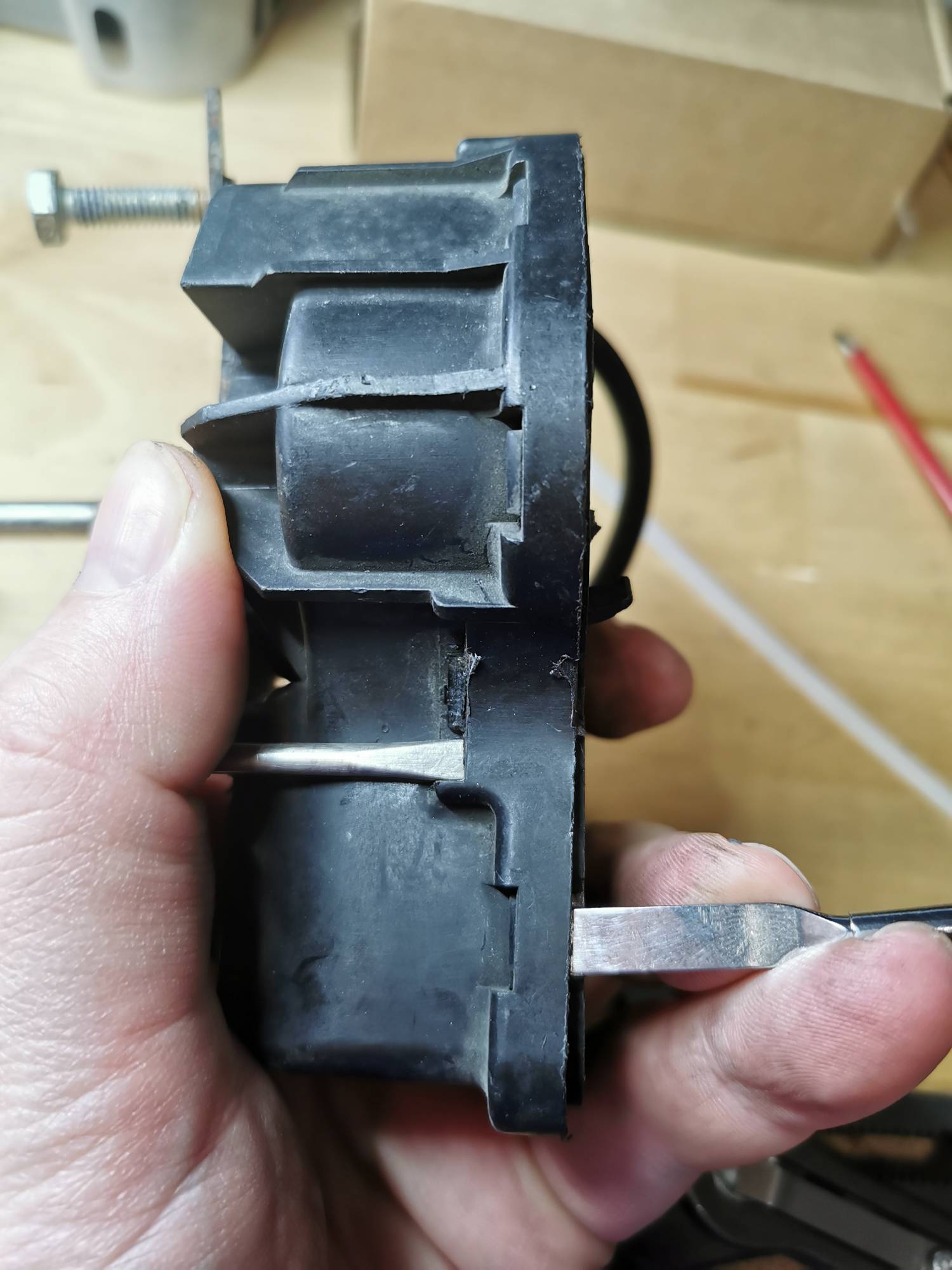

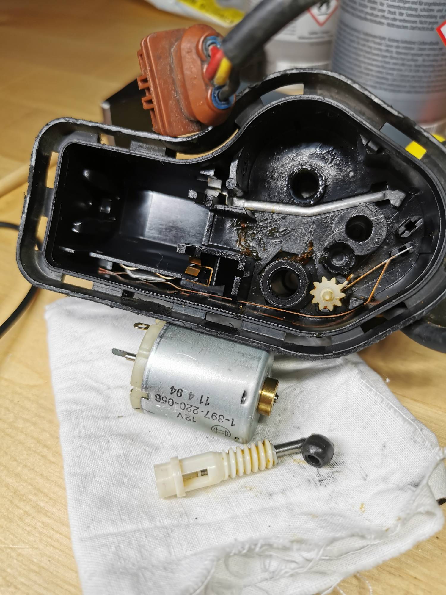

btw, I am done with rebuilding them, but did not have any time to reinstall and try them for real. I don't think you need to replace the motors, they seem way overbuilt, but the brushes and rotors need to be sanded down a bit for them to work correctly again, at least on mine.
I wanted to wait until I had them installed and tested to post anything, but I'll just put up what I did so far, if it helps someone:

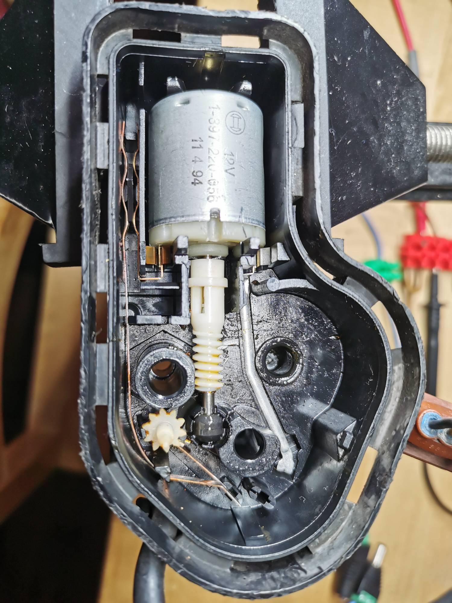

Note: it would be best to mark or note in which position the gears are assembled, I didn't do that and will likely have to do a lot of trial and error to get it right again. There is a switch that opens the circuit and the position depends on the gears...

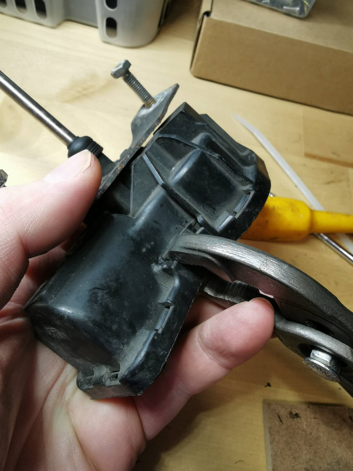

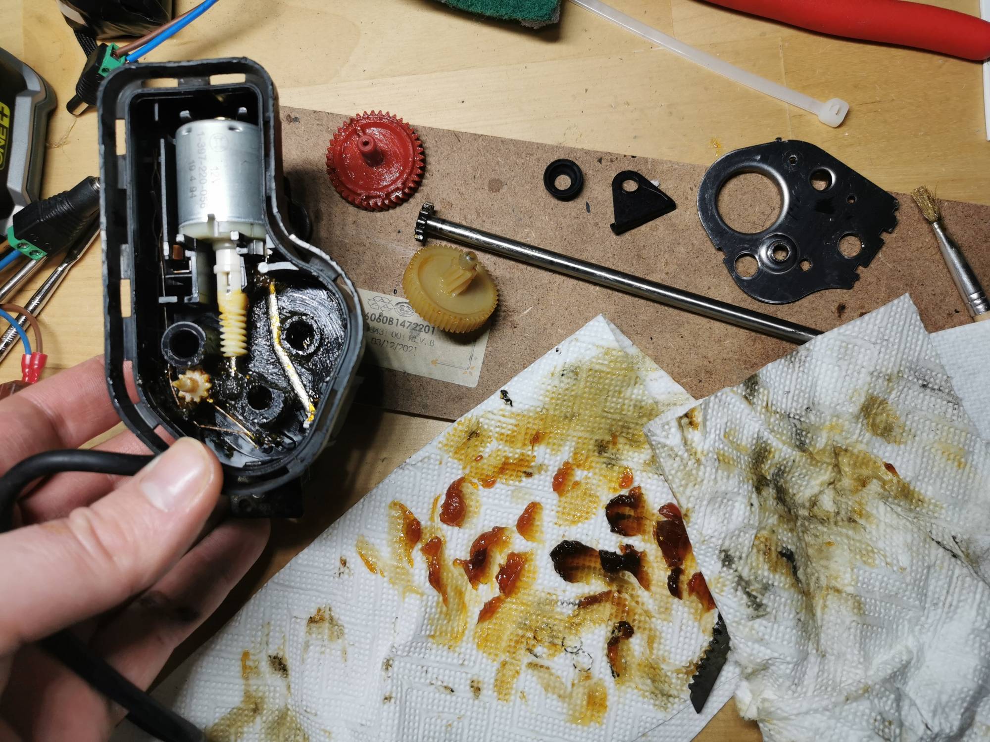

- plastic casing:
I found it easiest to start with moving the small latches, then opening the big latches as much as possible, additionally prying them open and open the small ones. Start on the rectangular side.
On the first one I cut the small nubs unter the big latches which made it easier, but might not be good for holding together later on...
Rest of the disassembly is easy, get out the shaft and everything comes apart easy.
It is pretty greasy in there
I regreased it since it smelled pretty burned, but I think it could be left as is.

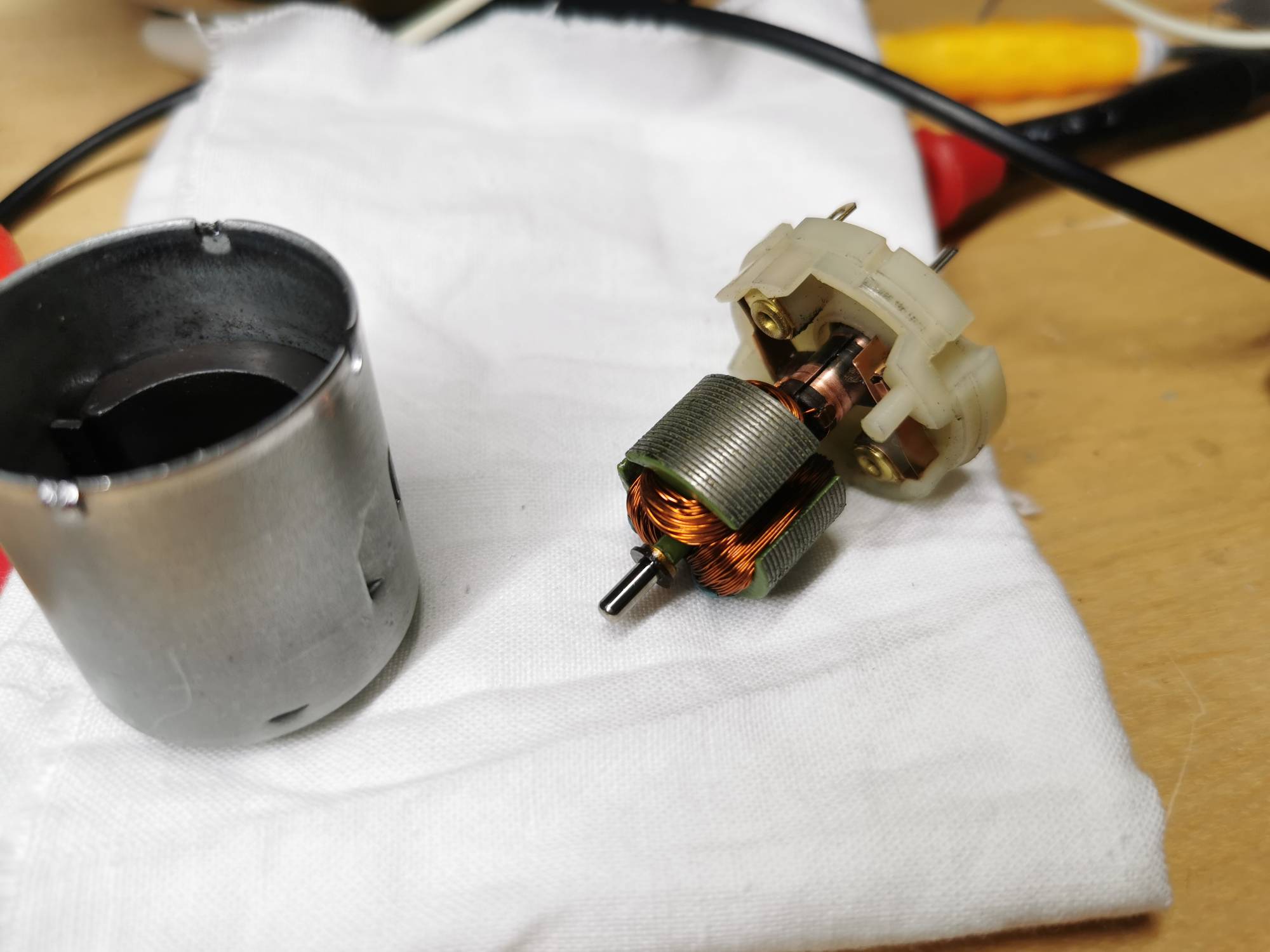

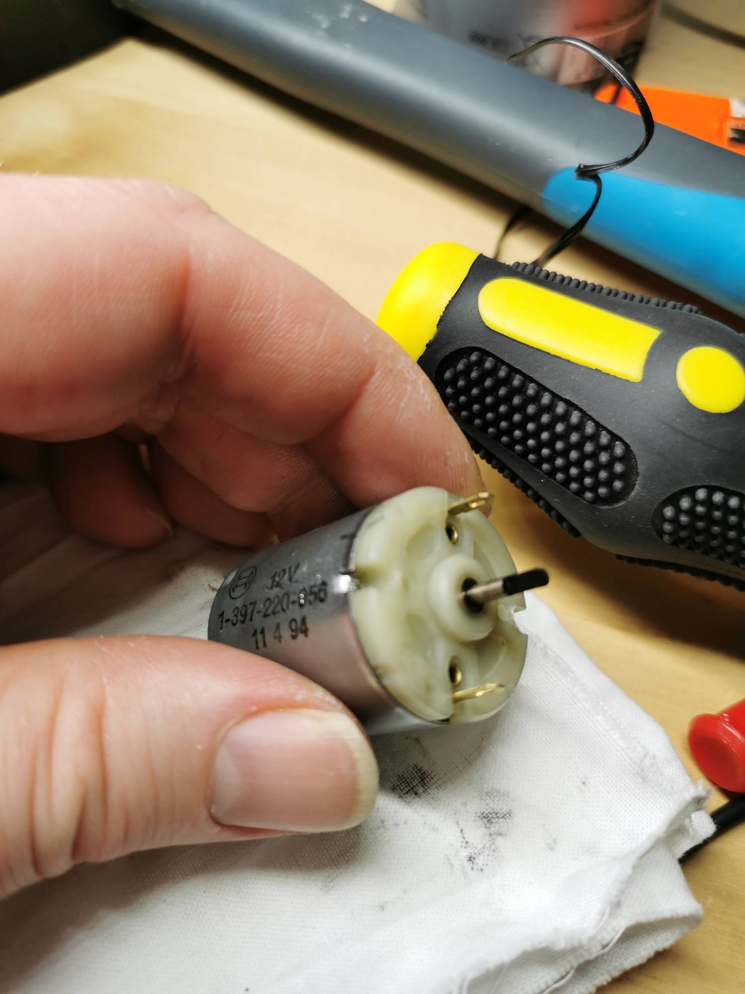

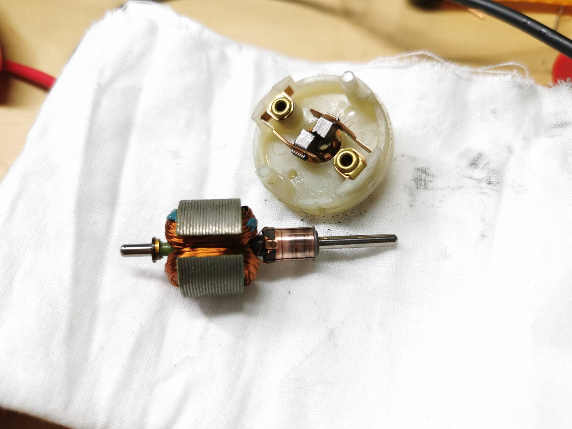

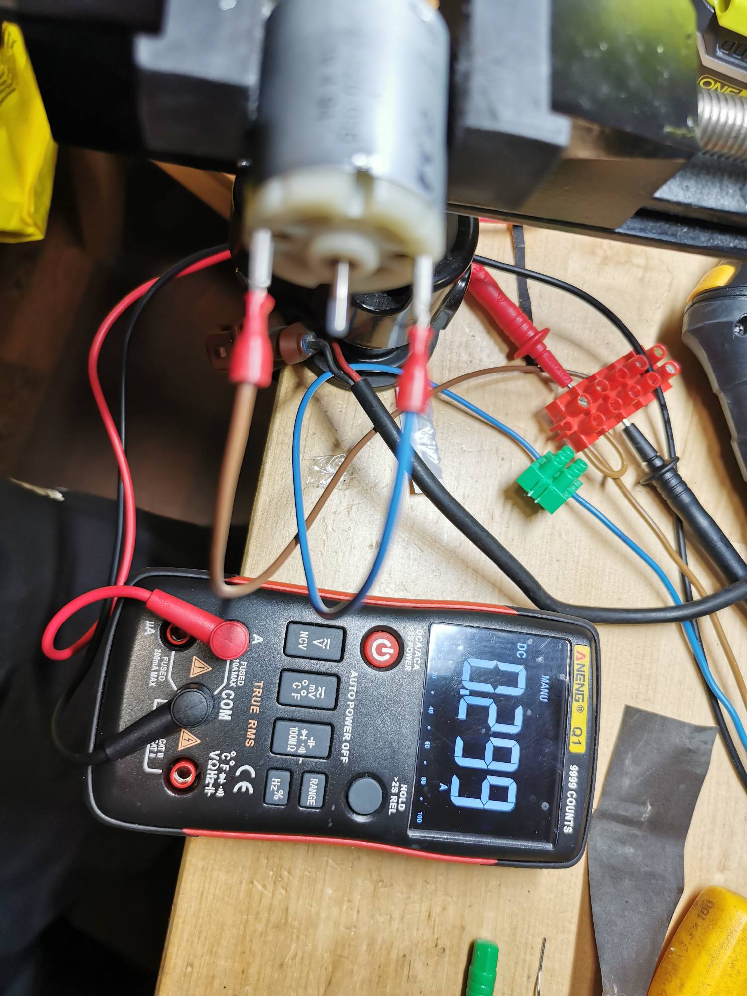

- rebuilding motor
To test I removed the cogs, put the motor on 12v and measured amps. First one was bad (>7A) and the second one seemed better, they seem to use ~0.3A when running without load.

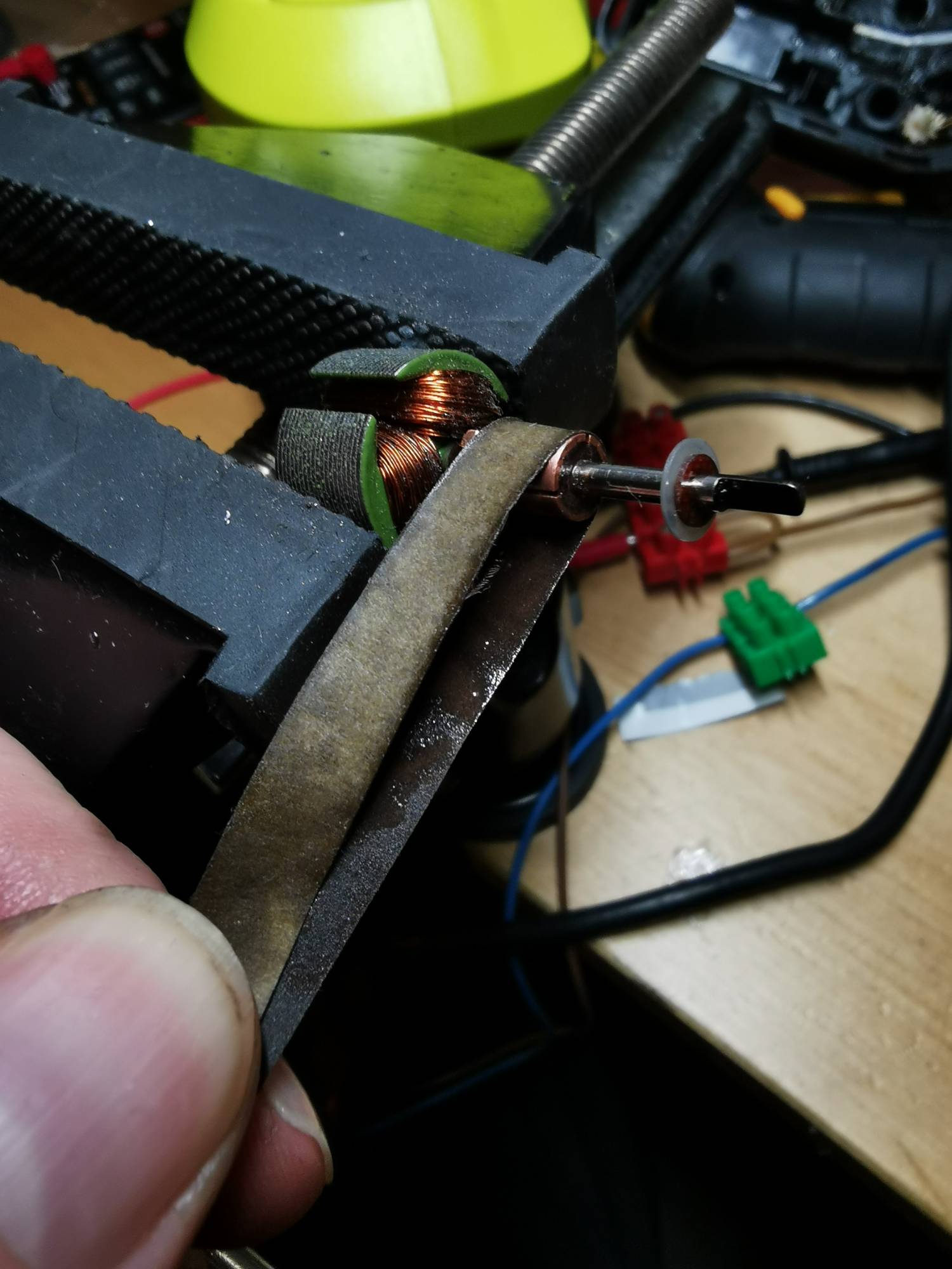

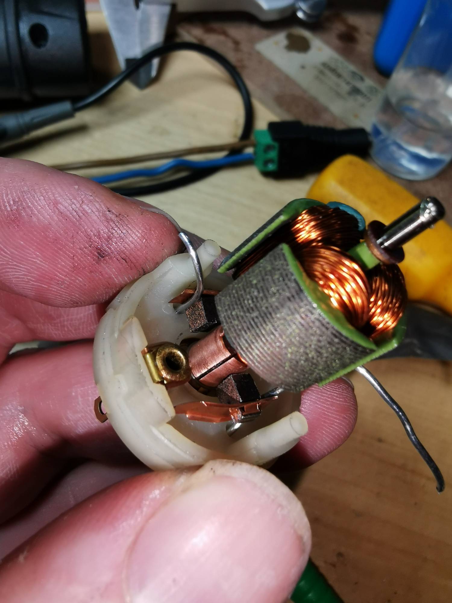

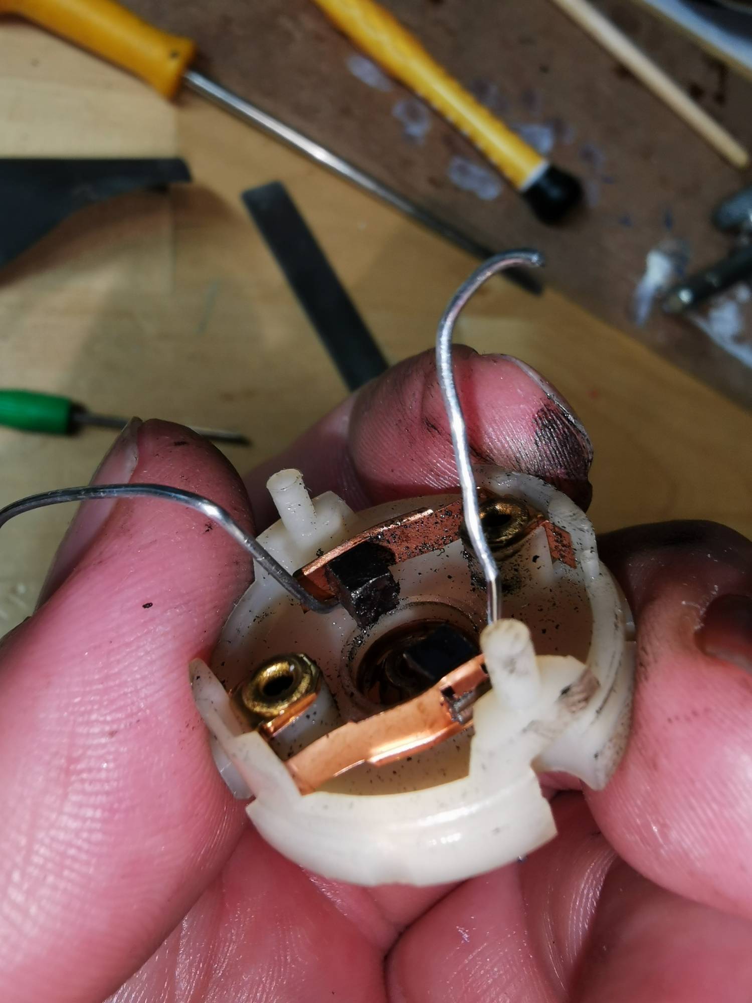

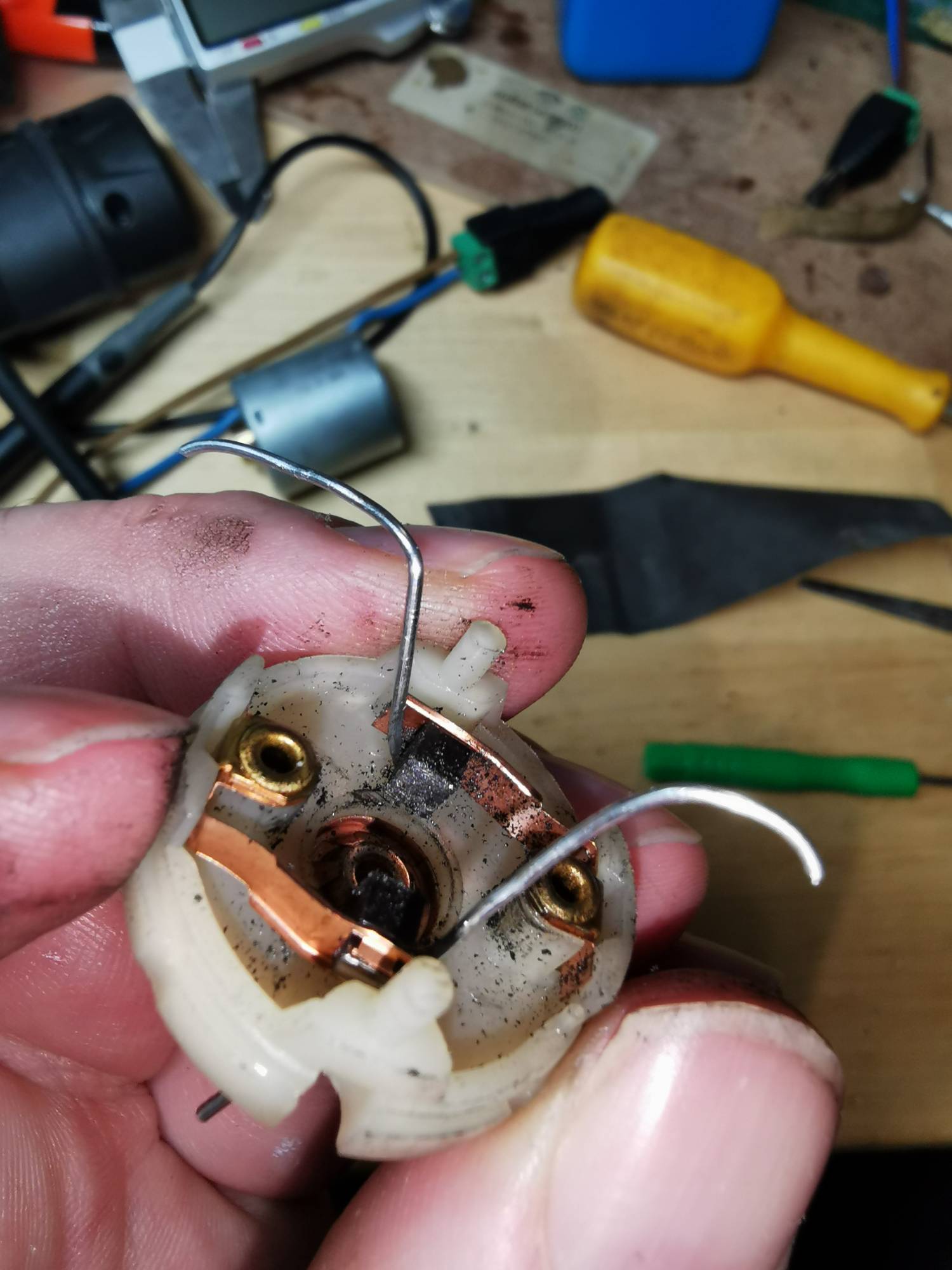

To rebuild, remove the clipped in motor, bend up the 2 latches (don't damage them) and then clean/sand the contacts and I also filed the brushes a bit as they only had a very small contact area. Clean reassemble & test, you can see here good contact of the brushes. Bend back the contacts and re-insert motor, regrease & assemble.
I tested them partly assembled with zip-ties holding the internals in to see if it will work with the PTCs and driving the gears.

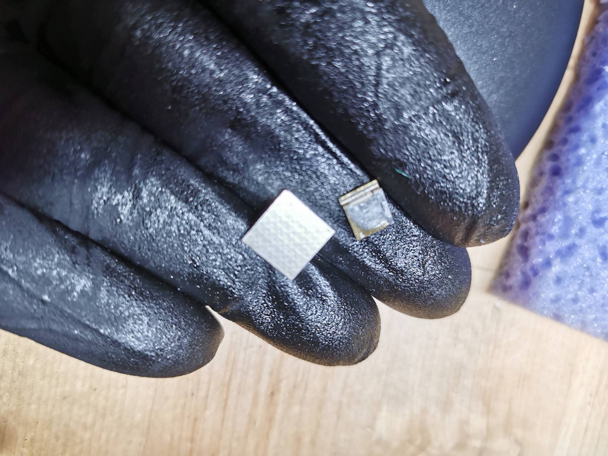

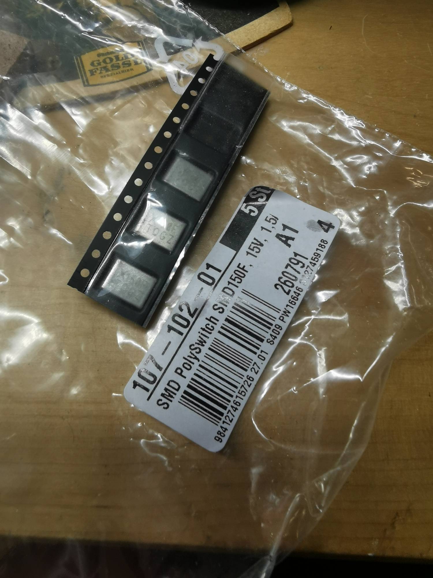

- PTC
Regarding PTC
One of them seemed to be fine, but it would stop after extended running, even with the rebuilt motor. So it most likely does not work correctly any more.
I first wanted to use small 1cm aluminium squares to replace them, but I found something that works as a replacement:
SMD150F small SMD fuses (1.5A)... I cut off the bent section and then you can use them between the contacts. Can be tricky to get in.
- plastic casing:
- rebuilding motor

- PTC
Regarding PTC
