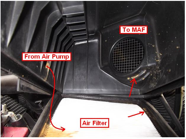

So I followed the advice of re-routing the Crank Sensor wiring. The wiring was approx. 1cm from a spark plug wire, no biggy. But since people advise me to re-route it, I change the wiring route, so the CPS wiring is away from the spark plug wires.
In the process of removing the Top of Air Filter Cover, I discovered something interesting...
- I already did the "SAS Delete" using the 99-cent Radio Shack diode last Dec 2012.
- When I opened the Air Filter area, I saw traces of rusty water on top of the air filter, with some flowing across to the other side. I don't think it was much water because the discoloration on the air filter was not that bad.
- This rusty water certainly came from the Air Pump, which I have ignored since I bought the car in Dec. 2012.
- So I did the usual thing, I drilled a hole at the bottom of the Air Pump, and sure enough a gush of rusty water came out!!!
See the photos for your eyes only...
