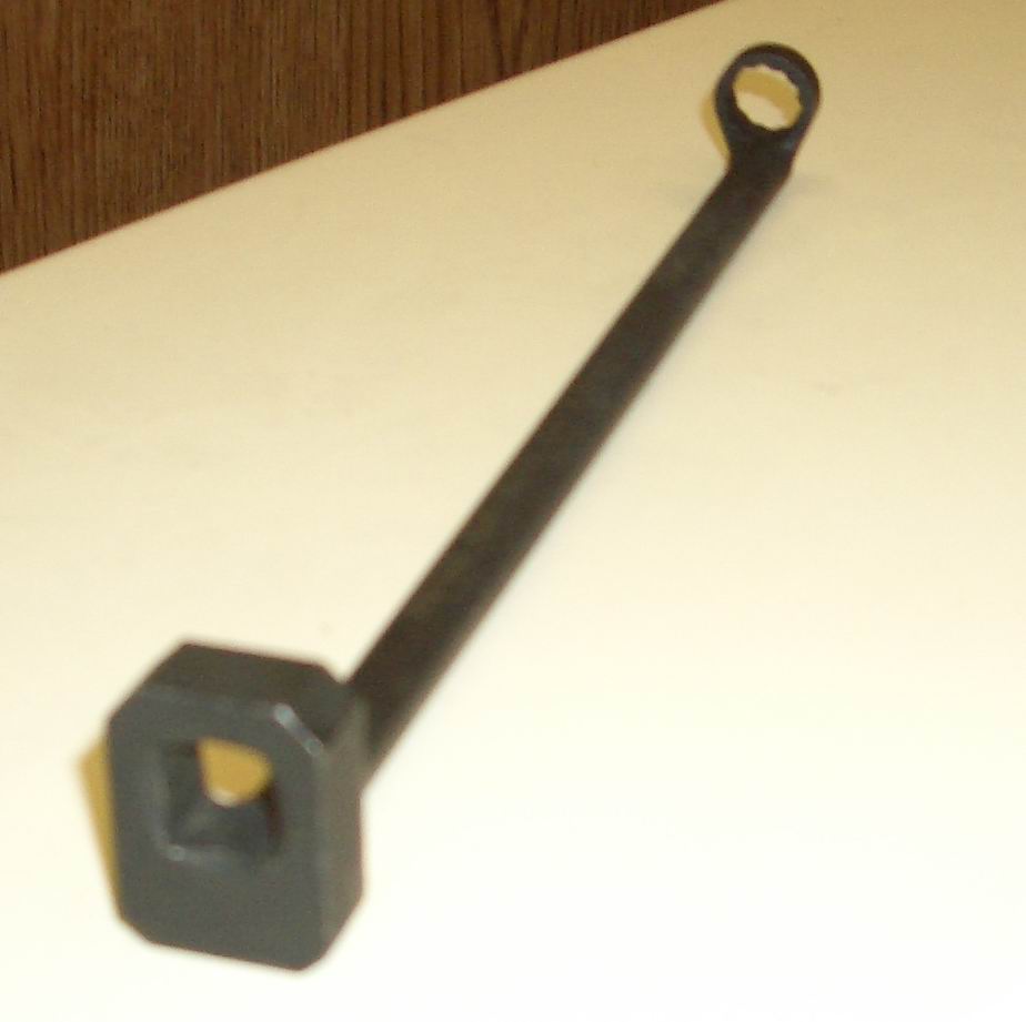

Here is a photo of the special wrench. Essentially 3/8" drive at one end and 10mm 12 point hex at the other both offset from the CL of the 'rod' portion. Sorry that it isn't in better focus. It is either my cheap camera or the camera operator.... :)
The overall length of the 'wrench' is 8 inches.
Part number written on the rod portion is 9997029 KENT-MOORE USA 2 6.
Maybe it can be purchased from 'KENT-MOORE'.

dcarlson12 wrote:Here is a photo of the special wrench. Essentially 3/8" drive at one end and 10mm 12 point hex at the other both offset from the CL of the 'rod' portion. Sorry that it isn't in better focus. It is either my cheap camera or the camera operator.... :)
Amazing tool and it was left in your vehicle? I am going to make sure I do not just do a great job but an exceptionally excellent job in everything I do from now on just in case I forget and leave my wallet some place I've had worked at or done business with :wink: .
