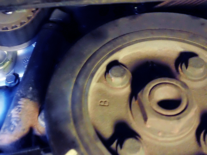

jblackburn wrote:Both of the upper gears are camshafts. The crankshaft is at the very bottom of the engine, where the serpentine belt is also attached.
Is this crank? I read in one of the post, rotating crank with 30mm socket would rotate cams and align each notch to its corresponding right angle marker on the cover as Robert shows above. It wasn't clear with the belt ON or OFF. Common sense says ON.
crank with 30mm bolt

Yes that's the crank. Yes with the belt on. You never want to turn it or the cams with the belt off.
That is the front of a 960 which is basically the same, just 1 extra piston and loaded from the front of the car.
