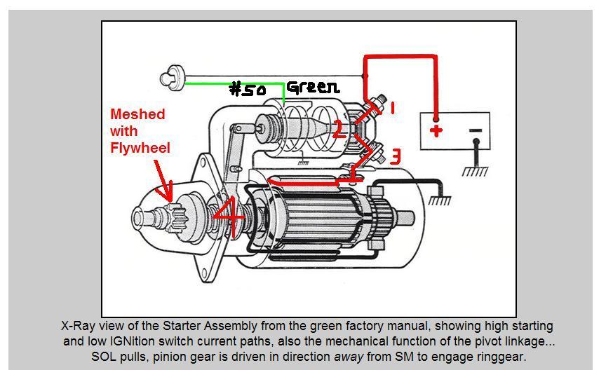

Take a minute to study the Bosch Starter, this design has been around for some 50 years or so.
When the Green wire (#50) is energized by the key in Position III (starting), power is fed to Green wire ---> Starter Solenoid Plunger is moved forward, which will do 2 things:
1. Supplying current to Motor itself: now current flows from 1 ---> 2 ---> 3, spinning the Motor Shaft.
2. The Clutch (#4) is engaged so the Starter Motor SHAFT is locked into the pinion.
The pinion normally freewheels when the engine runs, but when the Starter Motor is energized the Starter Motor SHAFT is locked into the pinion allowing you to crank the engine. As soon as you release your key from Position III, power to #50 is cut off, the Clutch disengages. Now the pinion free-wheels again.

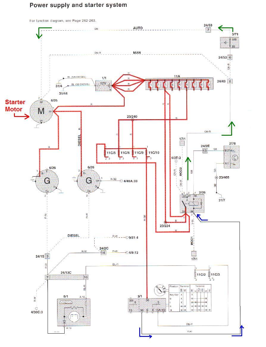

Back to the wiring diagram supplied by "BEJinFBK":
1- When you turn key to "Position III" (Start), power flows from #50 in ignition switch ---> starter relay (labeled "2/35").
See BLUE Arrows.
2- Now starter relay is switched on, power goes from #30 ---> #87 on relay ---> #50 on Starter Motor.
By supplying power to #50, the Starter Motor now runs.
See GREEN Arrows.
See BLUE Arrows.
See GREEN Arrows.
